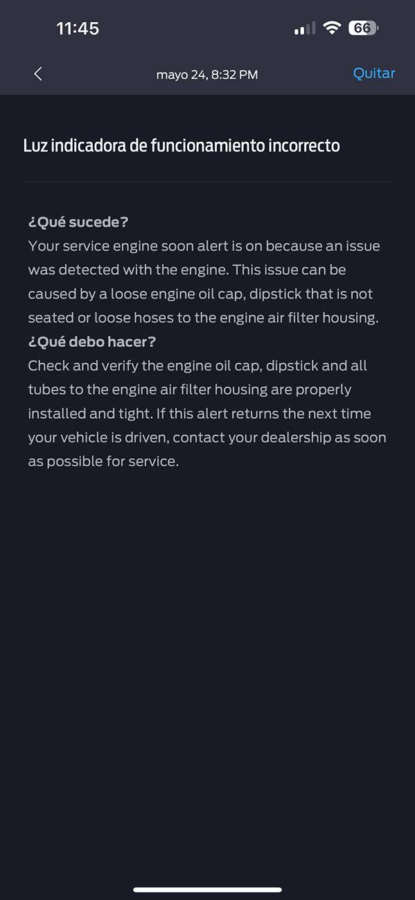

Problem with my S650. Two days ago I installed the K&N intake, and after hard acceleration, I got a check engine light. I've already checked the connectors and looked for air leaks, but everything seems fine. Any ideas?

In order to get the filter into place, you have to remove the temperature sensor and one hose. I assume you reconnected those?

Be sure that all the hoses are connected and the sensor is installed in the proper direction... not much else to it, unless you inadvertently disconnected something else.

Yes, everything is in its place

I have been running it with no issues for a couple months now (as I think a few other have)... not sure what else it could be, but you may be the second person to get a CEL. with it. Perhaps time to contact K&N. Maybe check all of the rest of the intake piping as well. Any other modifications to your car? What fuel are you running?

As for your CEL, I suspect either the MAF sensor got oil on it, or you inadvertently changed the inside diameter of the intake tubes by removing the sleeves. Im not sure if these have sleeves in them like the s550 versions did, so someone can correctme on that. If so, removing those sleeves requires at tune and will give you a CEL.

Once again I’ll share my story but the same thing happened to me with all of the hoses connected tight and per spec. For whatever reason it sets off the check engine light and I contacted K & N and they gave me my money back without even asking me to return the intake so that tells you all you need to know. I have noticed the temps in the engine bay are hotter than ever. The only thing I like about it is the look and that’s it. If you want the check engine light off take the crap out and reinstall the stock air filter.

I had a CEL after installing a K&N intake on my car.
the plastic piece where the PCV attaches to the intake tube is too tight. I backed it out, wrapped it in 3 layers of PTFE tape and re-installed it hand tight. Haven’t had an issue with it since.
