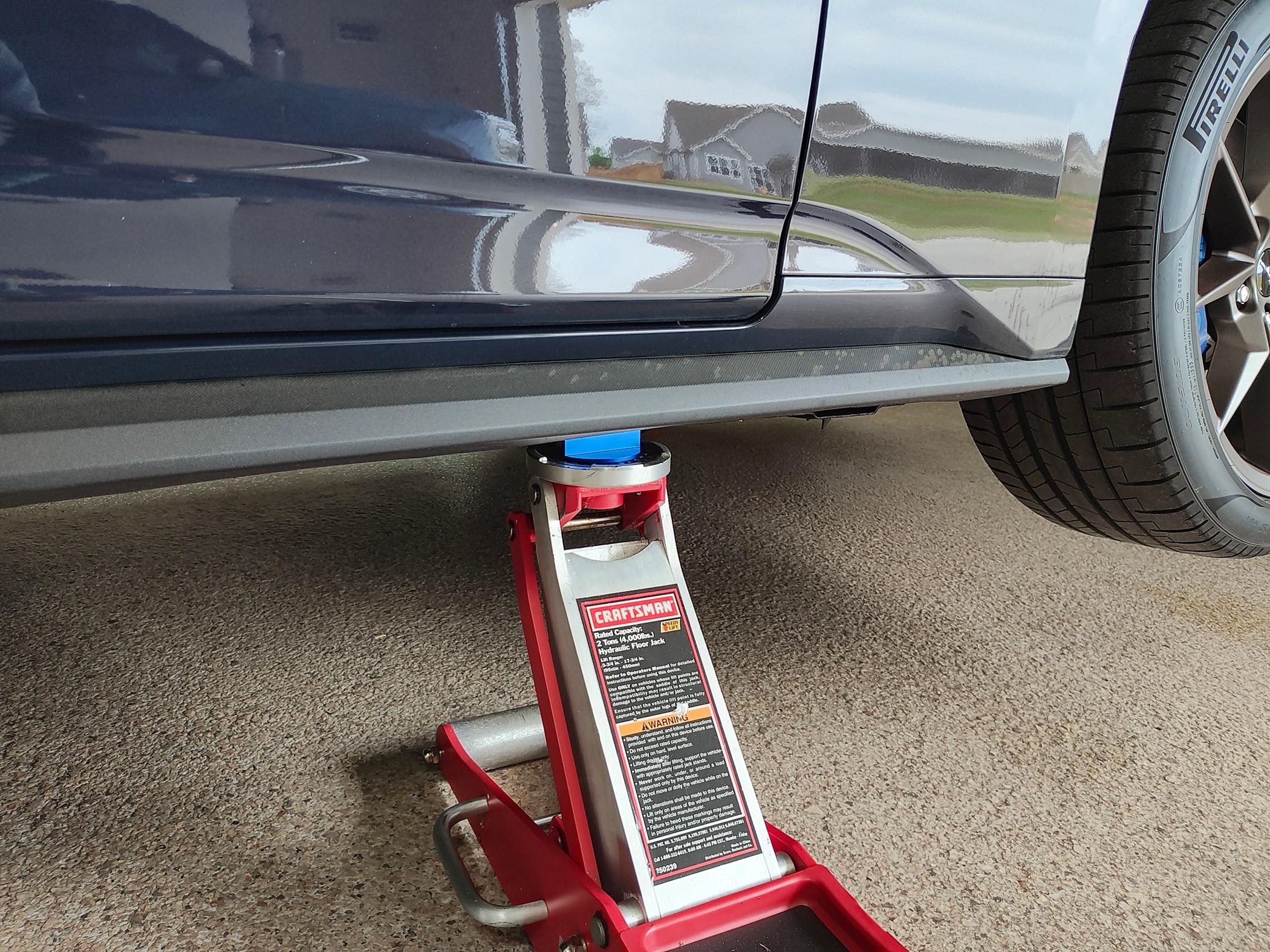

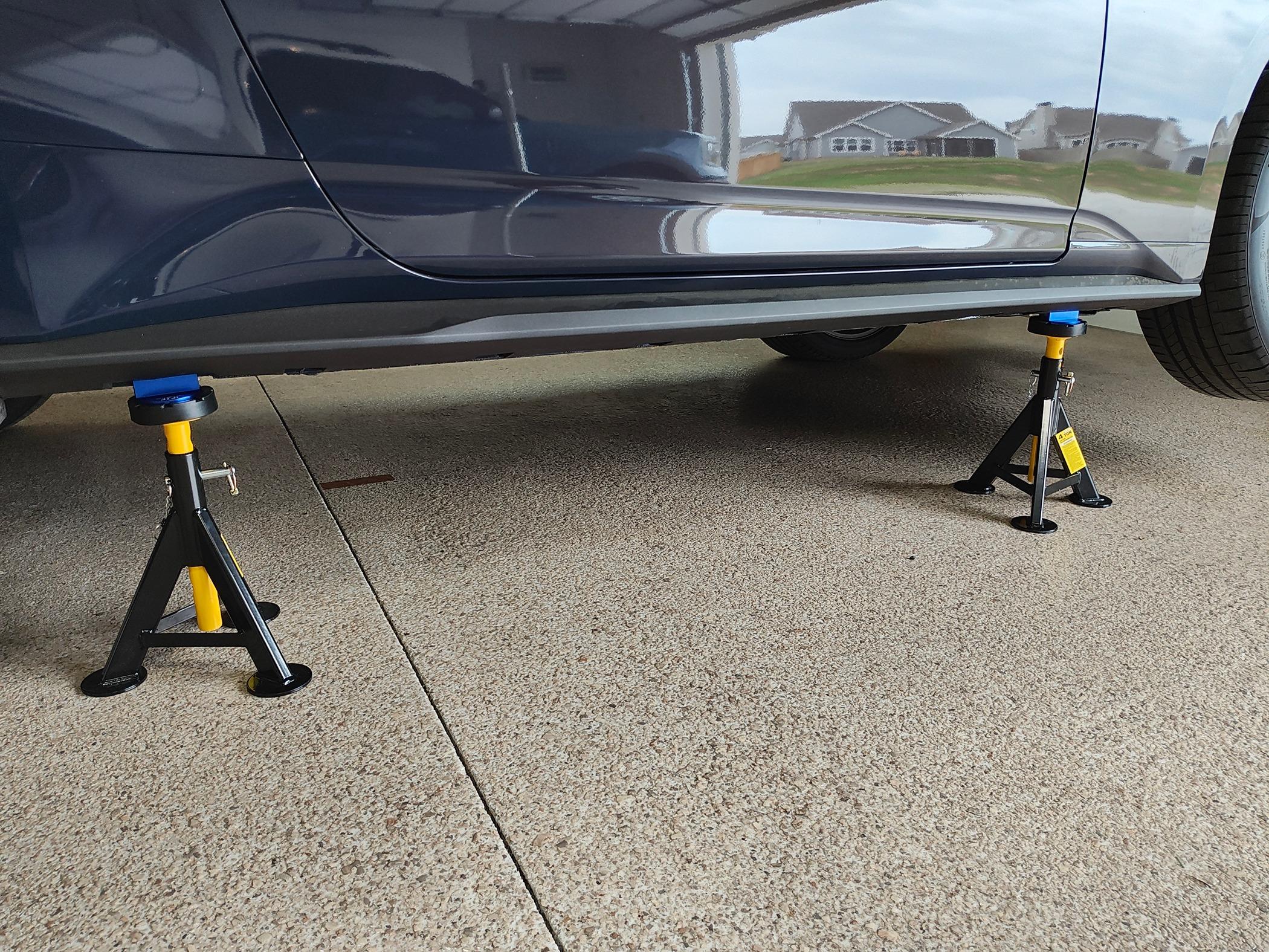

That's half of the solution. Where are you placing your jack stands?
I place the jack stands on the pinch weld using one of the aluminum jack pads. There is enough room to jack the car just back from where you need to place the stand. You can jack side to side and only put stands in the front or back or all four corners which is what I normally do that makes it easer to go under the car.

S650 Mustang Jacking -- safe way and where to jack up front end of 2024 Mustang GT? IMG_20240410_165231228_HDR
S650 Mustang Jacking -- safe way and where to jack up front end of 2024 Mustang GT? IMG_20240410_165442218_HDR
S650 Mustang Jacking -- safe way and where to jack up front end of 2024 Mustang GT? IMG_20240410_165404274_HDR
4,619
2,499

use front pinch lifting spot to raise far enough to place stand under rear pinch lifting spot? but then where to raise to place stand where jack is lifting?
The second photo I posted shows the Jack in place and both stands the way I jack it. If you put the jack around the front edge of the door there is still room to place the stand in front of it.
