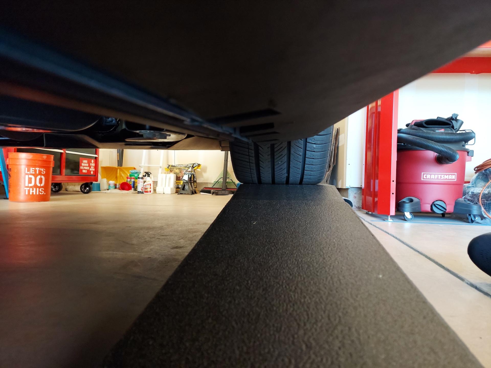

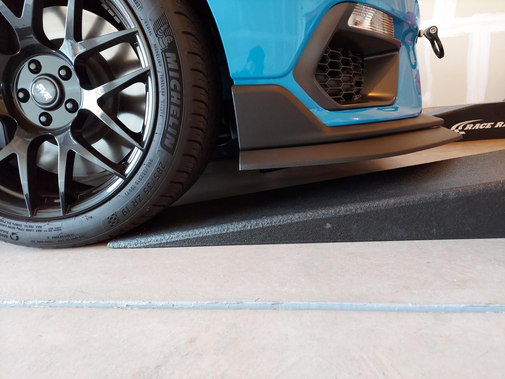

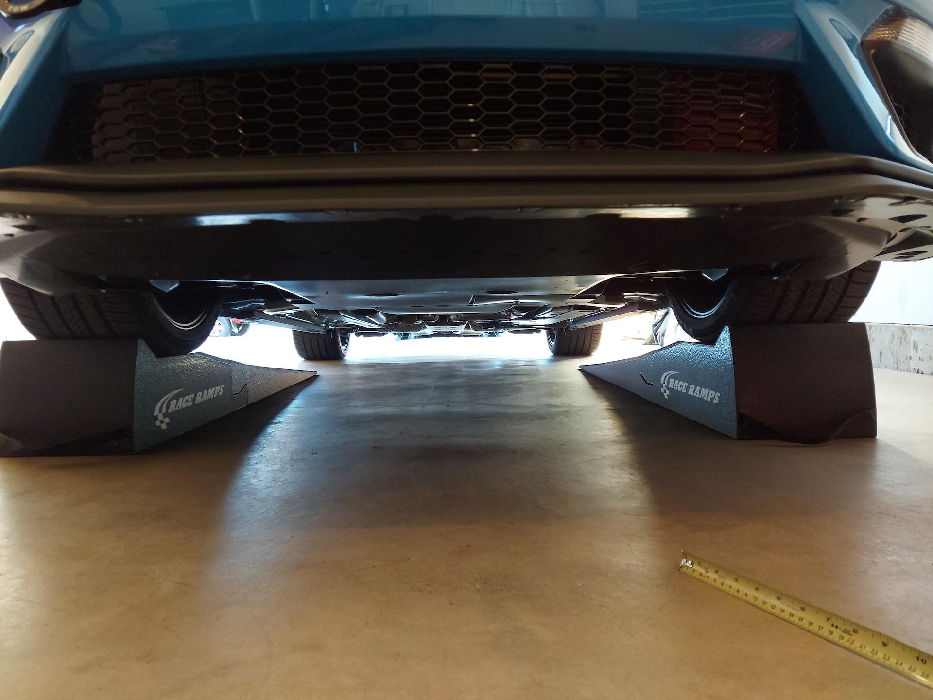

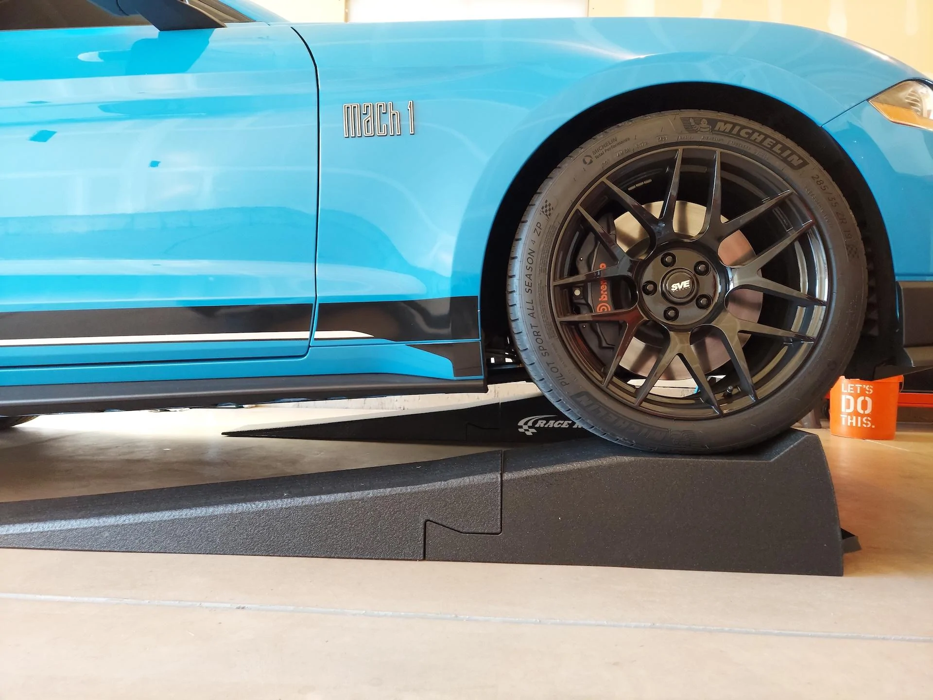

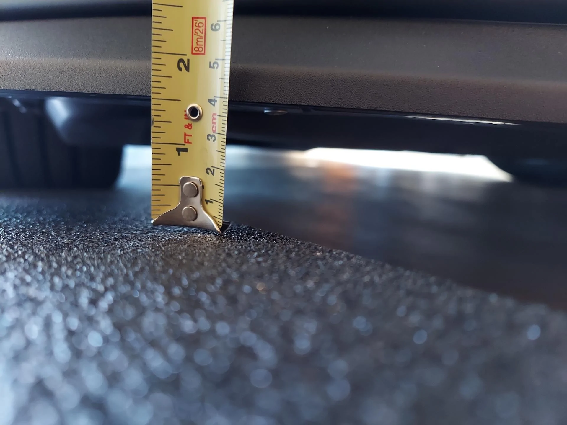

https://www.raceramps.com/ramps/race/p/rr-72-2/

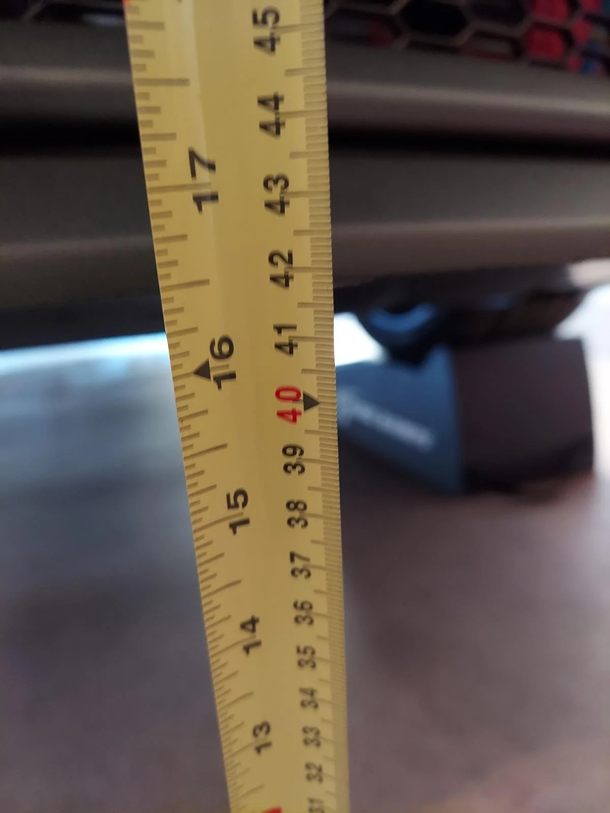

I'm using these. The Ford Supplement for the M1 w/HP mentions staying away from grades with an initial entry of 7%. The ones above are just below that. They work well. They do not shift when going up and down and the materials are very robust. An additional nicety is they separate, are light and can be thrown in the trunk.
So, that works for me. Depending on your ride height, front splitter and all that, there might be something better still for you. I'm sure the company can provide guidance if you have any model-specific questions.
In the reference pictures, that's a 19x10 rim with a 285.

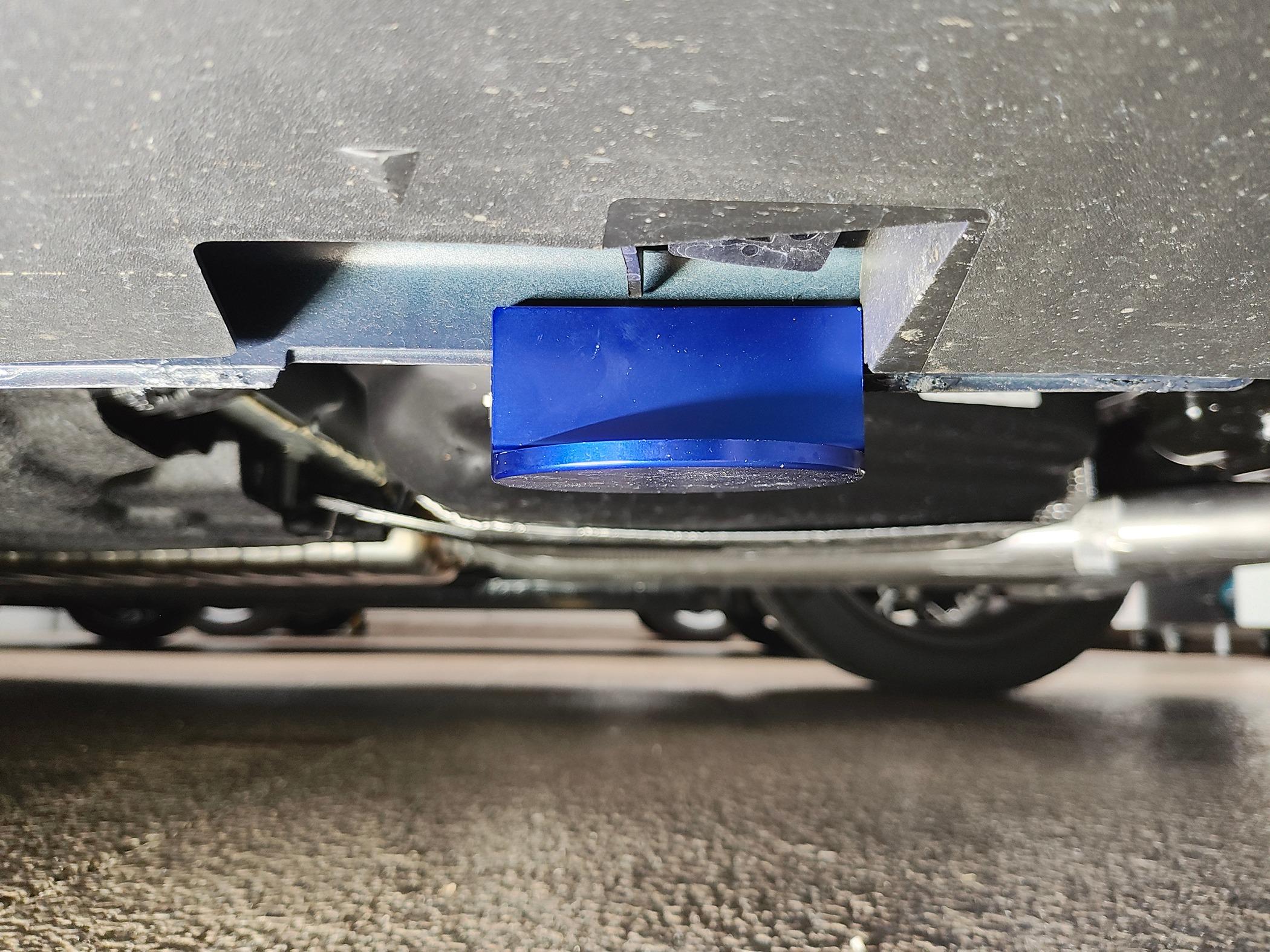

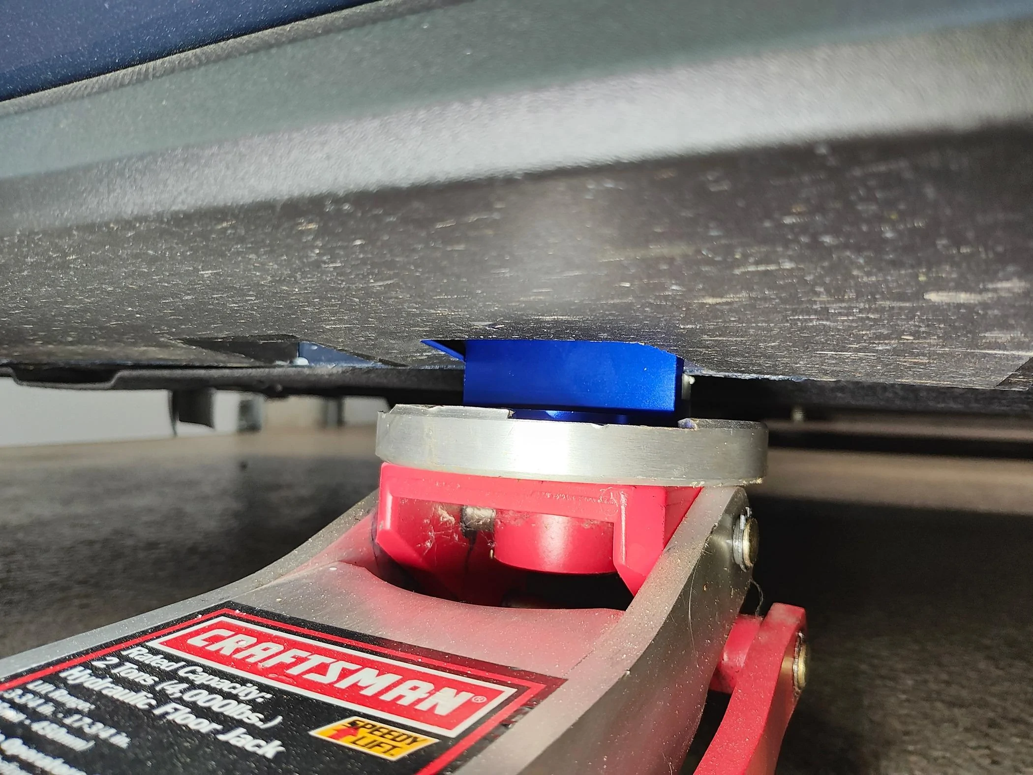

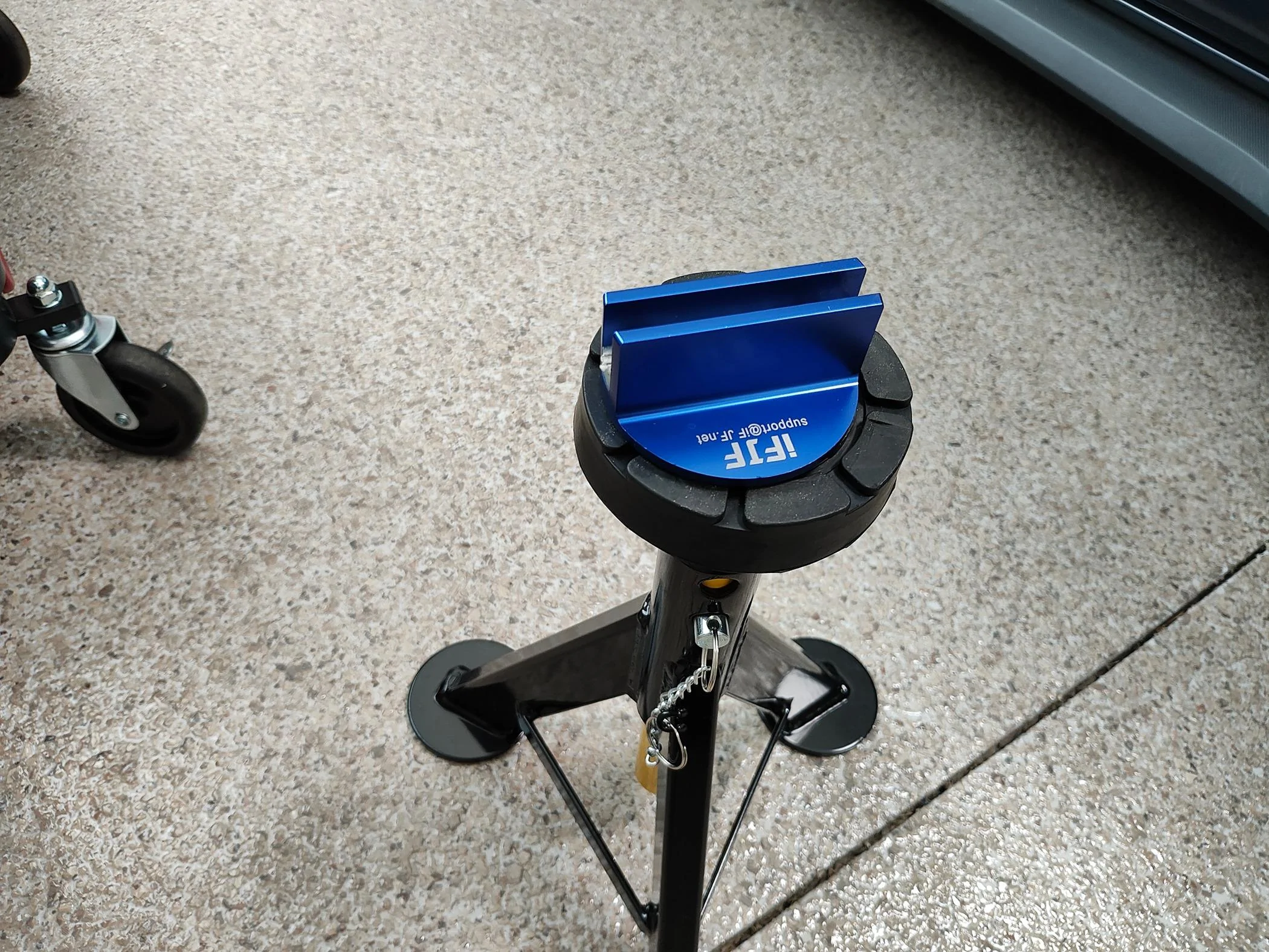

I use 4 of these https://amzn.to/4aE1eJb (actually 5 with one for the jack) I have only jacked up the Dark Horse twice but worked great both times no damage to the pinch weld.
Tested the Byens Weld Frame Rail Adapter in pics above and also the Hockey Puck version from Mission Automotive. Both worked fine, no issues...think it helps since they concentrate on the welds.
