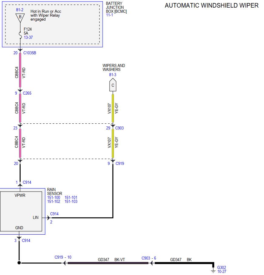

The rain sensor plug you're piggybacking off of to power your radar detector--which wire is positive and which one is ground? I don't have a multimeter right now
Is it like this?
Look at the very first post. It describes the wire colors for power and ground.
Is it like this?
White is power
Black is ground
White is power
Black is ground
OP shows a different connector than what I posted. OP's is 5-pin, but I'm showing a different 3-pin connector by the rain sensor itself (the thing that looks like an encased coin battery). The 3-pin is technically the rain sensor connector. Base model Mustangs don't have a 5-pin like OP, but we all have the 3-pin. It's also what third-party vendors are using (i.e. FitCamX uses that plug, and various Amazon sellers selling radar detector cables).
But I think my pin labelling is correct from comparing to other Ford model forums (pic below not Mustang, from an Escape or Ranger or something):
I don’t have the answer for that. For someone else that may try to to help you, what electronics do you behind the cover? Mine has everything, so I don’t know what the model breakdowns end up being.

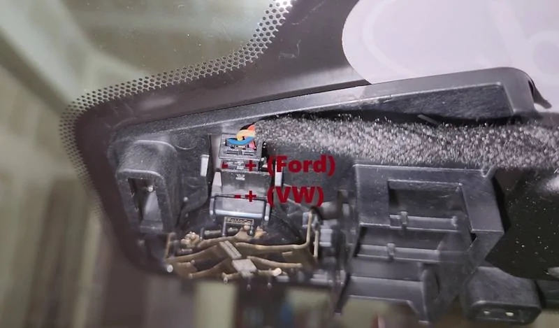

i did some referencing of wiring diagrams and parts, and it looks like OP tapped into the auto-dimming rear view mirror for power. here is the connector on the mirror.
Is it like this?
In my case white is power and black is ground. However mine is a Dark Horse premium and it looks different than mine I seem to have five wires I think it's been awhile.
