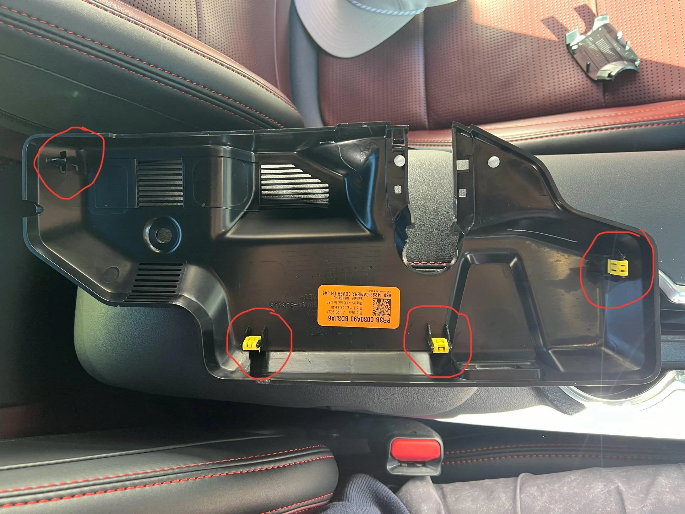

To take off the big housing, I started on the driver’s side with just my fingers (a trim removal tool would be great here). Start at the top and slowly pull down with your fingers running across the edge. There are only 4 tabs, and once you get the left tab loose, it’s much easier to do the rest. The tabs are circled in red below.
The tab on the far passenger side gave me some trouble. First off I think the plastic tab was not made properly because it’s all twisted. When I got the housing off the yellow clip stayed on the window. Hasn’t caused me any issues but just be careful even if I wasn’t. It’s sturdy but I’m sure you can break something.

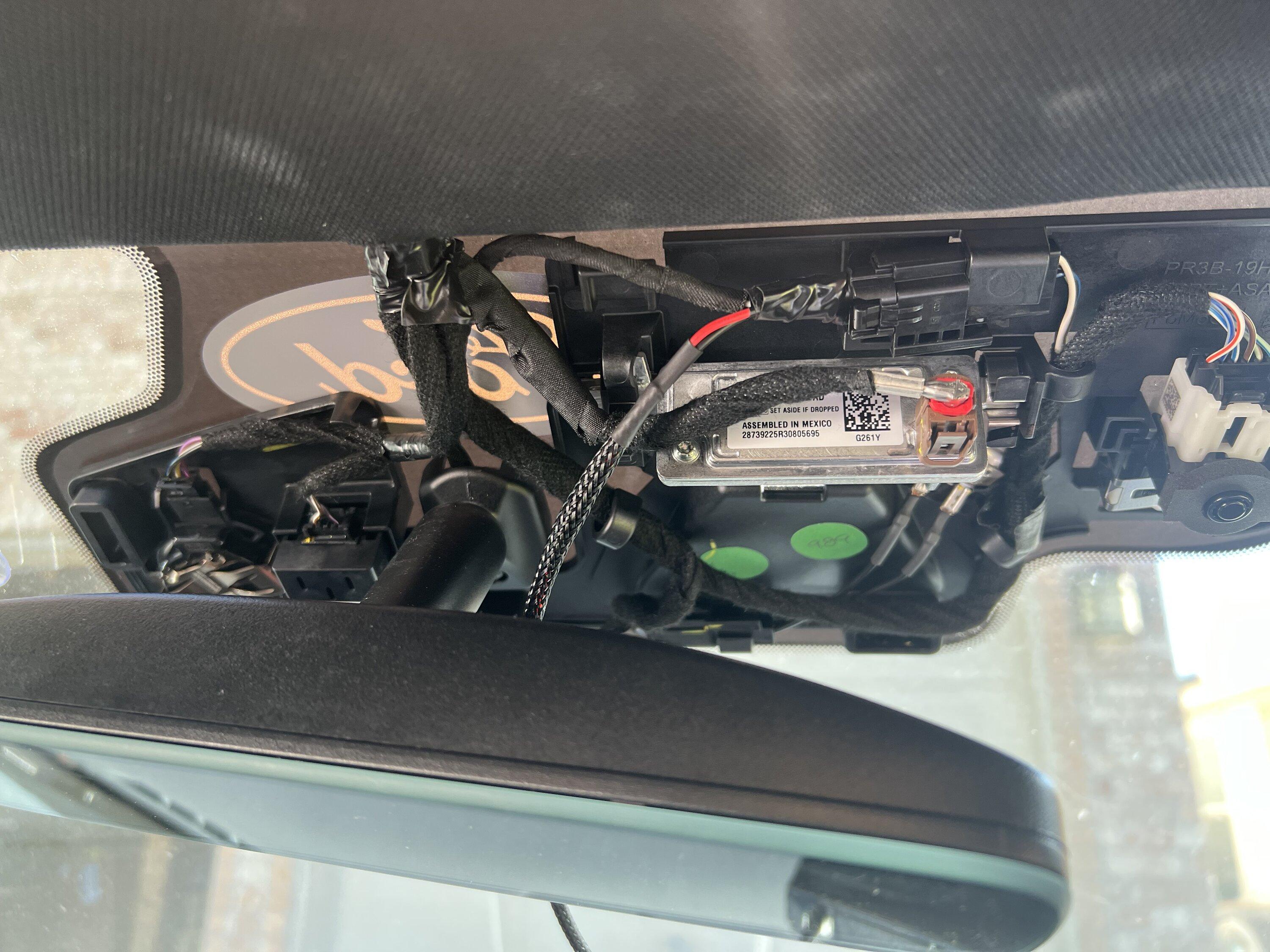

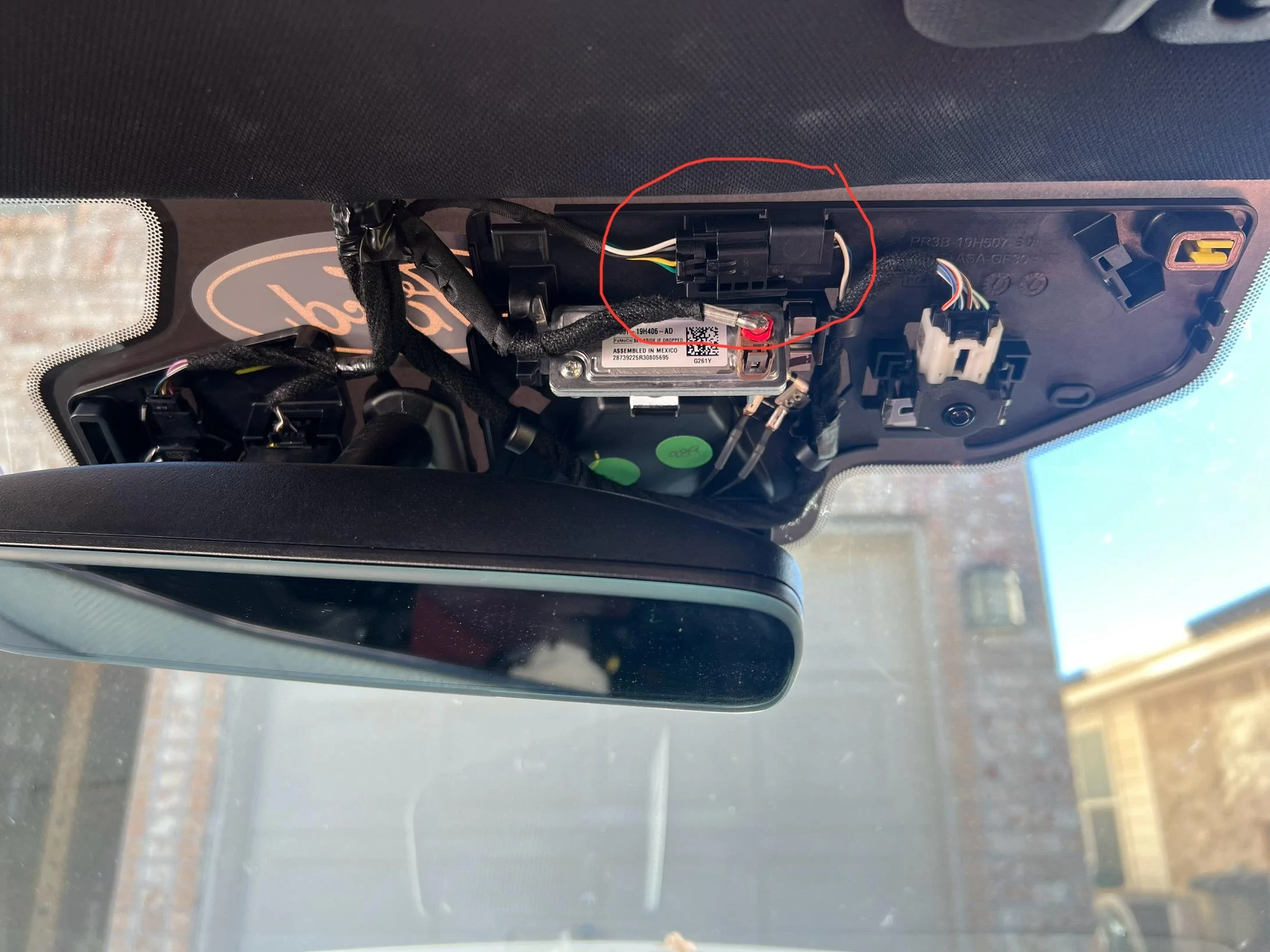

With the housing off, your mirror will now look like this. 12V switched power can be drawn from the rain sensing wipers which is circled in red below.

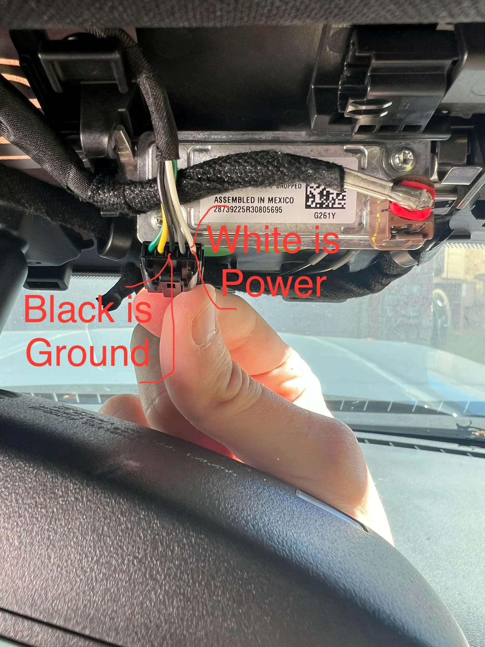

Unplug the sensor and look for the white and black wires. White is power and black is ground.

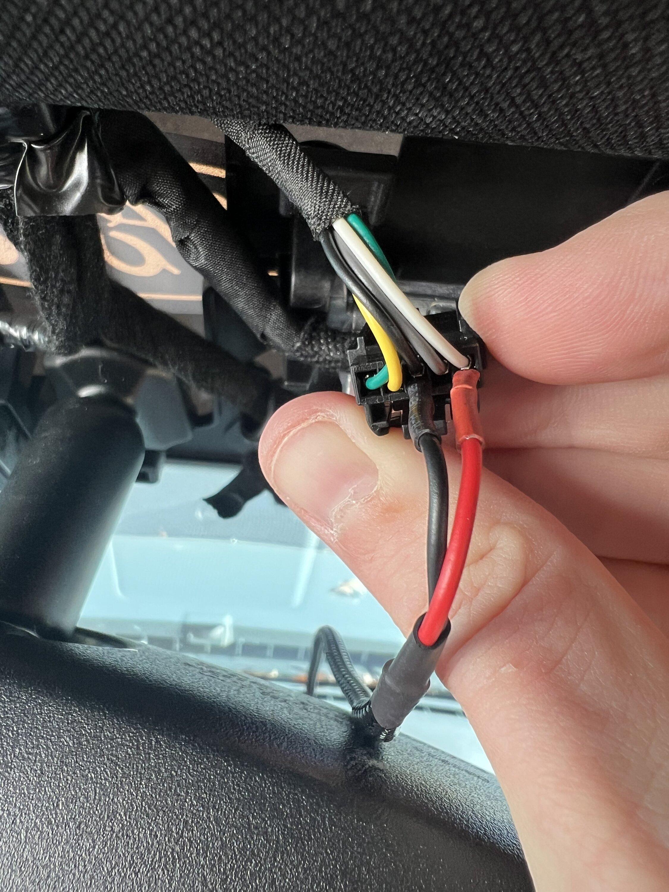

I used a simple tap in pin harness and just slid the pins into the holes where the wires go. No cutting or splicing needed. Something like this from Amazon
Once you insert the pins it will look like this!
I wrapped the wires with some electrical tape just so nothing comes loose and plugged the connector back in.
TO CHECK IF IT WORKS YOU HAVE TO PLUG THE CONNECTOR BACK IN. It will not work with the connector disconnected from the windshield.

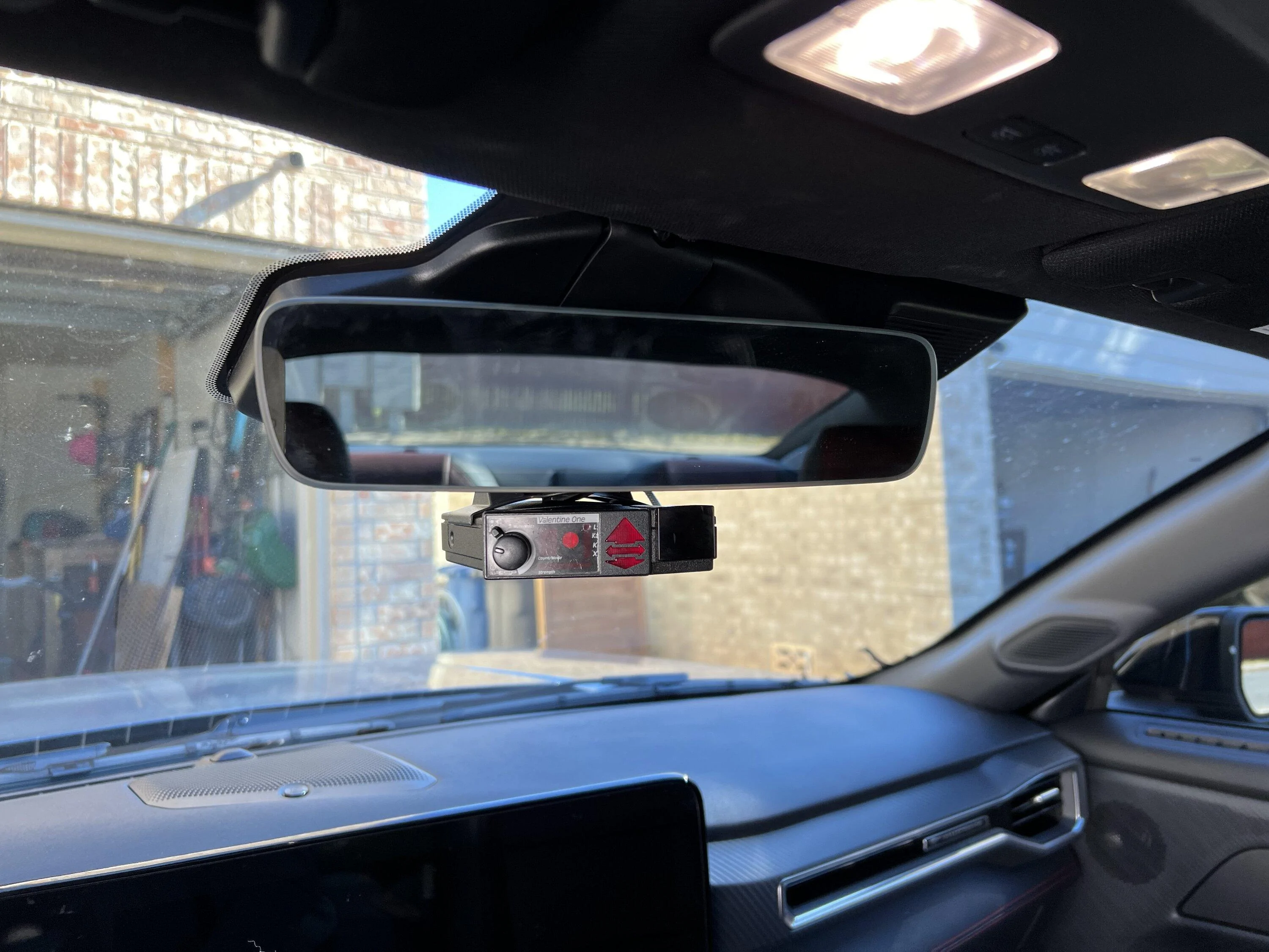

Now put everything back one. I routed the cord out the “back” of the housing, near the USB port. There’s actually a slot on the right side of the housing for a cable but 1. My cable was too short to do that and 2. The cable just looks dumb hanging out so much.

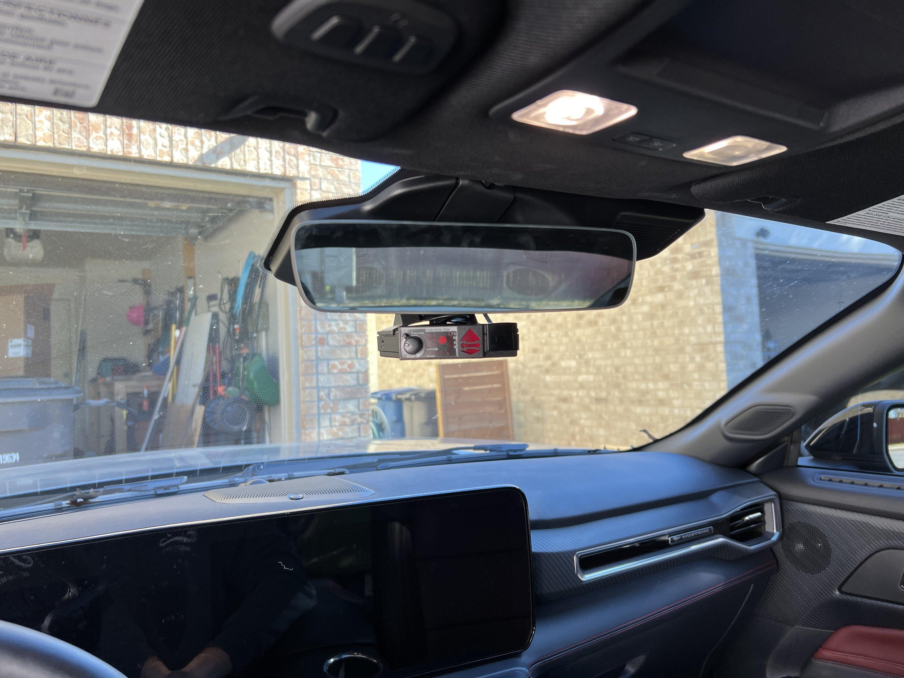

Congrats!! After about an hour or so you’ll have a real nice looking and sturdy mount with a radar that turns on and off with the car and no wire routing or splicing needed. I hate the suction cups and like a clean look. Here is my final install picture.

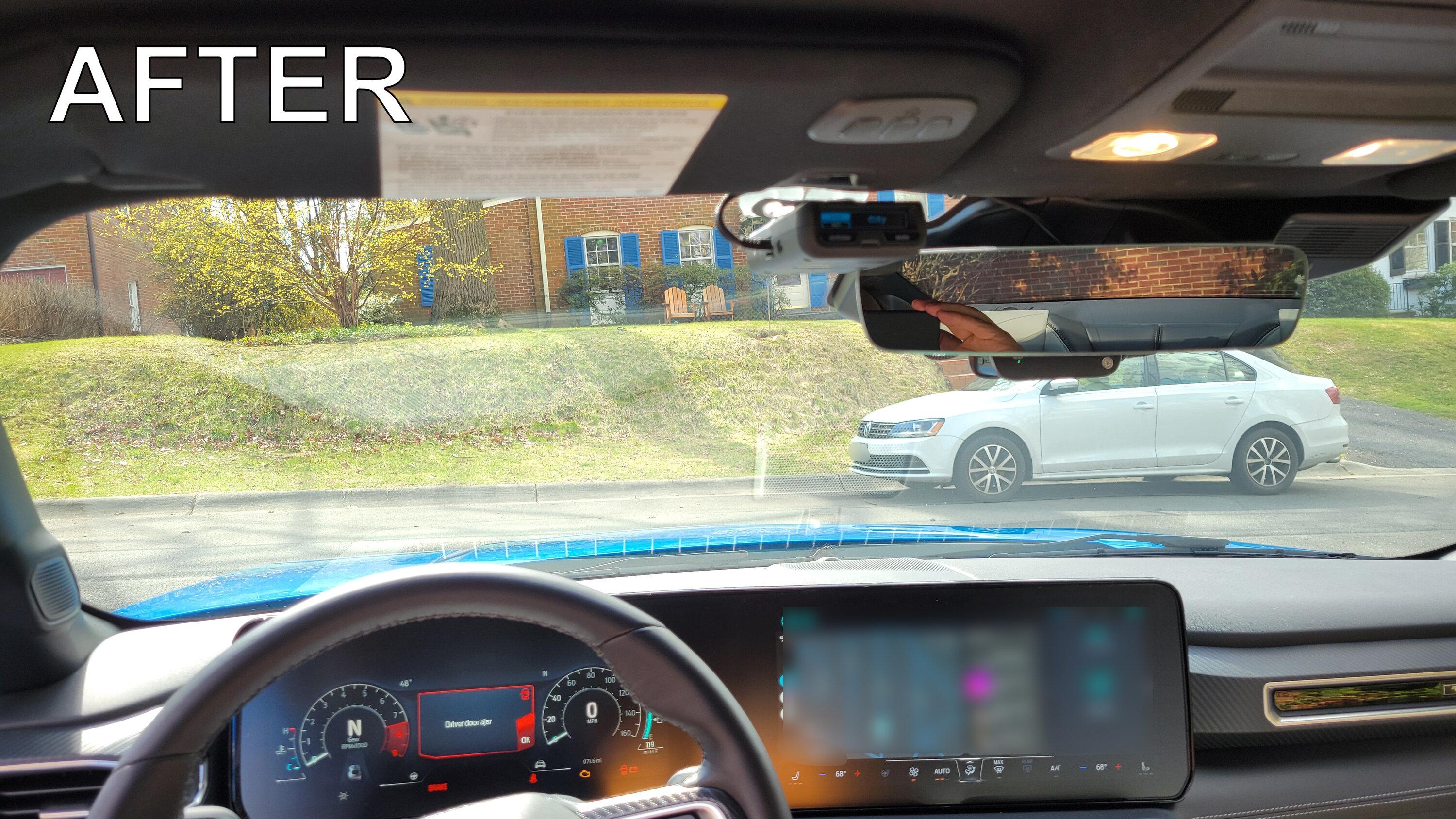

@Interstellar Just knocked this project out this afternoon. Thanks for the write up. Made it probably an hour quicker. Got my V1 G2 mounted.
