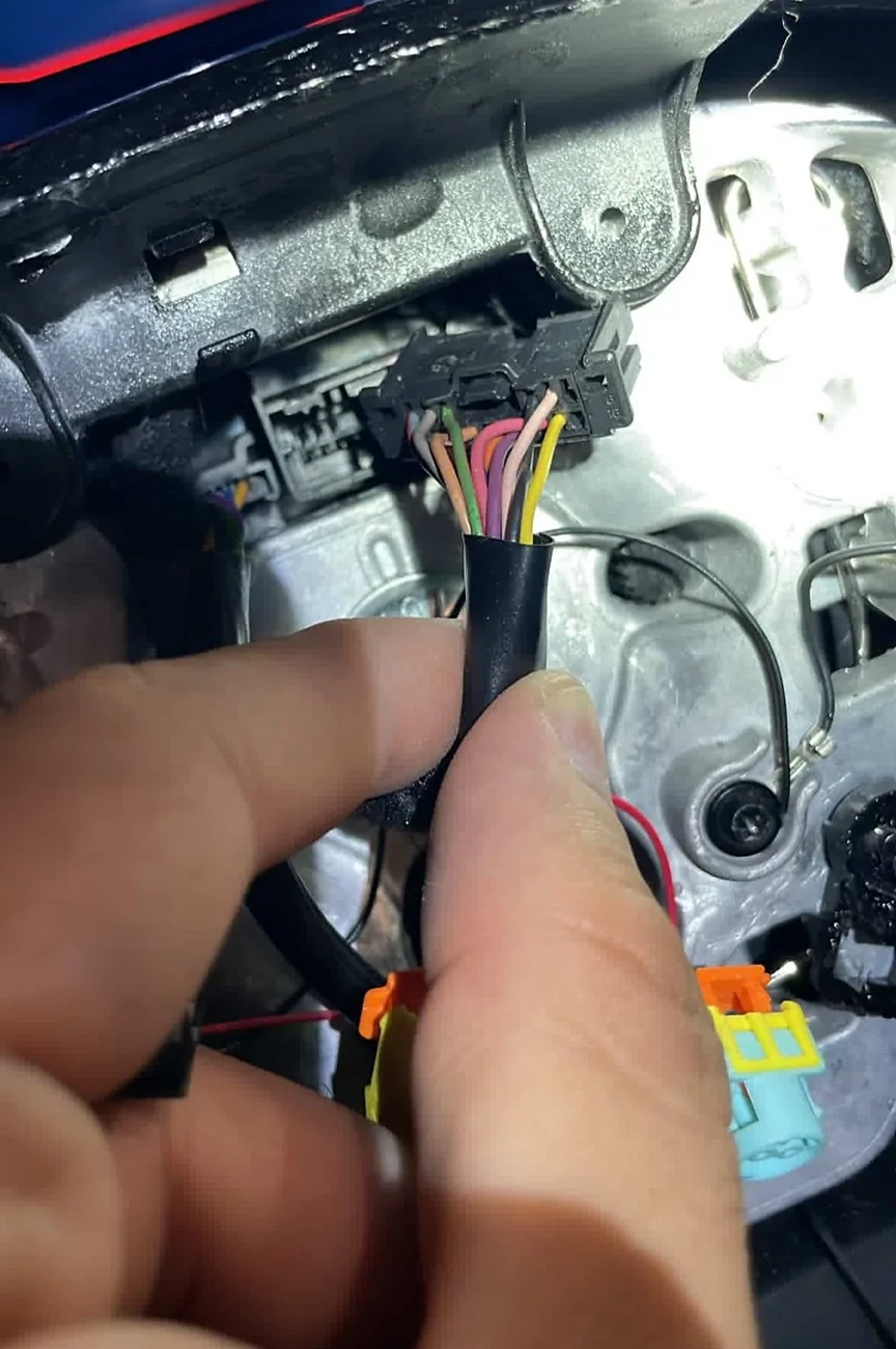

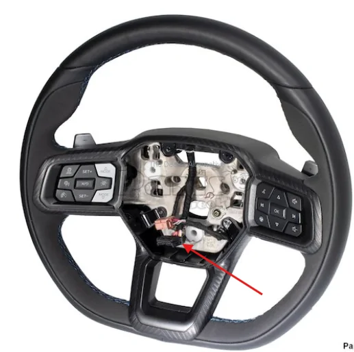

I've installed a carbon fiber steering wheel with LED lights on my 2025 Mustang GT, The problem I'm having is the wire I tapped into, it's probably a dimmer 12V source where at night the voltage drops from 12V to 5V. I found an empty slot (next to the yellow wire were I previously tapped into) in the steering wheel connector that connects to the clockspring (See the photo). but I need a wire terminal connector that fits this exact one. Any idea where I can find it? Or if you know a better 12V source (that does not drop voltage at night) please let me know.
