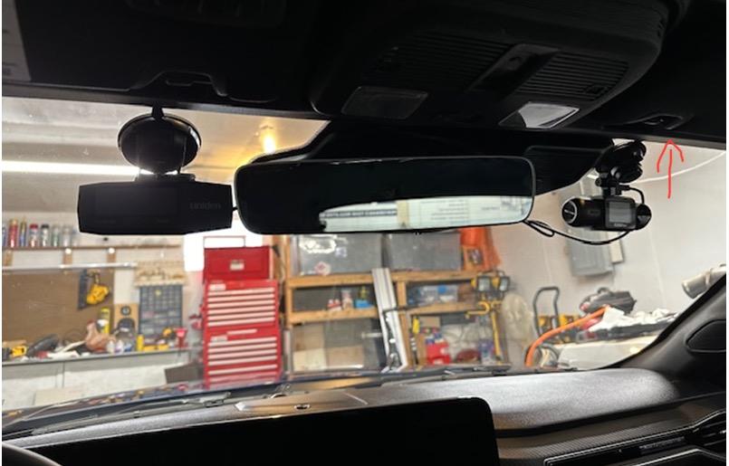

Same, mine did the exact same thing yours did too where the one difficult yellow clip stayed with the window. Just had to pull a lot harder and bend the plastic more than I wanted to. You really do have to pull hard enough to the point you think you are about to break something. Probably would have went a lot smoother if I found my curved panel tool. I'm very happy with the install now though. Thanks for the great write up! I just need to find a shorter right angle USB cord for my dash cam now.

Looks good glad you got it off finally lmao.
I have about 5 feet of thick wire from my dashcam tucked into the headliner right here. It’s not attached just tuck the wire

Good idea! I noticed there is a gap there at the headliner when I was messing with all of this. I wonder if it will kind of wedge pressure fit up in there or if it will be falling out from time to time. I'm guessing the rearview mirror housing would probably keep it in place for the most part.

Yep, this is my setup as well. Super easy, and I paid $9 for the wire.

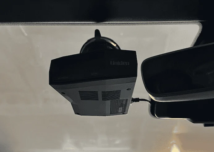

And if you use a proper trim removal tool, the cover will come off with all four yellow clips still intact! :rockon:
Tucked up nice and neat, right at the top of the windshield

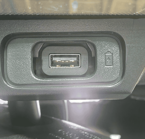

FYI: Ya'll know there is a USB-A female socket on the bottom edge of the what's mounted to the windshield, right? The icon right next to it implies that you can draw power from it.
