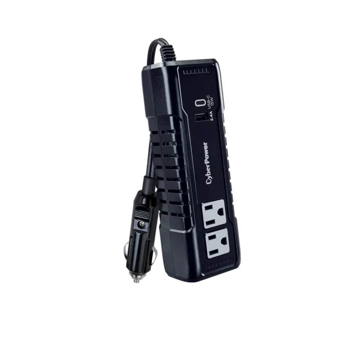

This version is the least intrusive least expensive lowest restriction (as in won’t be confused when used) for the specific requirement. The plug in cord is long enough that the power strip will sit on the floor near the laptop transformer. If you install a 110 plug don’t forget the the warning sticker telling the next dude there aint enough juice in that box for that big fridge and the coffee pot.

I could just plop an inverter that plugs into the cig port in there. But space is at a premium. Also they look tacky to me. I like things to be clean and look as oem as possible.
