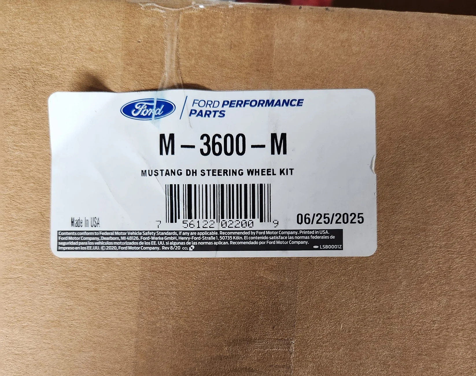

Well congrats on taking the "plunge" and popping off the airbag to check your wiring. I look forward to hearing about whether or not the base GT wheel gives you paddle shifters. Adding the paddles was the first mod I made to my 2026 EB after purchase. You will not regret the result.
This is the wheel I got from Ford - FWIW
Thanks... will definitely come back in here to report success or failure. I am going to try this wheel: https://ford.oempartsonline.com/oem-parts/ford-steering-wheel-pr3z3600fa
It's directly from Ford's OEM parts inventory and the description says its non-adapt and not heated, but has paddles, so I will assume this is the base GT wheel. I'll order this wheel and then box up the DH to return. Damn Google search kept this website away from me because all the first page hits I got were either the brand new DH wheel or take offs on ebay. Frickin' A, Google!
I would have gone with this from the start if I knew that existed. Again, newbie mistake on my part with that one.
If at the end of all this I still don't have functioning paddles, then I will call it quits on trying and just keep the GT wheel and disable the SST functions in FORScan and call it a day.
