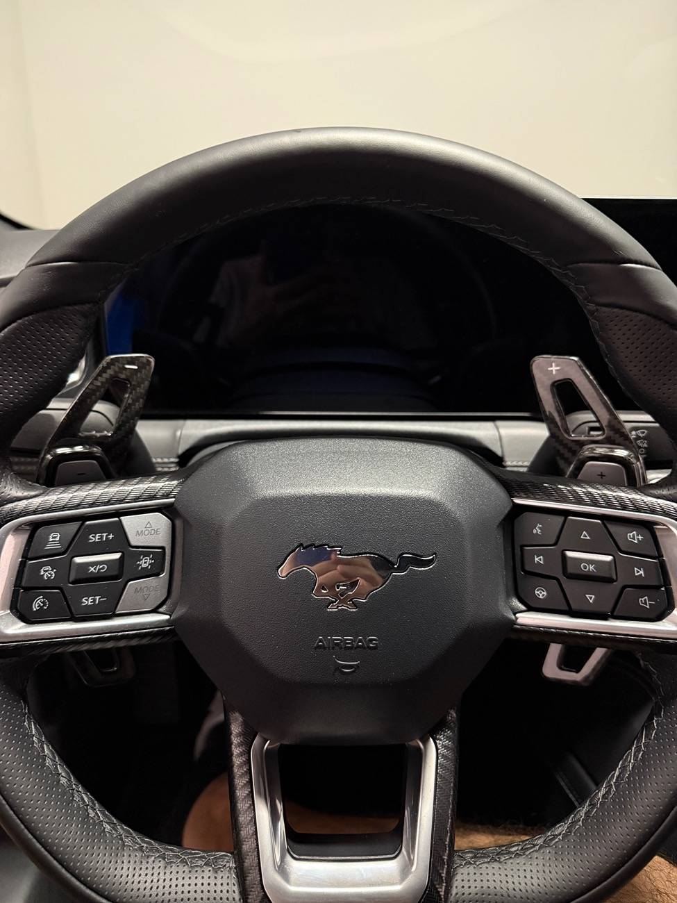

Magnetic paddle shifters with carbon fiber installed on a non-PP steering wheel.
That’s exactly what I am looking for.
Are these Plug and Play?
Do you have a link where to but them?

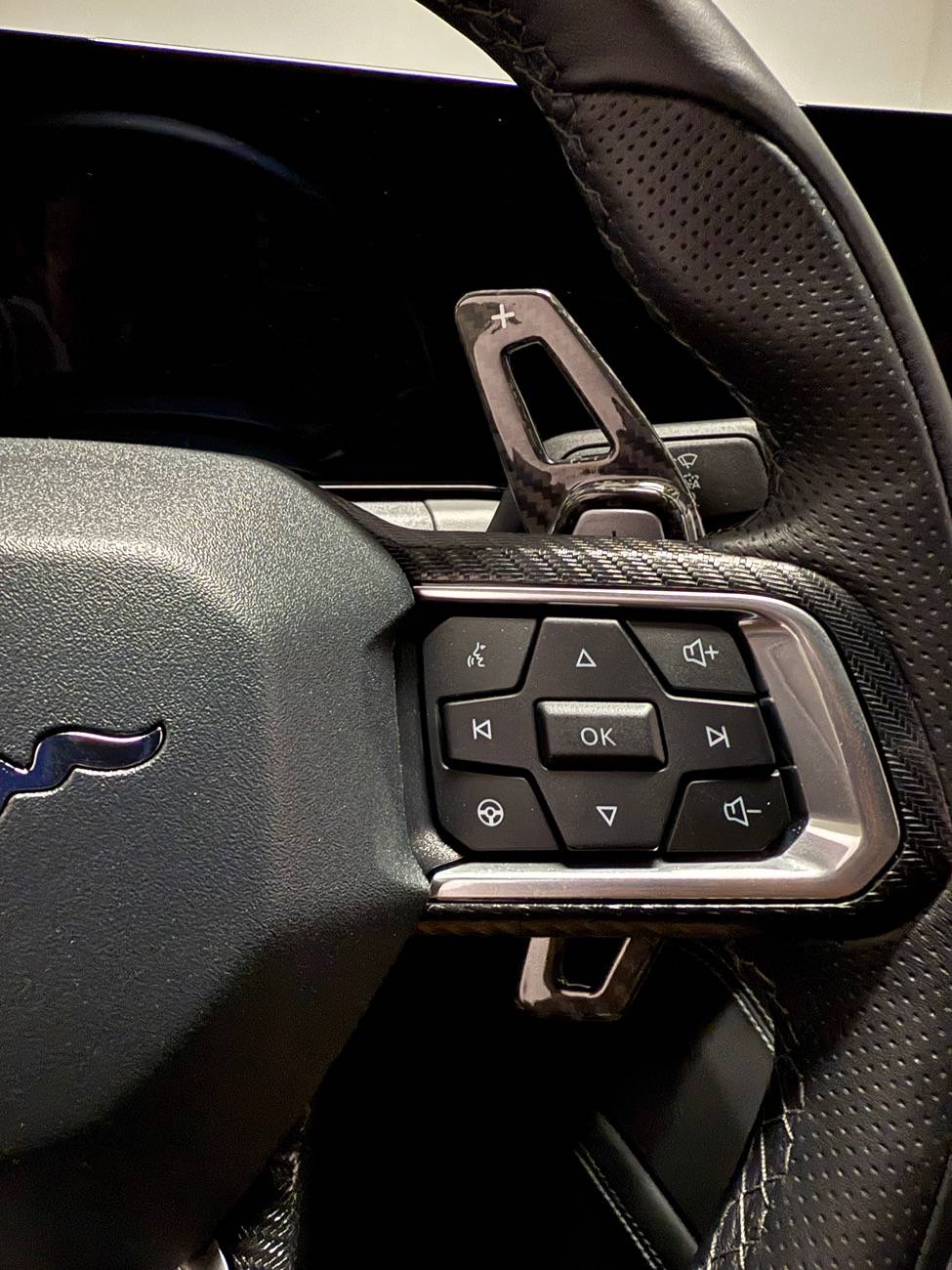

I bought these from carbonaddons.com they are put on with included 3M, high quality and easy install. Recommended.
Those look nice. Carbon fiber or metal?

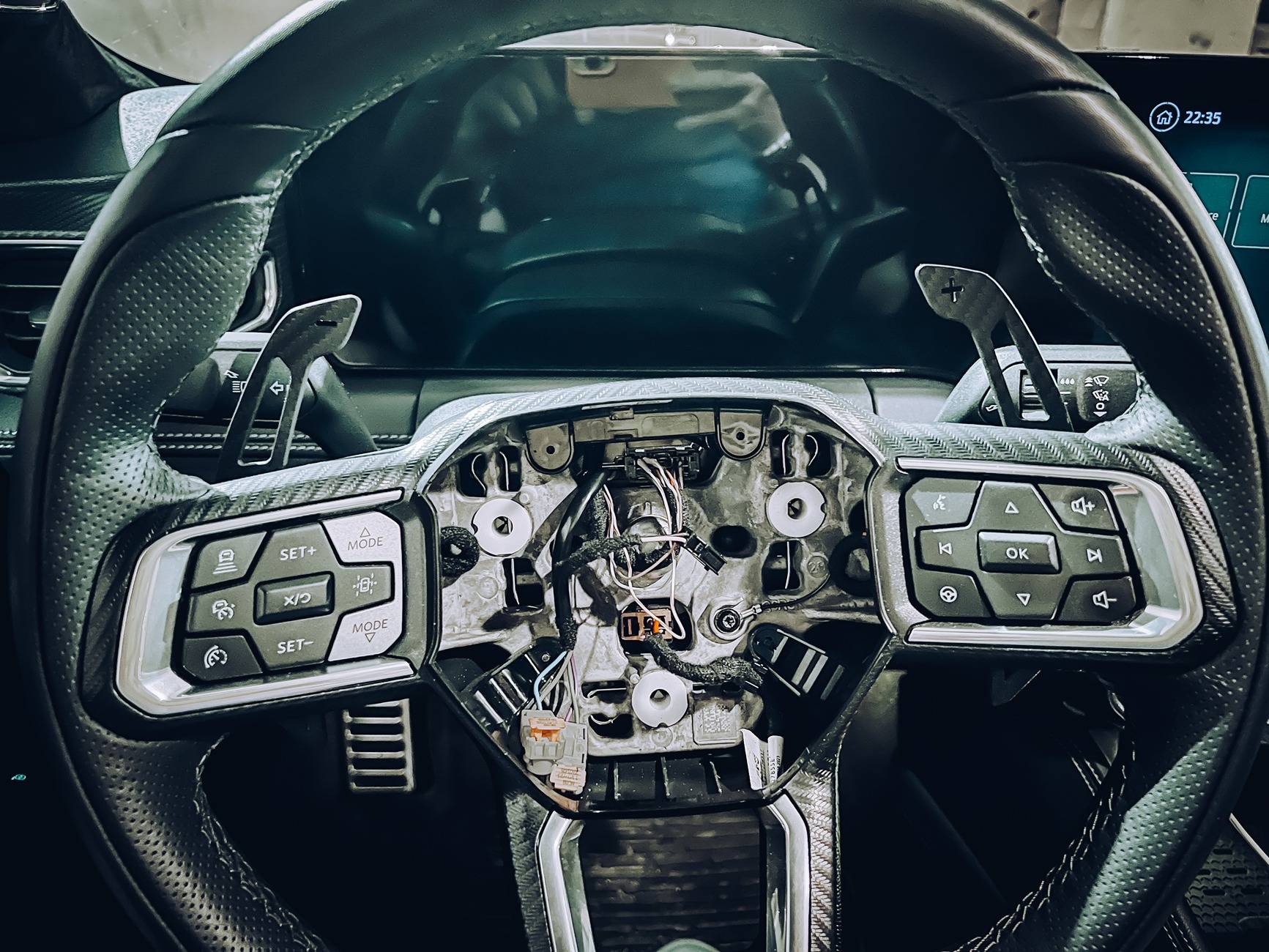

the actual mounting of the paddle shifters is different on the S550 vs S650. S550 used a clip and one screw, where the S650 uses 3 screws. the paddle itself is still secured to the base by a roll pin, so that can be removed in the same way. the wiring inside is the same too i think. its a button that completes a circuit, and that completed circuit signals an upshift or downshift. looks like there may be unused pins on the connector for ambient lighting too (not MyColor, just normal)
