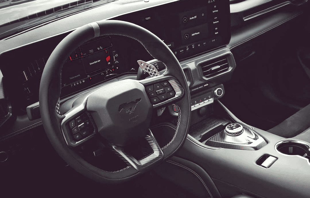

I bet the same ones they made for the S550 will fit. Those were sold at AM IIRC.
Cucurú
Jan 10, 2025
740
407
DFW Tx.
2025 300A MT-82 Oxford White
I seen a video about a guy who ordered Mercedes-Benz paddle shifters for his Mustang. I didn't watch the outcome of the video. They say the DH has titanium paddles. I've yet to see an A10 DH.
927
891
The modules the paddles are connected to are different from 2015-23 compared to 2024+.
Thanks for clarifying. I don't feel like mine need extensions so maybe the S650s are oriented a little higher than on the wheel than the S550. 🤷‍♂️

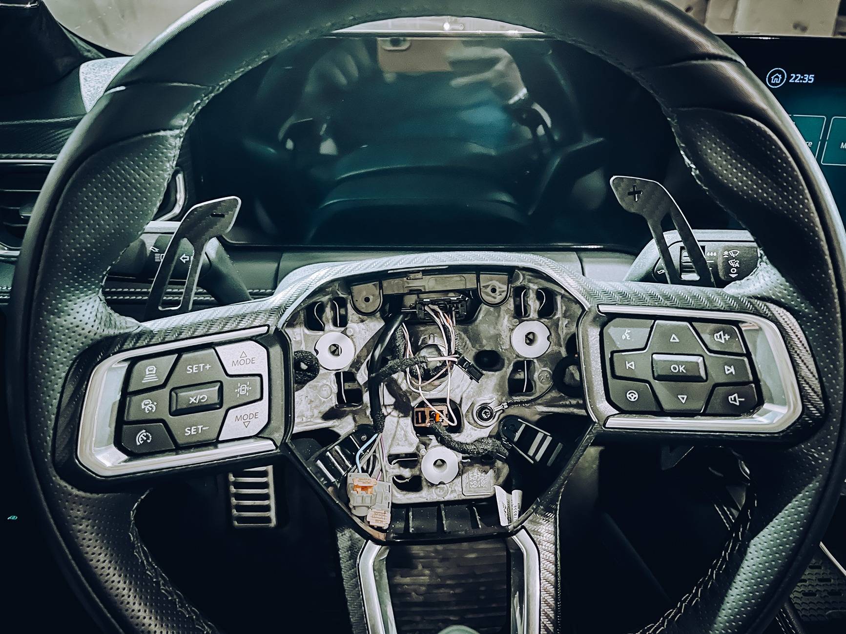

I bought these from carbonaddons.com they are put on with included 3M, high quality and easy install. Recommended.
70
2,330
3,454
the actual mounting of the paddle shifters is different on the S550 vs S650. S550 used a clip and one screw, where the S650 uses 3 screws. the paddle itself is still secured to the base by a roll pin, so that can be removed in the same way. the wiring inside is the same too i think. its a button that completes a circuit, and that completed circuit signals an upshift or downshift. looks like there may be unused pins on the connector for ambient lighting too (not MyColor, just normal)
