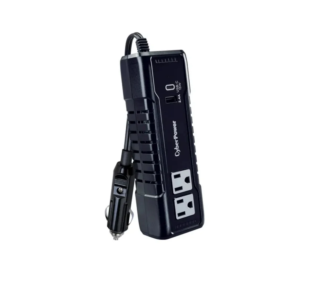

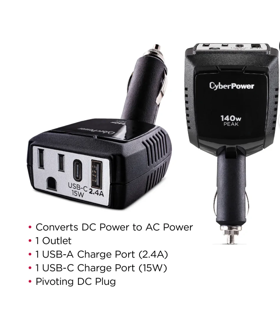

Something along these lines or something a little more permanent?

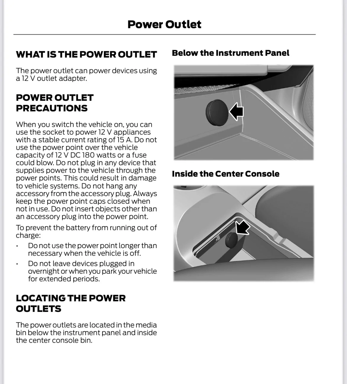

Amps to watts
edit: added image
Farmer Fran
Jul 20, 2024
73
966
1,083
2024 GT Premium Vert
According to the above post 180W max, you are looking at about 1.5A with one of those 110 plug-in inverters

12V 15A = 180W
110V 1.63636363A = 180W
So whatever you plug into the 110 should not exceed 1.63636A
4,853
2,678
12V 15A = 180W
Unless it’s dc, as in usb. Yes acknowledged redundant, but some have a distributed pass through. I wouldn’t necessarily power a dorm room fridge but a laptop not a problem. But dunno what op wants to power.
