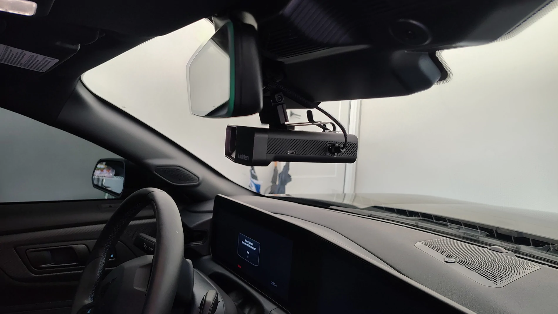

One extra thing I did was stick a tinted glass phone screen protector to the screen and stick the suction cups to that. It shades the detector from the sun, disguises it a little, and hasn't moved in months. Sticks like poo to a blanket.

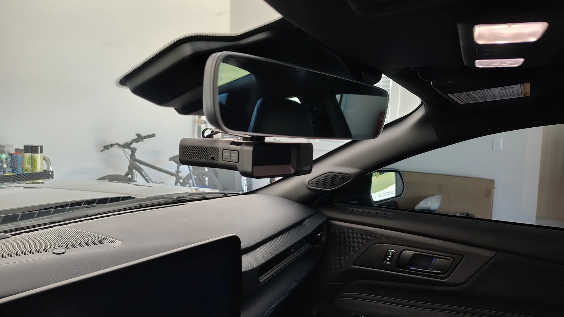

glad you found it useful, the install looks so clean it impresses me every time one of y’all shares! You’ll soon realize how much you despise people who have giant mounts sucking up on their windshield, dangling cables, or both blocking the driver’s view. Cheers
It's funny I found when you mount it under the mirror it blocks the view a lot. I'm tall so that might be part of the problems.

I'm height challenged, and I have my seat low, so it's not a problem for me. I do like that you can turn off the detector display on the V1 Gen2 so there aren't tell tale lights visible from behind.

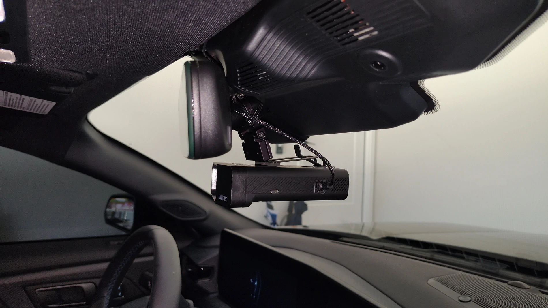

Here's the one I got, and it was perfect. There is plenty of space within the housing to push in and tuck away any extra length you don't need -- result is "no slack" and a tidy look.
