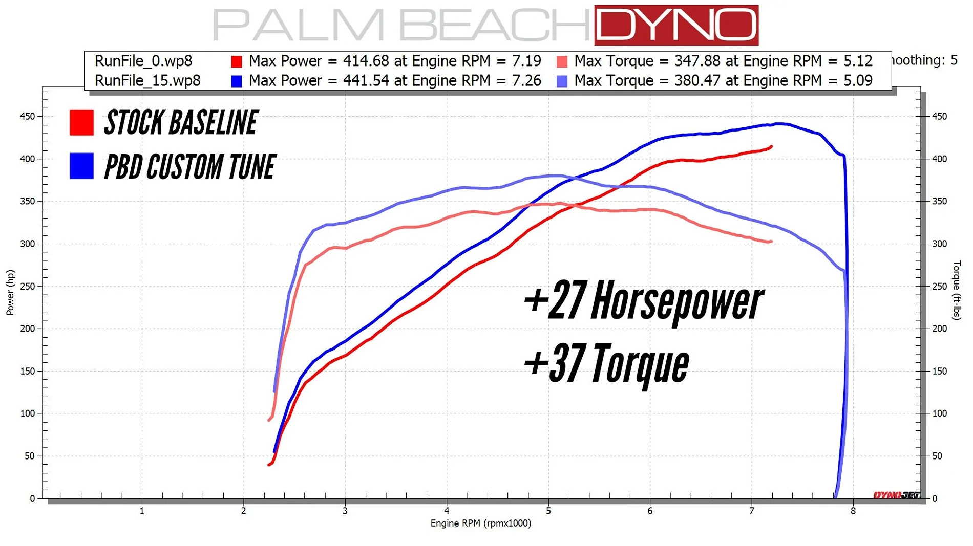

It does not appear there will be a tune for GT or DH. Aftermarket companies have them available now. I purchased Palm Beach Dyno tune with RTD4 for my DH. See dyno below. Not saying this
is the best, just that this is the ball park with a non modified car on 93 oct.
There is a concept in tuning called "area under the curve"
That tune has shifted the curve to higher RPM's and a narrower power band
I think the math might be close but I'd love to sit down and figure the average HP and torque numbers in the area under the curve
The motor with a higher average number under the curve is usually the faster car.
Now I will give credit where credit is due, as they got the HP and torque to carry past 5000 RPM which is great if that is where you are running your motor (drag racing) but IMHO for practical purposes the stock tune gives your normal street driven car more HP and Torque in the RPM range that most of us will see.
I don't know how you folks drive, I am a lot slower in my driving than most of you and I don't tend to wind the car up past 5000, so for my driving style the stock tune actually works better as it is giving me more power in the range I tend to use.

Its the torque between 2-4k that is most notable for everyday driving. Only cost me $600, so i'm happy.

What graph are you looking at? The aftermarket tune added power everywhere and extended the powerband another 500 RPM
Where are you getting "narrower" from? It didn't lose power anywhere and the powerband didn't "shift"
The tune is the blue line.
It is higher everywhere, not just at higher rpms. It certainly does not have a narrower power band. Are you looking at the same chart?
The peaks did move ever so slightly higher, but the the line is higher at the same rpm as the stock rpm peak power and torque, too. It is just higher everywhere.

Is this your car's before and after dyno or just a generic bit of advertising by PBD for their tune?
