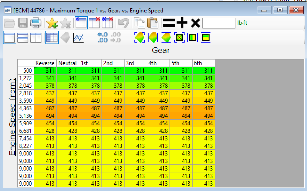

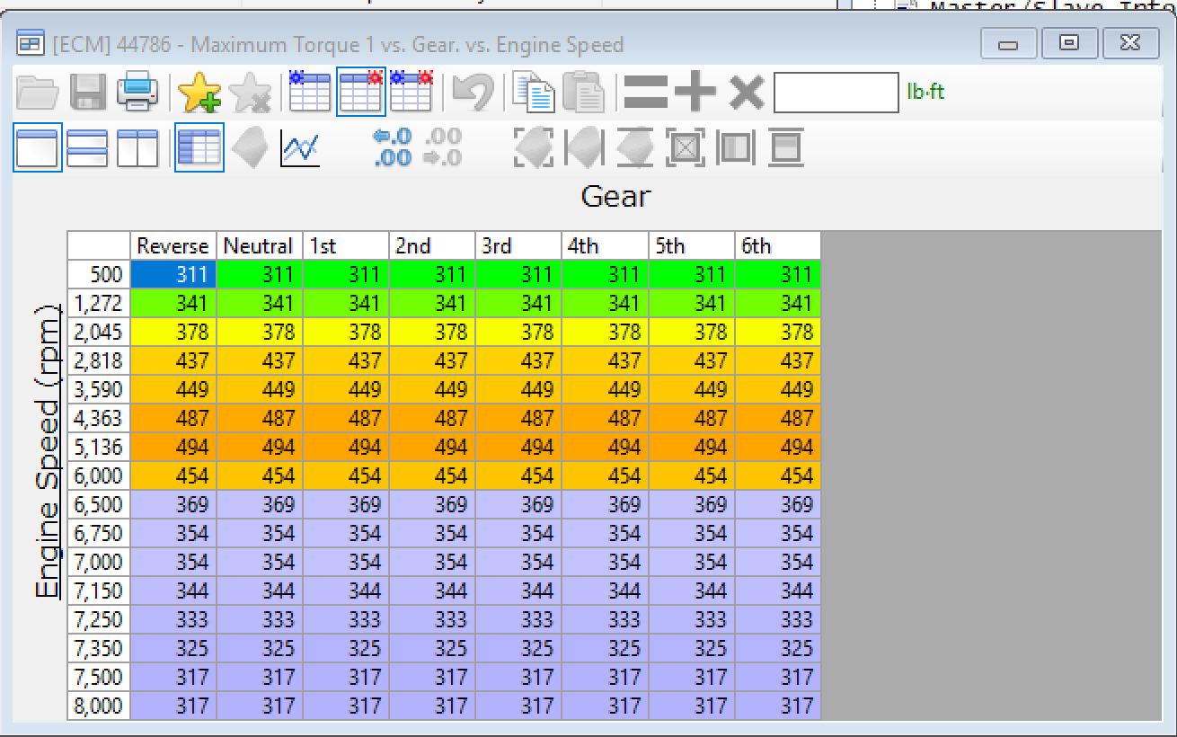

Here is the differences between a 2025 Auto DH and a 2025 GT PP.

GT gear tq management

DH gear tq management.
