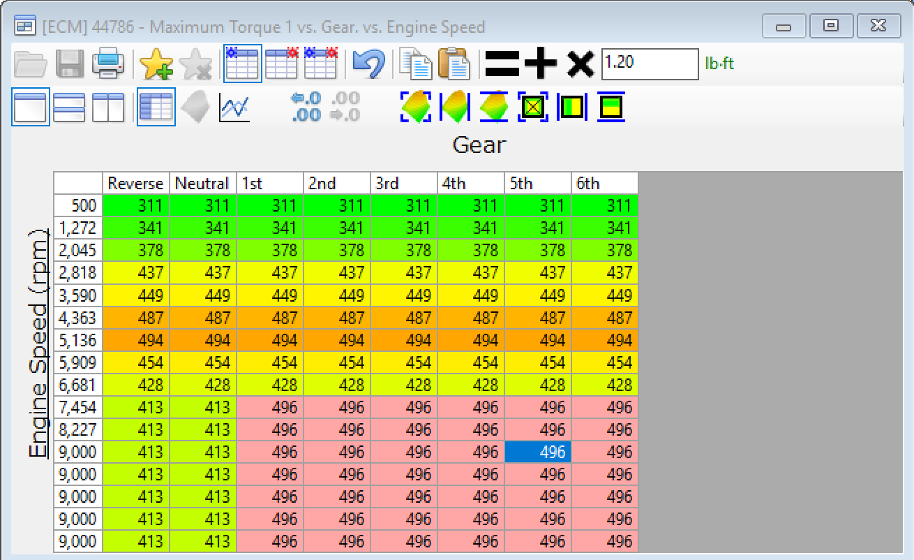

^^^^ This is why stock to stock, the DH is faster.
But when I do this to the GT, then its magic. MOMMY I MADE A DARK HORSE!@@

Could you explain post # 31 for those of us who have no idea what we are staring at, without all the snarky sarcasm? What is the chart? What does your highlighted 496 at 5th and 9,000 represent? What do all of the green, yellow, orange, and pink colors mean?

Sure. What you are seeing is desired engine tq by the PCM at the given engine speed v gear. And the lower numbers mean the PCM wants less tq (aka tq management) in the GT at similar engine speeds v gear than the DH. And by raising those values, Im allow the engine to make more indicated (calculated) tq than what the OEM has allowed. This is a big part of both the PCM and TCM, both side of which have tq management in place for various reasons. Be it emissions, driveline protection or in this case to create a delta between the GT and the DH. With all other factors equal, on paper the DH's straight line performance at least, looks to be a placebo. And in practice, it has proven to be as well.
If I take the values in the GT tq management tables, and match or increase them beyond what the DH has, then the PCM will allow the GT to make more power at higher RPM.
The scale of these tables is also in place to cap or as we say "clamp" the GT to hold its current tq management values well beyond its hard limiters. All of which can be changed. When we uncork the GT, it has proven to be an absolute beast.
Now dont get this twisted thinking that if we do the same to the DH, that it will be some level above the GT. Thats what Im telling you isnt happening. Once we work our tuning magic on either car allowing them to push to their absolute limit of what a stock NA gen 4 coyote can make for power, you are 1:1 GT to DH. There isnt some 20hp buffer that the DH has over the GT. That was artificially put in place by Ford by using tq management to hold the GT down a bit.

Is 418 at 4,900 rpm in fourth/fifth the stock value?

Those two screen shots minus the one with the pink numbers that I changed are all stock values for the GT and the DH. They are calculated tq values by the PCM and TCM. Not arbitrary but not what you are thinking with what Ford advertises or what a dyno would measure. These cars are all controlled by their calculated tq values. Which are the same GT and DH, just managed heavier on the GT as shown.
