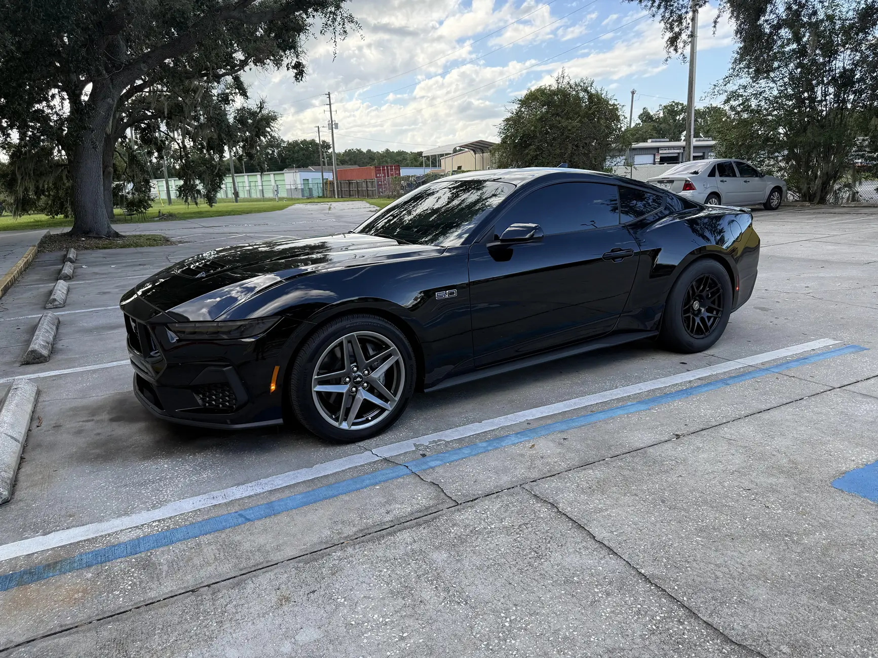

My full E car is getting about 9 when Im out beating on it. I will run through an entire tank of e85 when Im out datalogging, making pulls and 60-130 rips for two hours. But let me tell you, the car is an absolute animal now. Pulling like a freight train to 8000rpm is bananas. Wait until it gets cooler out and I can go to the track. Shes ready to go dancing with her new shoes.
