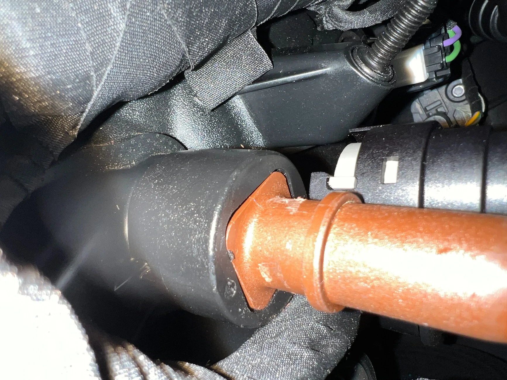

Would you mine posting a couple pics when you get a chance?

I tend to have issues with my photos posting successfully on 7G, but I'll certainly give it another shot. Here's a close-up view of this molded plastic collar around the base of the PCV Valve, similar to what Doug shared previously in this thread. The 'damage' was nothing major, just some plastic-on-plastic marring.
Were you able to get it out?
Unfortunately, I was not. After trying to outsmart that incredibly frustrating design for a few minutes, and finding no help online, I finally threw in the towel to avoid actually breaking it beyond repair (and then needing to replace the entire valve cover, apparently).
Good news is, you cannot see the scratched up PCV Valve tip underneath the quick disconnect hose that attaches to the catch can. If you believe that this knocking sound (buzzing from this area seems to be normal operation) is being caused by a bad PCV Valve, I would probably recommend taking it back to the dealership to have them remove/disassemble the valve cover under warranty. Seems like an unnecessary risk otherwise, especially with that brand new long block replacement. Best of luck.
