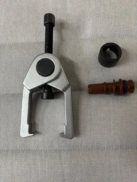

Got the collar off using a 2 prong puller popped right off. I'll provide a pic of the puller and collar when I get time.
Hey can you post how you got your pcv off ? My darkhorse is doing the same thing raspy creaking electric arc sound... thank you I advance

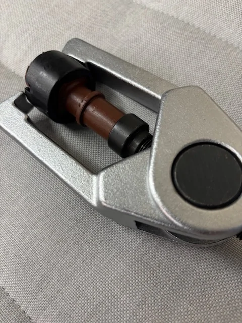

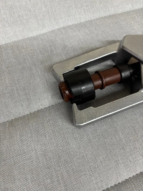

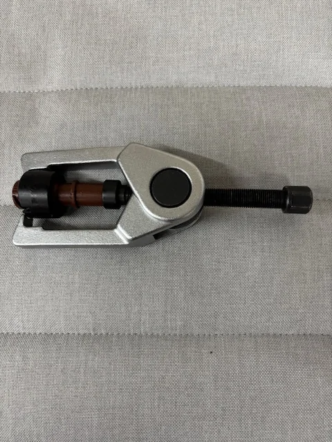

You will need a 2 prong puller with a cup head that fits over the top of the PCV valve. The claws of the puller under the collar and then just tighten the puller and the collar will pop up.
AWESOME IDEA. Thanks for sharing how the removal process works.
I only have a large gear puller, so as an alternative I possibly would use a deep-well socket just the right clearance diameter, and then apply force on the fitting's top to drive the fitting out of the grommet/seal. Of course something that would not damage the upper fitting would be necessary.
