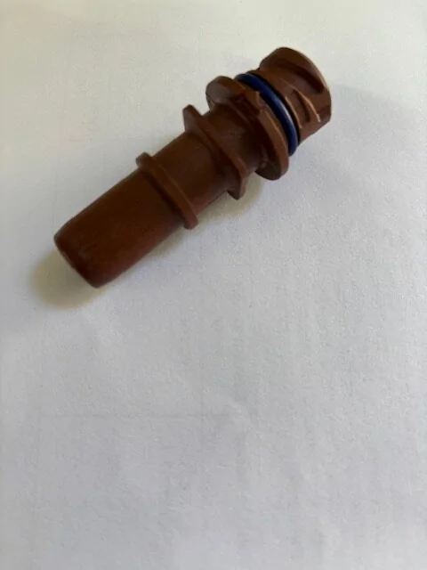

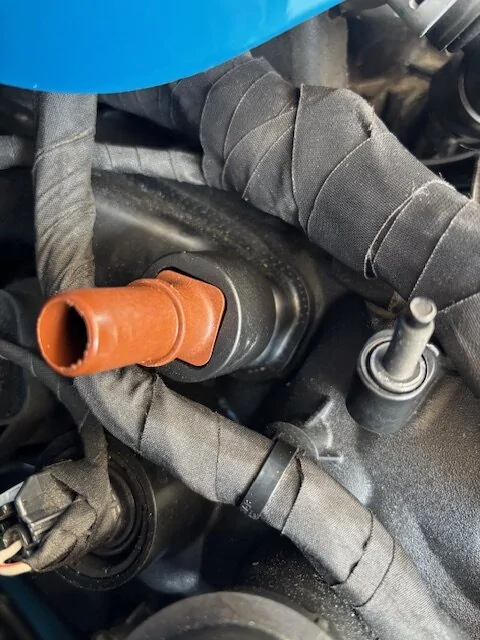

So I figured out the noise it's coming from the PCV Valve. If I remove the line the noise stops. I want to replace it and have a new one but can't get the old one out. Does anyone know how to remove it out of the square recess.
