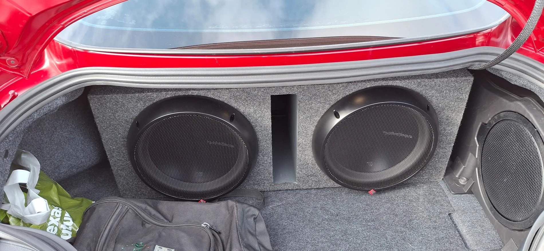

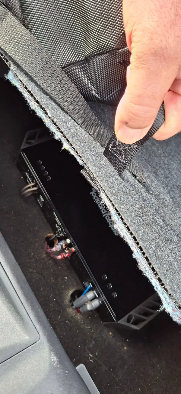

So I finally got a chance to listen to the system with the new amp and subs.
I do believe the anc harness worked, no odd noises from my speakers.
The audio shop used a t harness to tap into the factory sub. Only issue with this is that it is not a full range signal , so the sub frequency is at whatever B&O set it at. It does sound really good, but a full range input might sound better if I wanted to set the crossover on the amp closer to 100 . Second issue which is not a big deal is the Amps RMS wattage is over 1800 ,my subs are rated at 800 watts RMS each, the bass is too much for the B&O system, so I have to keep the level lower with the bass knob. I will be replacing the rest of the speakers and swapping the B&O dsp/amp with Mobridge Dsp/amp ,this will match the output on the subs.
The factory subwoofer still operational.
The Amp and Lc2i are located in the tire compartment, and I had the subs bolted down so they dont shift back when I'm doing a pull. Overall I am very happy.
A couple pics below.
