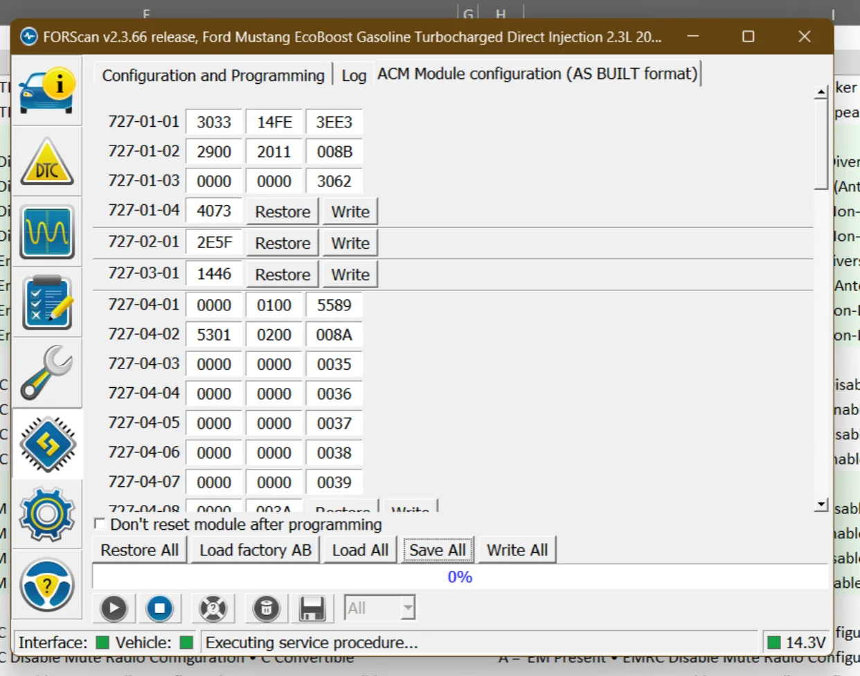

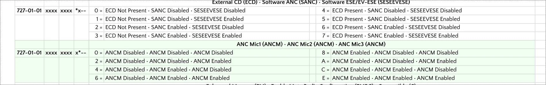

So if I read that right, to disable ANC, the final 4 characters for 727-1-1 would need to be 0EE3 ?
