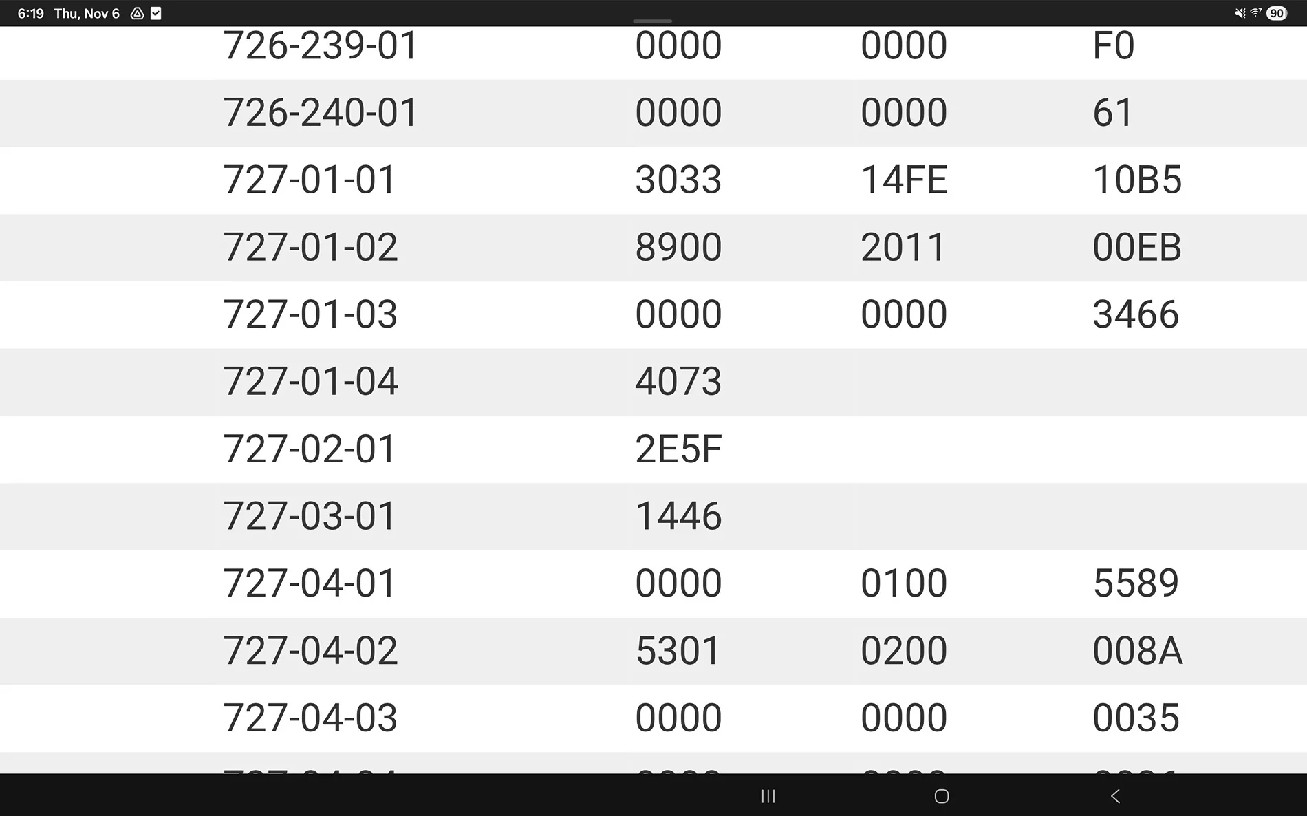

Anyone have any information on these As-Built numbers ? Here is a screenshot shot of mine, is the ESE engine sound enhancement, ANC ect enabled? Am I looking at the right group of numbers mine doesn't seem to be like the ones posted here.
I have 2025 Dark Horse Premium with handling package and appearance package

727-01-01 3033 14FE 10B5
1 = ECD Not Present • SANC Disabled • SESEEVESE Enabled... ESE enabled, ANC disabled
0 = ANCM Disabled • ANCM Disabled • ANCM Disabled... ANC microphones (1,2,3) disabled
FYI ANC is only enabled in convertible models... ESE enabled in all models.

So if im reading what your saying correctly the way mine is in the picture it's disabled already and I don't have to change anything? Sorry if it's obvious I have ADD brain. Or do I need to change something to disable the ESE engine sound?
You would change the 1 to a 0 to disable ESE.
