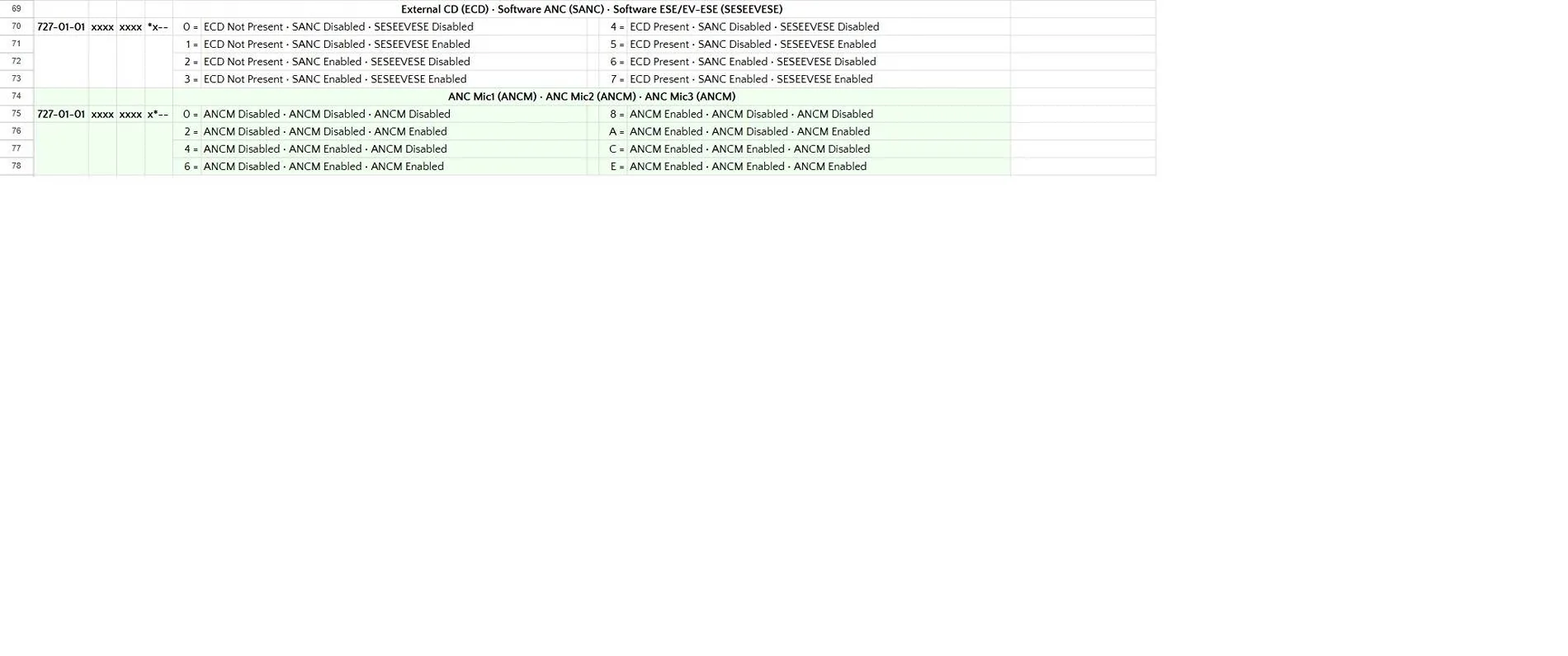

In your case: 727-01-01 3033 14FE 10B5
Focus on 10B5
First digit is 1. 1 means ECD Not Present, SANC Disabled, SESEEVESE Enabled.
Change it to 0. O means ECD Not Present, SANC Disabled, SESEEVESE Disabled
Second digit is 0. 0 means ANCM Disabled, ANCM Disabled, ANCM Disabled.
No action needed as ANC is disabled.
Focus on 10B5

Critically Important: Go to https://www.motorcraftservice.com/SetCountry?returnUrl=/AsBuilt Enter the info and save the AsBulit file which will be named as your VIN in .ab file extension. I would not change the file name, and I would recommend downloading it twice to have an extra copy. Before you close this page locate the line 727-01-01 and note the 3 sets of 4 numbers(write them down or take pic with phone). The set of numbers to look at is the 3'rd group of 4 off to the right. My 3'rd set had the ANC disabled already(set to 0), but the ESE was on(set to 1).
For ANC its the 2'nd digit x*xx where * is the digit to change if necessary. For ESE its the first digit *xxx where * is the digit to change of necessary. I changed my 1 to a 0. This is for the 3'rd set only.
