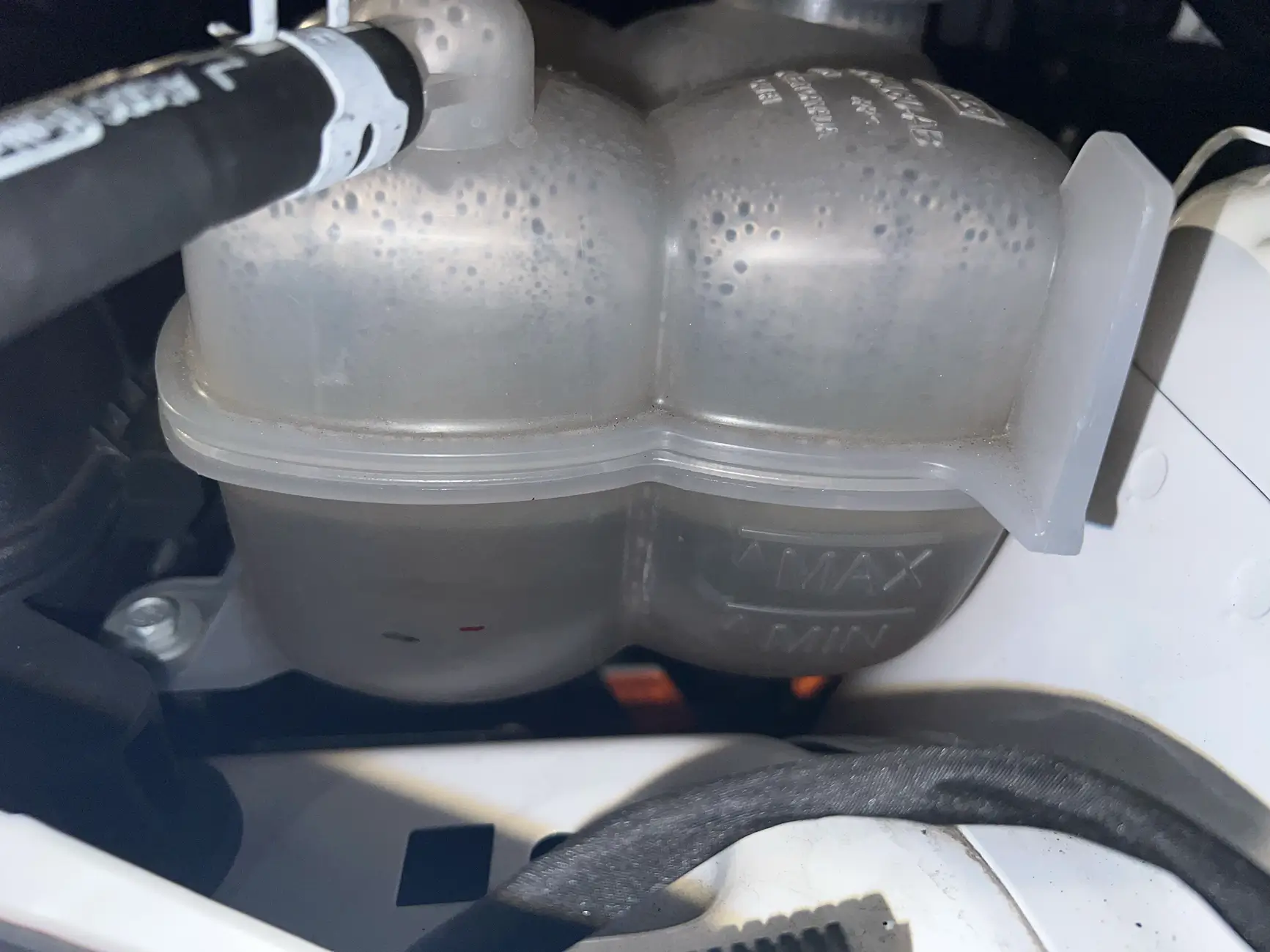

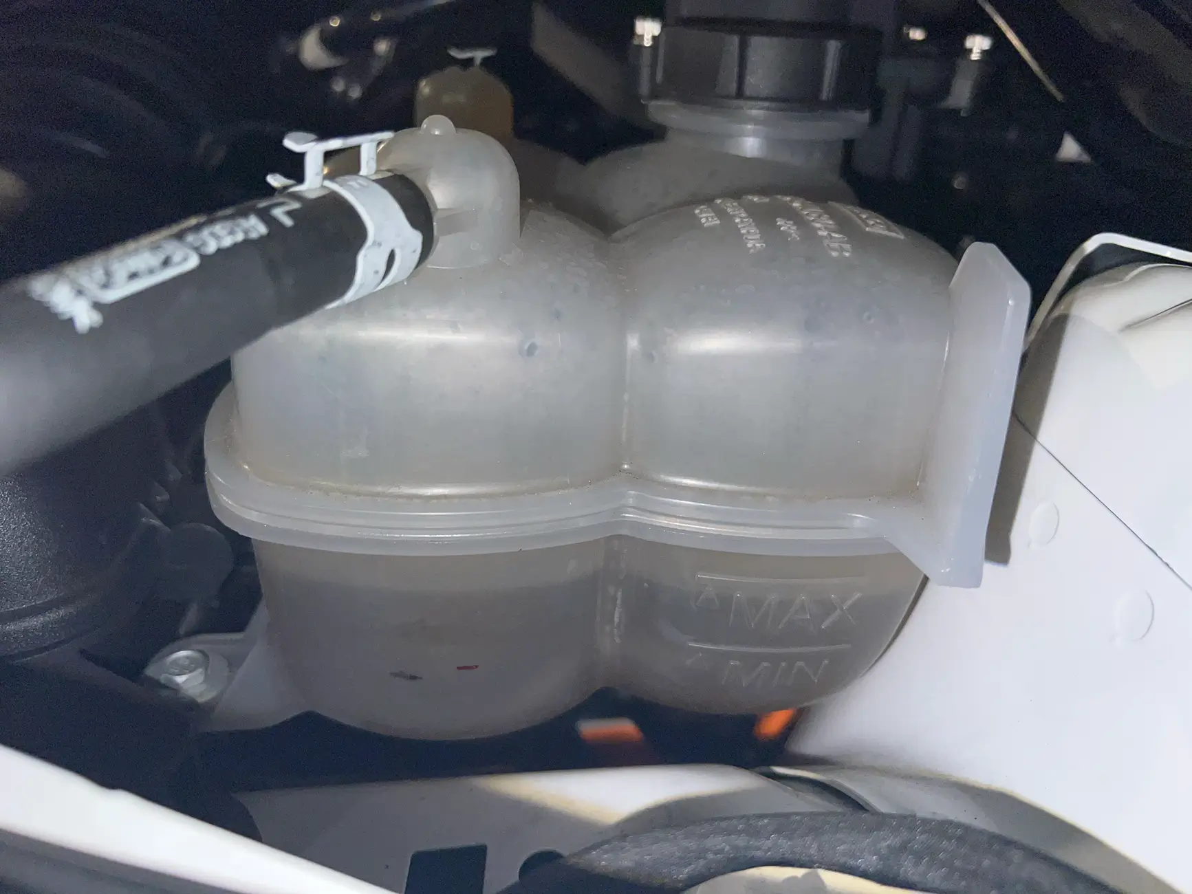

Hey folks,
As you know many cars are going low in coolant from the factory. Same happened with mine. Almost 2 months ago filled it up and since then I have been checking it almost every week. Here are the pics taken early on the morning , before starting the car and at an ambient temperature of about 20C (68F). These photos are two months apart and you can clearly see the difference. When I went for an oil change a month ago , dealer said that they found no issues, no leaks. I also see no leaks or signs of leak inside the engine bay or the floor. What could possible be happening here ?

hell that amount of variance can be caused by temperature variations.
Same thing with oil, and until recently only Harley marked their dipsticks for oil level hot and oil level cold to account for variations in volume due to temperature.
Now you know why tires pressures are expressed as read when cold, watch your tires go up at least 2 degrees when they get some heat in them
Brake fluid reservoir, same thing, the MAX amount has some head room above it to allow for expansion
Transmission fluid changes, (especially in Toyota's require the fluid to be at 192 degrees to set the level due to that fluid changing volume with temperature) are also specified to be done at a certain temperature.

If you unscrew the cap, does the level go back to max?

That difference in levels is definitely within limits. Also is the car in exactly the same position in both pics? A passenger side dip can cause this effect, leaning to passenger i mean. Absolutely normal nothing to be concerned about. Enjoy your mustang!

2025 Mustang DarkHorse
Also in the picture top, there is condensation in the tank like it's hot and the bottom picture it doesn't have it. This could be the reason for different levels?
4,696
2,561
Isn’t that the overflow tank? Air bubbles and burbs can cause discrepancies in levels.

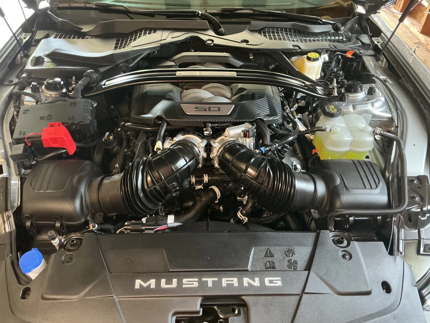

I am wondering why your coolant looks black? This pic of my engine bay is still when it was pretty new, but in any of my cars I’ve never seen coolant that dark after any mileage.
It should be a nice bright gold/yellow.

Mine looks like lemonade also :) lol I had mine for a month and a half now.

I don’t care about coolant change intervals…if mine ends up looking like used motor oil, I’d flush and fill. That looks awful in OP’s pic.
Almost makes me wonder if there’s a gasket leak or something.

Good question. I t has been like that for a ling time. I just checked the engine oil level and its in the 3 rd x - with in the limits. As for the coolant I opened the cap and I noticed an "oily" surface. It could be actual oil ...definitely taking it to the dealer this week. Here is a pic

That coolant shows a problem. Even a small amount of oil in the coolant would not show on the dip stick. I have seen coolant with 25k miles and not look as bad. Get it documented. The dealer should be on this quickly. If your dealer seems complacent find another dealer.
