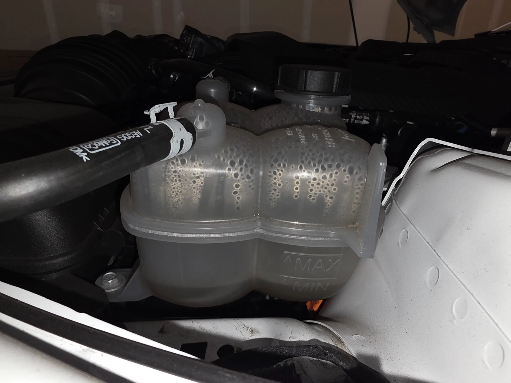

Oh boy... low coolant on my '25 GT after ~9K miles. Had the same issue on my '24 Ecoboost (which had a coolant leak from the factory). I traded in that car for the GT due to the many quality defects, but my '25 GT is apparently no better.
Other people having this? I never fiddled with the tank cap, no obvious signs of leak anywhere, no white exhaust/burning coolant. I took photos when the car was brand new and coolant was not low then, so it got consumed/leaked in the meantime. Either this is a systemic issue with S650 Mustangs, or perhaps my driving style is magically making coolant disappear.
S650 Mustang Coolant level when cold 20251202_154854 Coolant Cold (On Ramps)

I don't understand the coolant looking like dirty dishwater. I have read somewhere that coolant getting darker with use is "normal" but still... 🤔
I don't have a ton of miles on my car, but it's still bright green/gold.

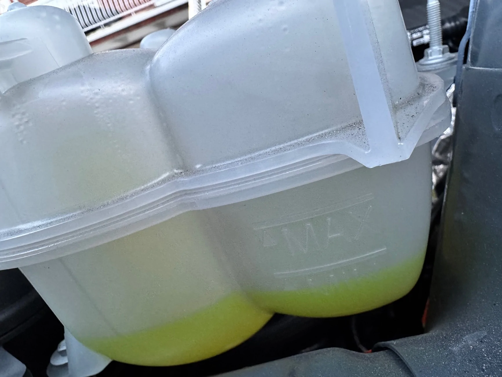

Mine came at almost—low mark from the factory, then this is where it is after 2500 miles. I bought the Motorcraft pre diluted yellow coolant from amazon, will top it off when it comes out of its cocoon.
S650 Mustang Coolant level when cold IMG_1155

This is where mine was, and to update, it is still at the min mark when cold since I topped it off.
So, this is looking more and more like it's because it's not burped at the factory.
