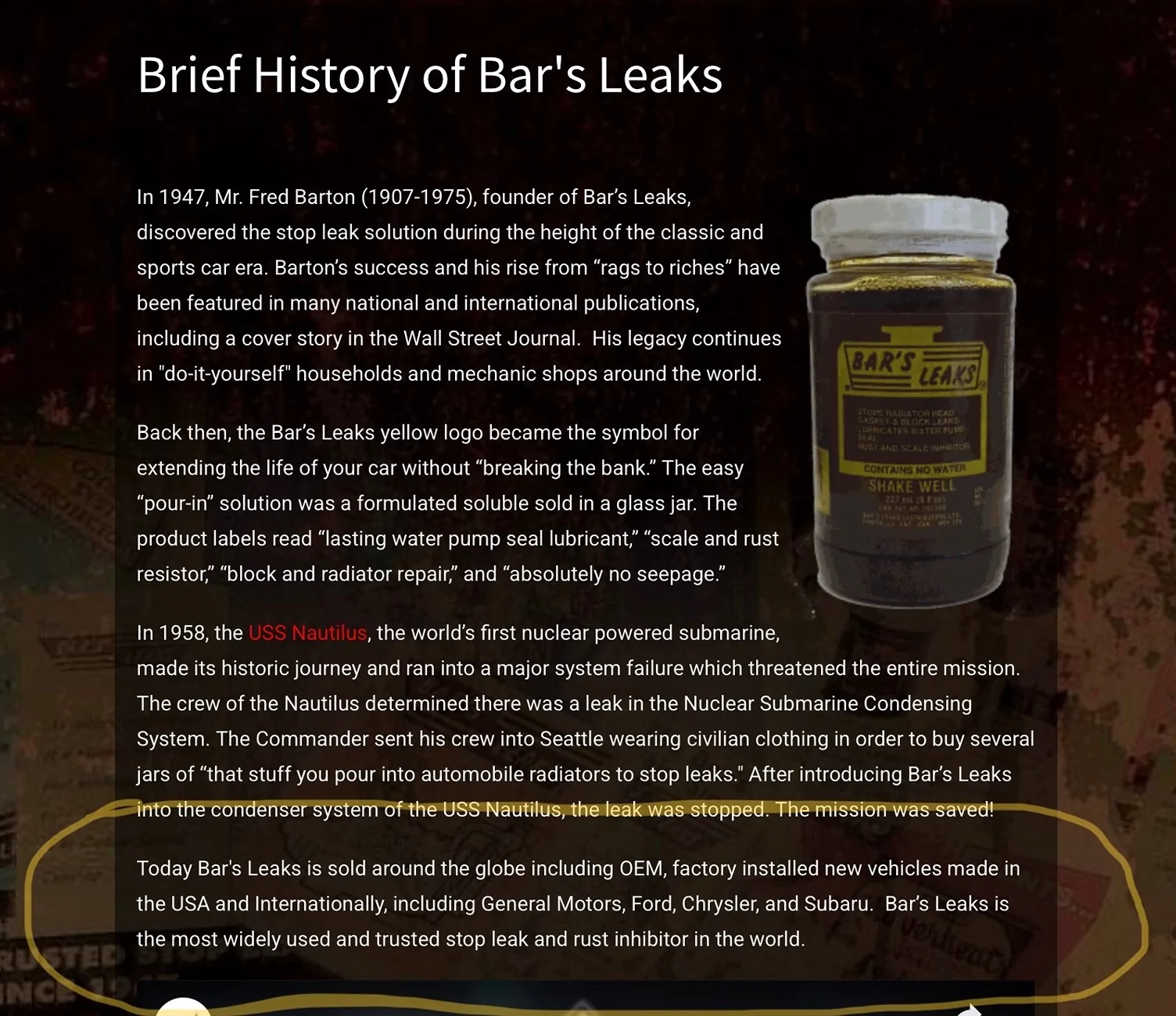

And my Prowler’s coolant was murky brown because Stop Leak was added at the factory. Apparently to make up for the poor tolerances of the engine block.
In fact, more auto manufacturers have added Bar’s Stop Leak at the factory than you think.
https://barsgroup.com/aboutus

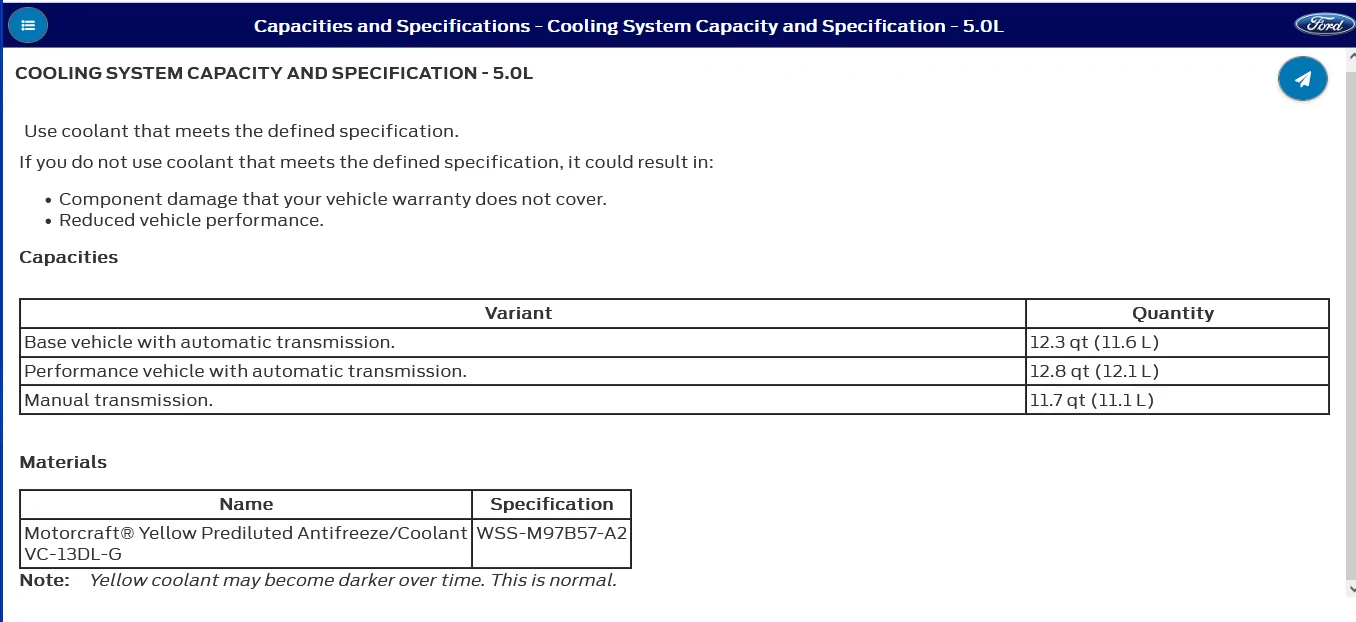

and yes, The Mustangs should have the yellow coolant.

Ford quit using the Orange stuff when they changed over to the Gen 3 Coyote.

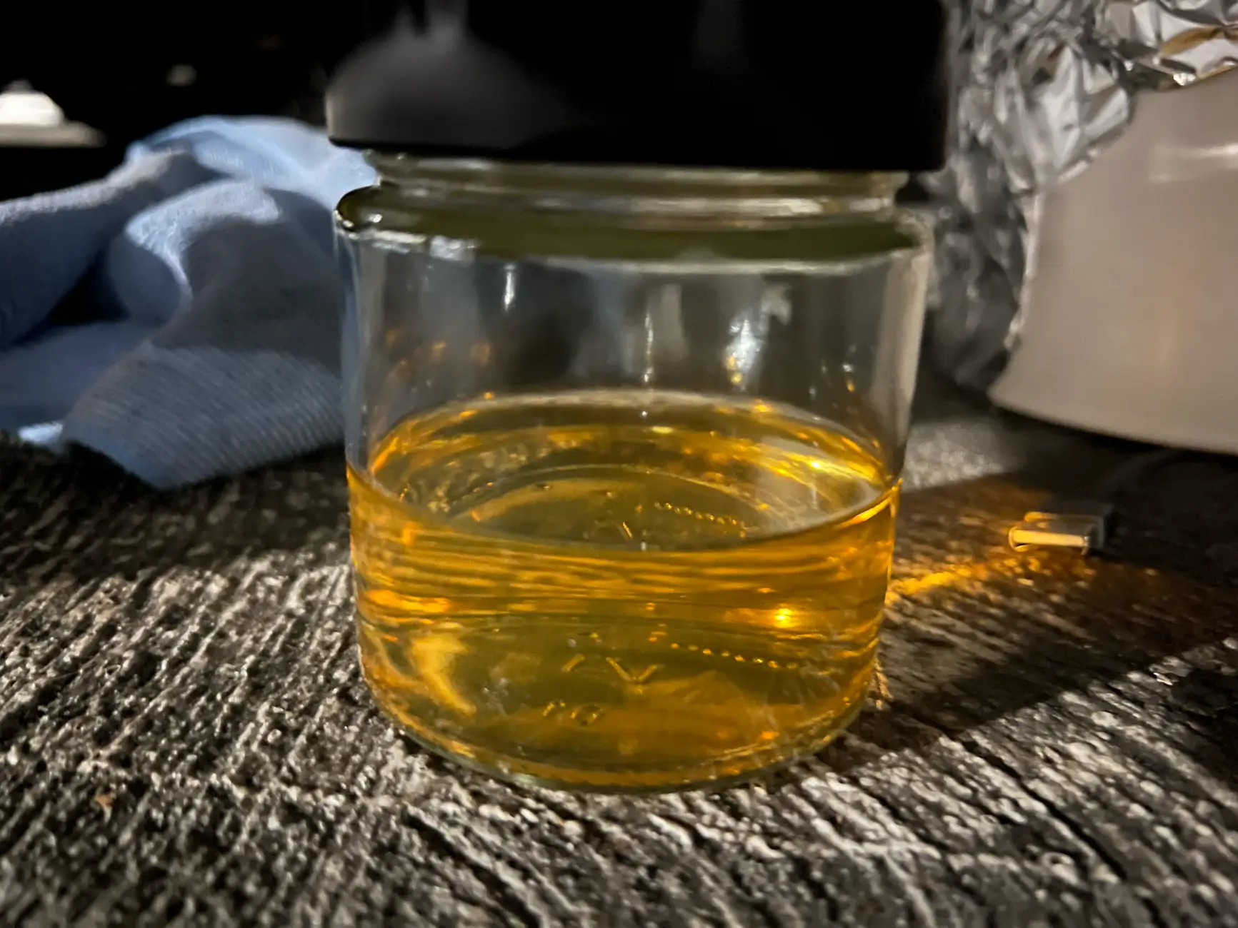

@Zig @AZ_Ryan the coolant used to be kinda greenish/yellowish in the very beginning. The it start to take a more brownish color. Few months back I added more coolant to fill up to the top and I got the yellow one as per manual. Back to my little experiment, the coolant in the jar remains the same, no oil or any particle accumulation in the surface. Here is the pic.

Looks fine to me. Coolant gets darker over time. Stop worrying and drive. 😎
GM does it... they recommend a "tablet" type at coolant change.
