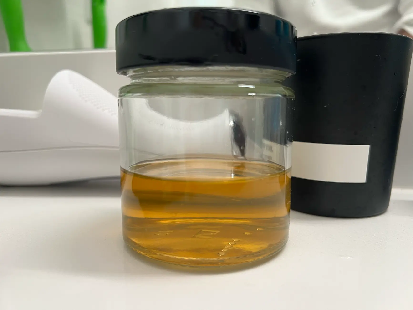

I decided to run a little experiment. Took a small sample of coolant in a glass container (stored in a safe place in a garage). if any oil I would expect to accumulate at the top . I will leave for a day or two and see how ti goes. Here is the sample. Coolant seems to age like wine lol

Your coolant doesn’t look as black as it did in your first pic, and I don’t see any oil sheen. (If anything, oil and water don’t mix.)
Another factor you haven’t mentioned is how many miles on the car.
al that considered, it still looks a little darker than I would like to see in my car.
But I looked at the manual and it stated that fluid discoloration usually means nothing and recommended change interval for coolant is a staggering 200,000 miles!
So based on your more detailed pic of the jar, you might be OK After all.

Based on what you have shown in more detail, and what the manual says, you might be OK. Still surprised the coolant darkened after only 18K miles though.

I had a little pucker seeing those pictures until the jar one. I certainly dont see any oil in the jar. If there was any, it should float to the top in the over flow tank. Maybe just some bad lighting under the hood?
Looks a little dehydrated. Oh wait, sorry, wrong golden fluid.

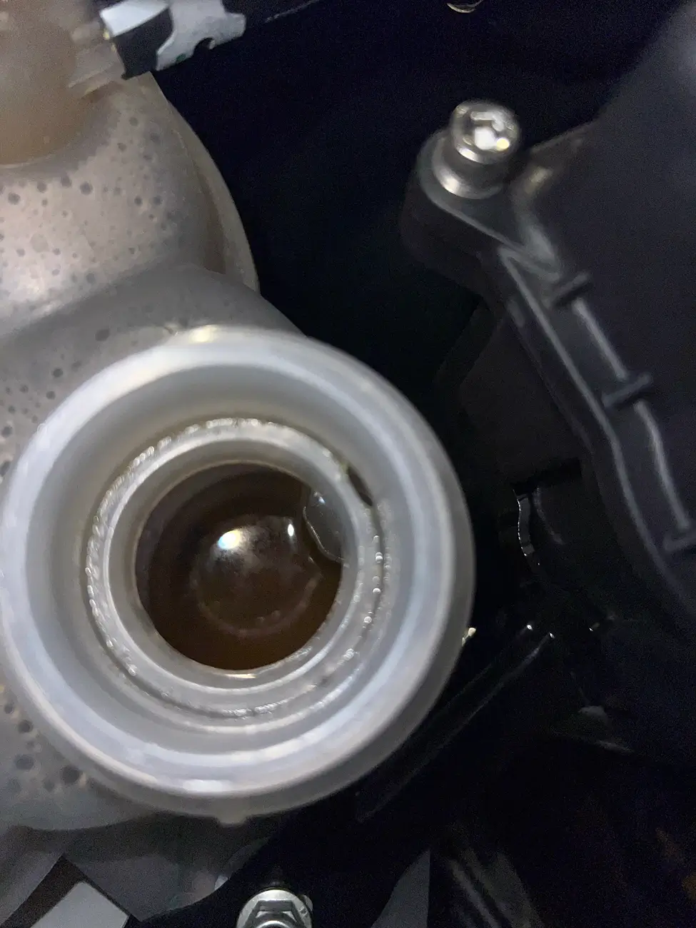

Good question. I t has been like that for a ling time. I just checked the engine oil level and its in the 3 rd x - with in the limits. As for the coolant I opened the cap and I noticed an "oily" surface. It could be actual oil ...definitely taking it to the dealer this week. Here is a pic
Yes definitely get on this to stealership , MustangNoob hope it goes well

I just don’t know if it should be that color at such an early stage. One theory I have is…it might be possible someone added Stop Leak for whatever reason. Just a possibility…but you said you saw it change color. Was it ever bright green at any point???
When I had my Prowler my coolant was brownish, and it was confirmed Chrysler added Bars Stop leak at the factory in Prowlers and I think Vipers….for whatever reason.
