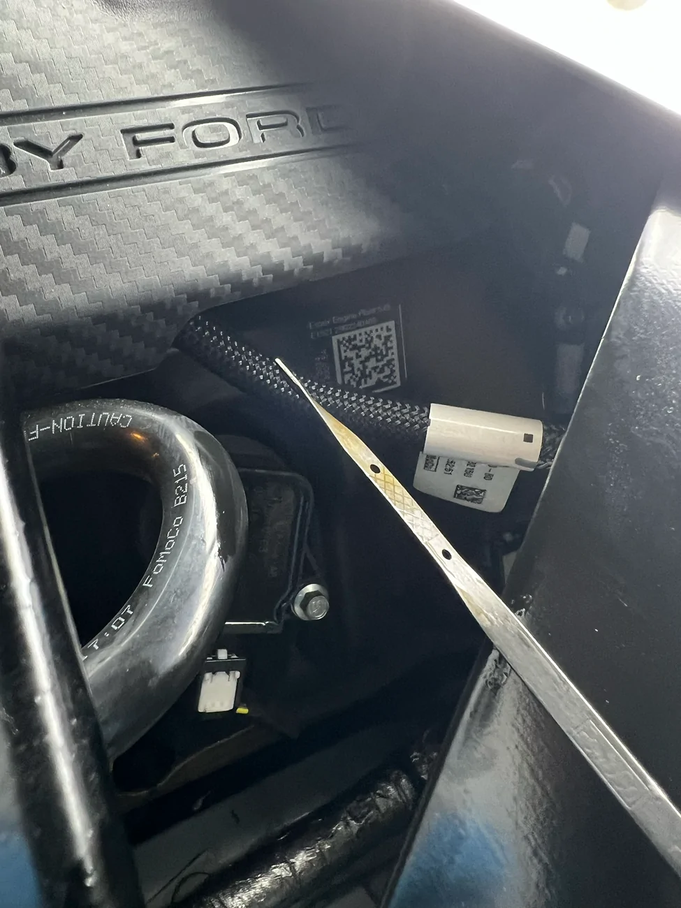

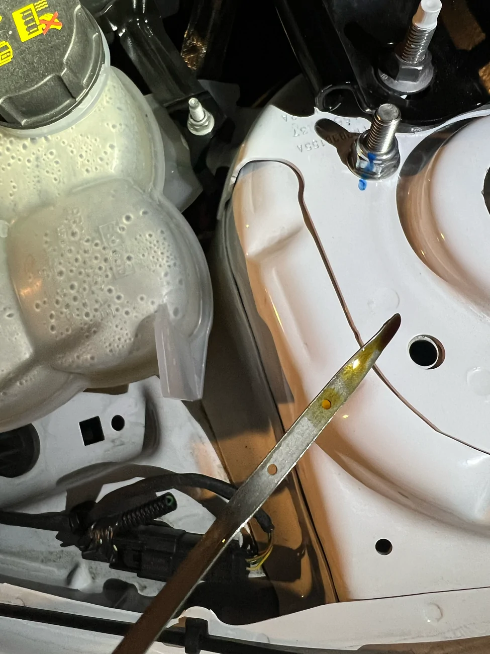

Hi folks,
Sorry for another oil related topic. I would like your feedback.
Back in July I changed my oil at the Ford dealership, motorcraft full synthetic. Today and about 2430 miles after , I noticed the level was almost at the minimum in the dipstick.
Here is the picture (font and back of dipstick) of how the oil level was back in July, measured about 2 weeks after the oil change
S650 Mustang Oil level - Again tempImage55KCpq
S650 Mustang Oil level - Again tempImageHsDXZR

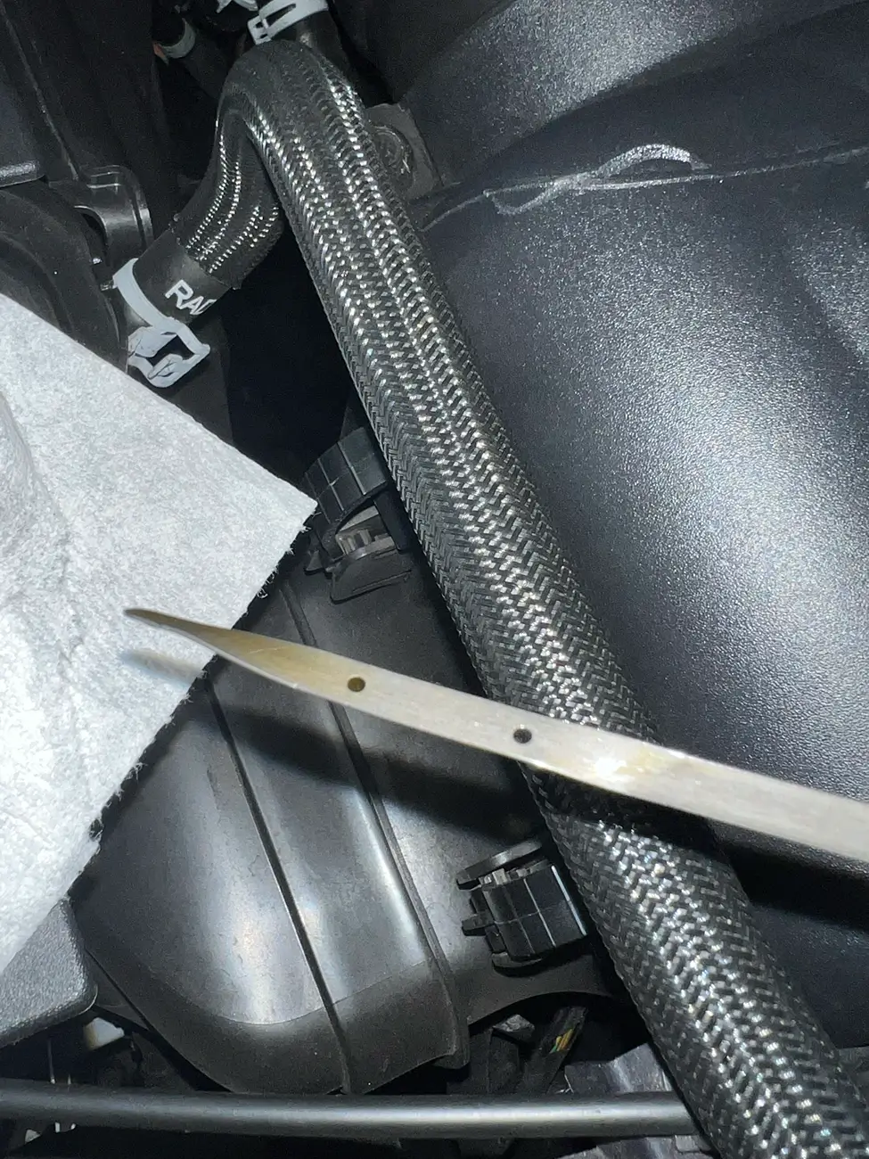

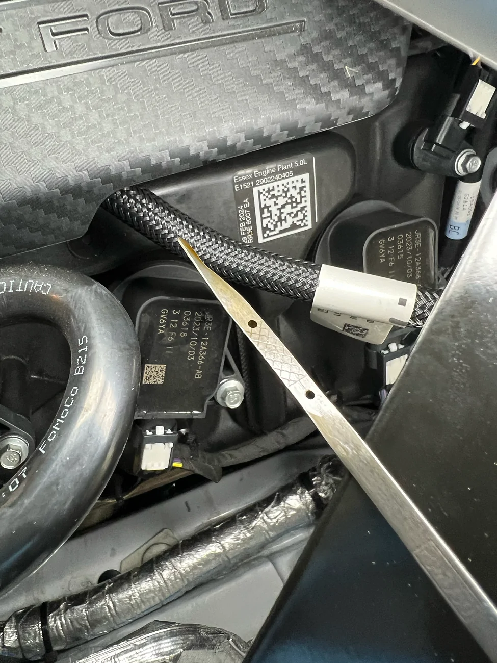

and this is measured today after approximately 2430 miles (lots of spirited driving but nothing crazy). The oil sits within the first x - can't be clearly seen in the photo.
S650 Mustang Oil level - Again tempImage4mfPoK
S650 Mustang Oil level - Again tempImageEulPOG

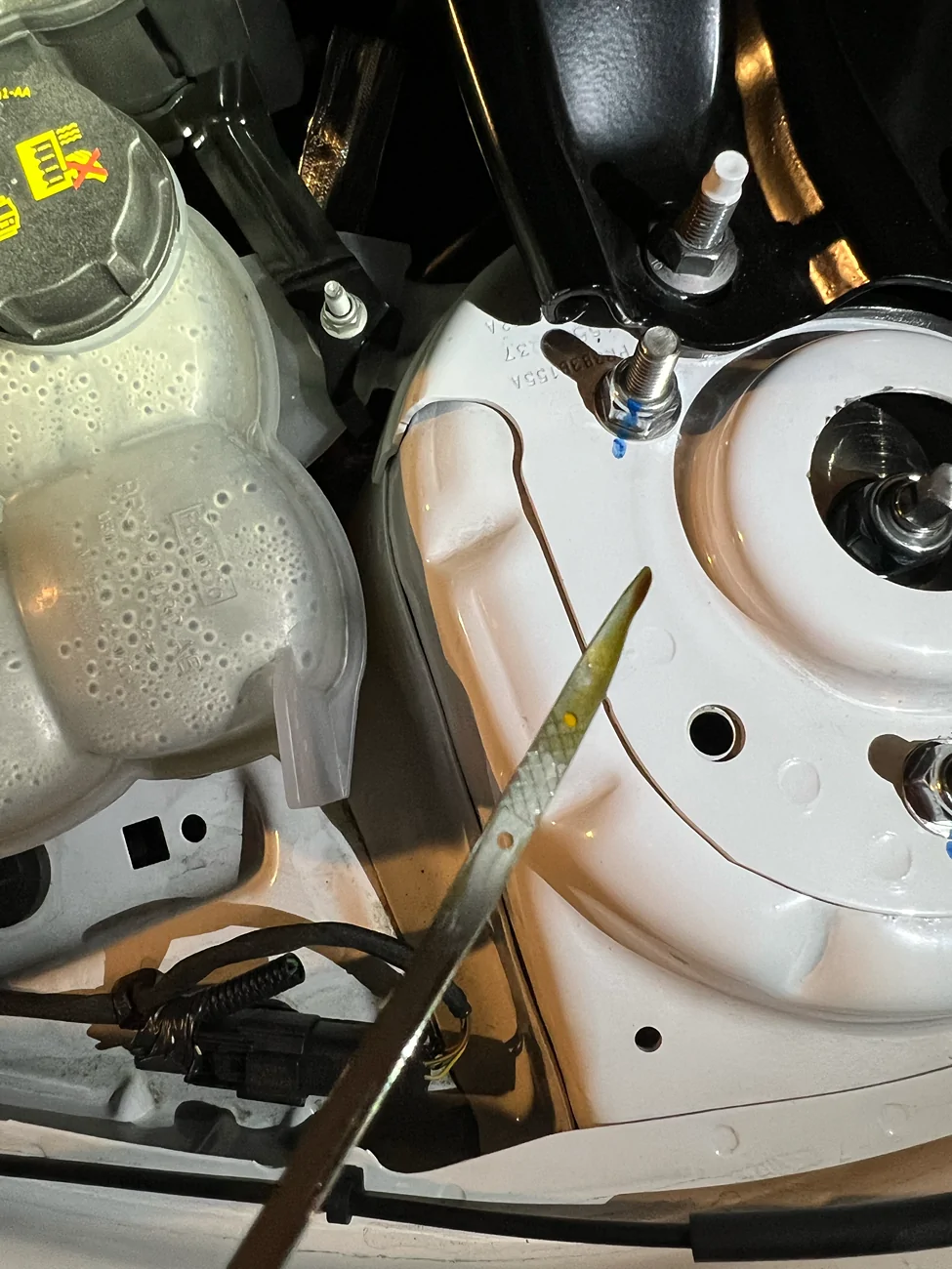

I added about 356 ml ( ~0.365 qt) to bring it somewhere in 4th X.
S650 Mustang Oil level - Again tempImageMFTT1U
Side note, I don't see any oil leak , not temperature changes , no smoke.
If the car gets 10qt, why isn't the oil at the top of the dipstick after the oil change ?
And given the fact the the whole hatched area is 1 Qt, does this mean I was originally down about 0.5q? and would that mean I lost about 0.5q after 2430 miles ? Ford says you should expect to lose about a 1q every 500 miles of spirited, tracking etc ...With the consumption rate I got I loose about 0.1q...So I guess I'm OK ?

If you're interested or concerned about a loss of oil, I'd develop something of a routine. While I do not have a problem, my routine is I check under hood once a month. When the hood is up and the engine is hot, I check the oil level. Same way.* Same place. With a torch, I check any of the containers, engine, bits, under chassis, front-to-back, etc. Takes just a few minutes.
* Oil levels can vary with operating temperature. If you check the oil level hot, five minutes after shutdown, use that as your method, each time.
If you see anything that interests you, write that down or photograph it.
Several have reported less than full mark after an oil change. I cannot explain why yours was less than full. With some of the other comments about dealer oil changes, I'd check it the day you get the oil changed. You can then decide to return to get it topped up, or note the level and press on.
That or a bit more, yes. That's not necessarily a bad thing. That's just your starting reference.
- Keep the oil level in the "X" marks. Anywhere is OK
- If concerned about a loss of oil, attempt to determine the rate of oil loss by sampling more often

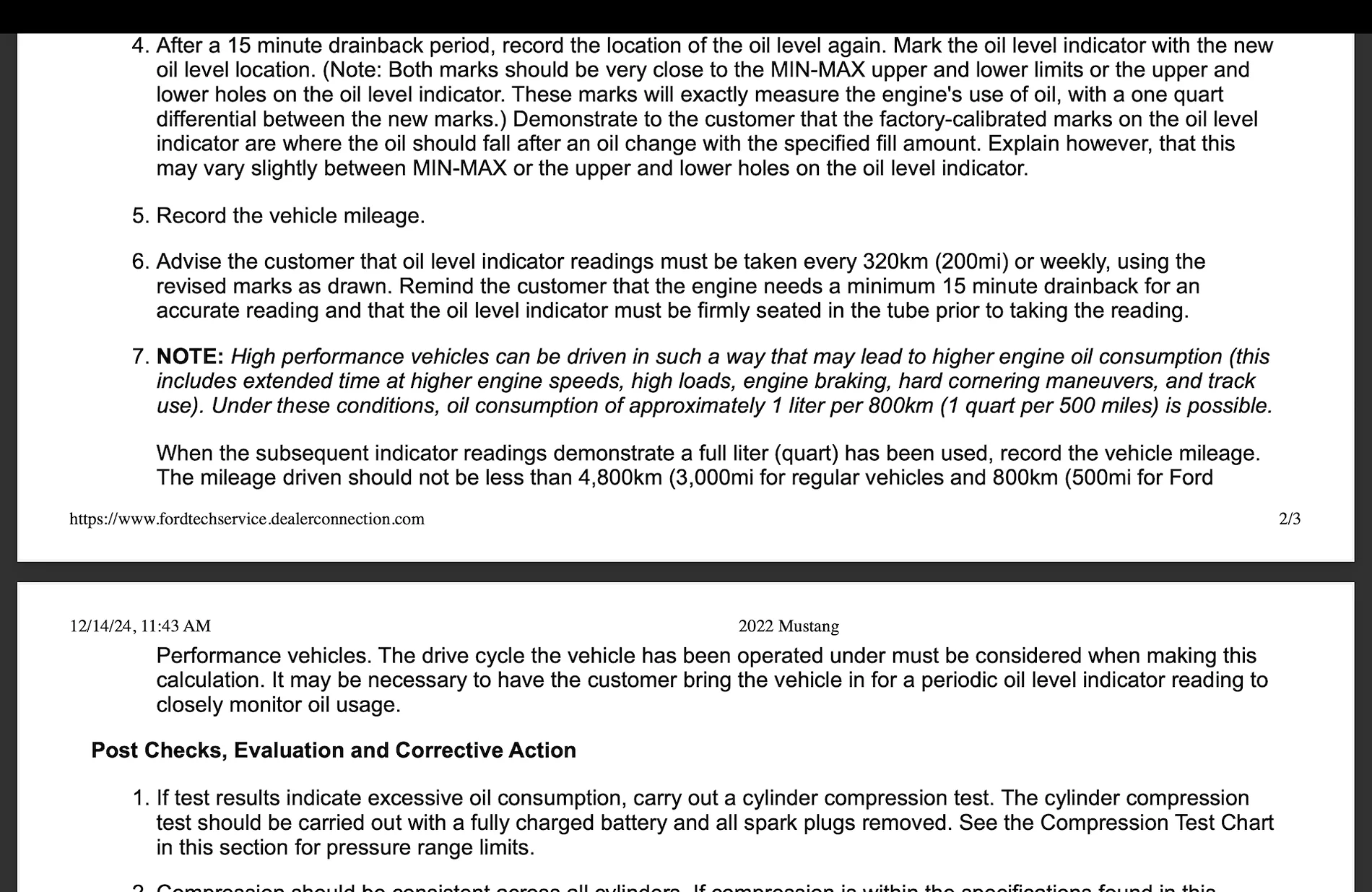

I'm attaching an excerpt from the Ford engine oil consumption test procedure.
For "regular" vehicles in normal conditions, the expectation is the loss will be no more than 1 quart / .9 liter every 3000 mi / 4800 kms. For "performance" vehicles, the expectation is the loss will be no more than 1 quart / .9 liter every 500 mi / 900 kms.
I've always felt there's some left to interpretation. Under normal conditions, normal driving, the loss of one quart of anything in a few hundred to few thousand miles represents a problem. Whatever the vehicle. It needs to be discussed with the dealer.

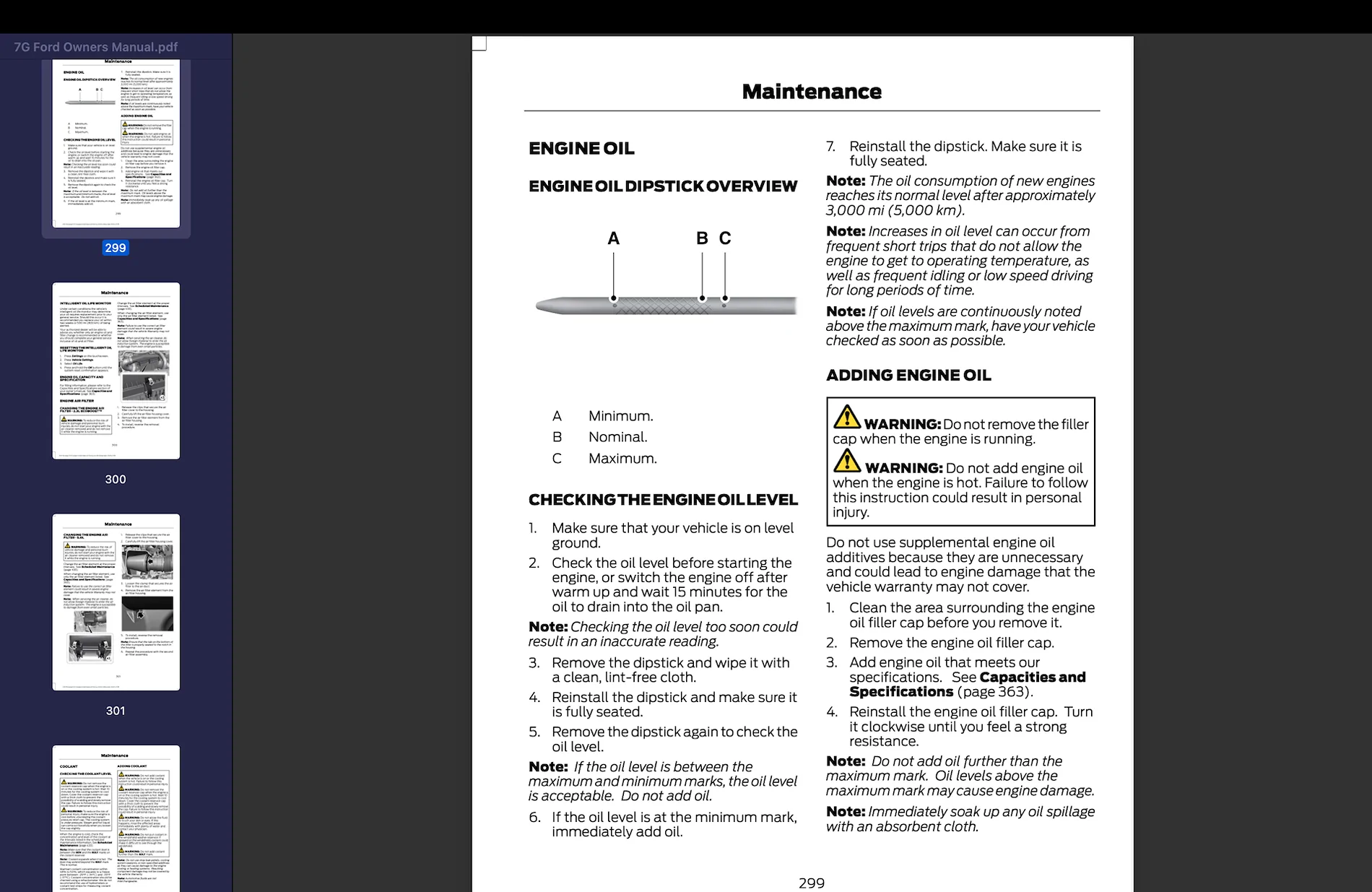

You didn't mention the mileage on the vehicle. How much? I'm attaching an excerpt from the Owners Manual on oil consumption. Another possible concern is an increase in the rate of oil consumption. It reads like you don't have enough data to determine that.
For now, I'd select a reference mark on the dipstick. Top the oil off or start where you are now. Check the oil once or twice a month. Same way. Same place. Begin tracking that. See what you're consistently losing.
It'll probably take a few months to get a trend going. Once the trend is established, you'll have a better idea what to do, or can bring that back for more discussion here.

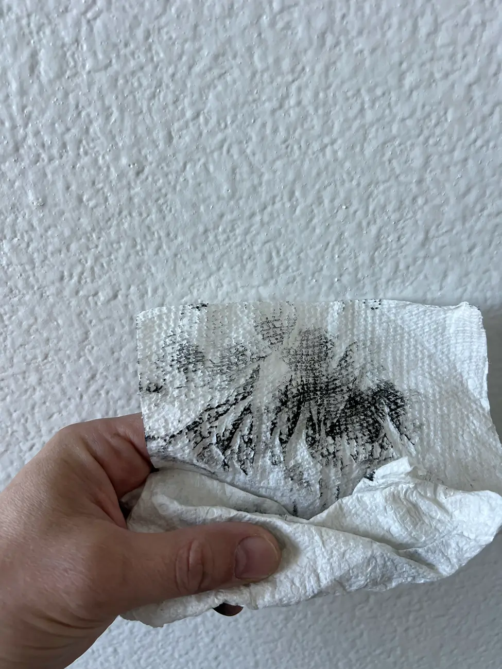

It's 9.5 QTS the 2024 manual is wrong. Check for black soot in your tail pipes. My engine was replaced by Ford for oil consumption after 6800 miles, I was losing 1 QT every 750 miles. Oil was found leaking from the engine into the right passengers side manifold when it was removed. Engine had an internal oil leak.
That's crazy. Haven't seen any black shoot from the tail pipe but this is what I see when I rub the interior of both pipes. looks normal since these cars run towards the rich side ?

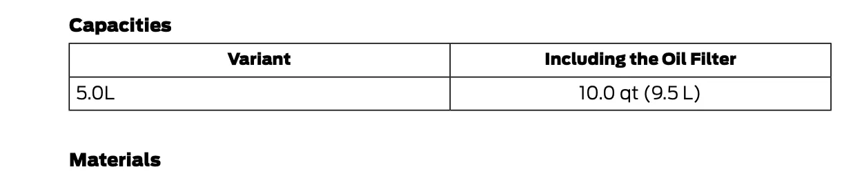

With regards to oil capacity how come the manual for the 24 year says 10Q? IS the a typo?

I'd continue driving as you have. Check the oil level regularly and in a consistent manner. Even though you haven't noticed any thing thus far, continue to do simple reviews for leaks, under hood and under car.
As to the oil level and the specification, my car is a bit like many here: the manual say 10 qt at an oil change, so I put that much in. The dipstick always registers as much as one "X" below full. Reading the dipstick can be a pain. As long as the oil is in the "X"s, your fine. If your standard is full, it's full. Top it up, but don't overfill. If your standard is somewhere else in the normal range, that's just as good..
As to the soot in the tailpipe, it depends. Tells like that can give weight to other readings, ones that are quantitative. The oil level readings over time and mileage will give you that. Vehicles do emit carbon. Some soot and buildup is to be expected. P21S polishing soap is great at keeping stainless exhaust tips clean and shiny.
Mine started like that and it only got worse. Mine got so bad that even after ever drive it would look like that. Keep an eye on it and take pic for Ford. Save the towels and let Ford know if your concerned.
The 2024 manual is a typo. Check your VIN the the parts dept at Ford and they will tell you it's 9.5.
