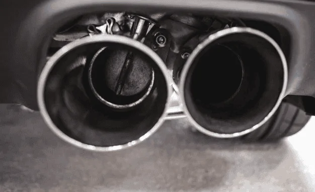

I will be the first to admit that I'm not 100% sure how an active valve exhaust works. I do know that typically the first mod I've always done on prior year mustangs was swap out the exhaust for something a little more aggressive. On my S550 I had the MBRP exhaust and absolutely loved it. I'm curious how these active valve exhaust work where does the actual valve sit in relation to the exhaust system is it possible to still swap out the exhaust system and retain the active valve features?

its a butterfly valve system, one of the two pipes has a butterfly valve in it, while the other is open at all times, as you flip through the modes the butterfly valve opens more and more. the valve itself sits right at the back of the muffler, before the tips.

So it sounds like you wouldn't do any kind of aftermarket exhaust with active valve because that would defeat the purpose of having active valve...

For the S550s there are multiple axelbacks that do retain the active valve functionality.
You transfer over the actuators

If you have been watching any of content on the C8 Corvette. They too have optional active valve exhaust. What the aftermarket fabricators are doing is adding the active valve into their products and it will be plug and play. They will remove your exhaust then plug in the new ones to your current software and wiring. It all works the same for your cars electronic settings with the cars stock wiring. Pretty simple.
Or as Mazman said above you will transfer over the stock actuators.
