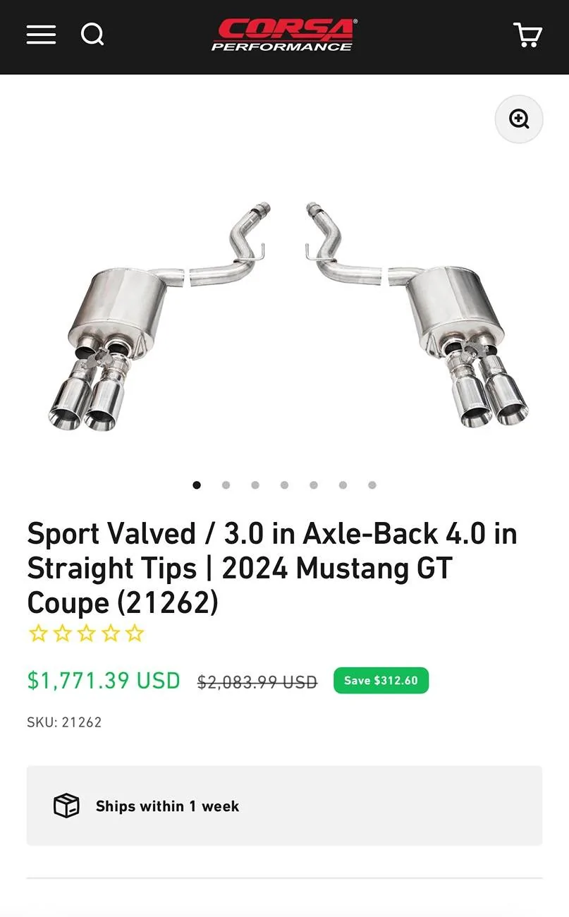

I got MBRP catback exhaust system that designed to replace the stock system directly, so no welding was needed. I believe products from Corsa or Borla can also be installed by tightening clamps. I strongly recommend getting a drone-free exhaust system like Corsa or Borla, even if it costs more. The MBRP system gave me unbearable drone, which caused me headaches lol

@TcarterGT2024 ..... which Corsa system did you buy? I really like Corsa, I installed a number of Corsa switchable exhausts for go-fasts. They called the system captain's call.
