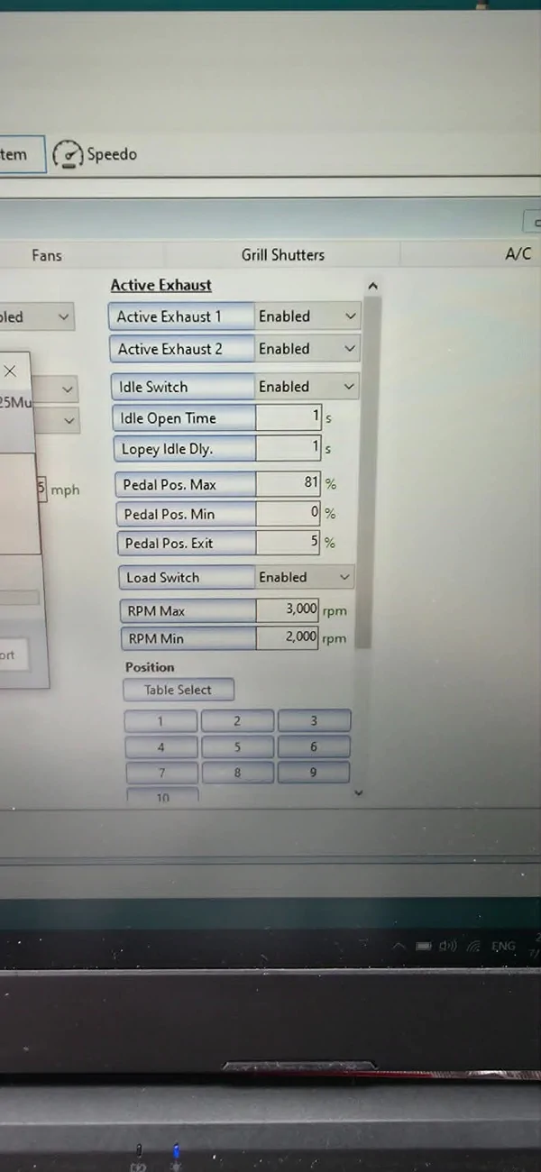

Then, ECU/PCM needs to be updated to enable AE install tune. Once in vcm suite, simply enable Active exhaust and other functions, or your tuner can do this. Takes seconds to do, and no need to change anything else on stock tune.

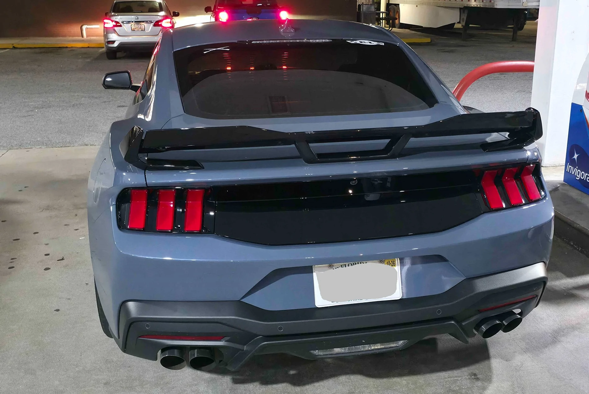

my inspiration for this was, I wanted quad tip exhaust. Single tip looks weird imo. Picked up two active exhaust mufflers for 150, and I got to thinking from there.

Nice, congrats on accomplishing this. I think you're the first to successfully do this and detail the steps. A TON more work, parts, and effort than I expected, even requires a tune
Thank you, I got some mufflers, since it ended up being cheapest way to get quad tips on my car, and turned into me looking to see if anyone did, only partial info out there and people debating it.
Wasnt sure it would work until I got the mpvi4 and took a look in the tune, which turned out easy to do, as shown in picture, you are just changing a few things from disabled to enabled in the tune, so not exactly as involved as say e85 tuning the car.
