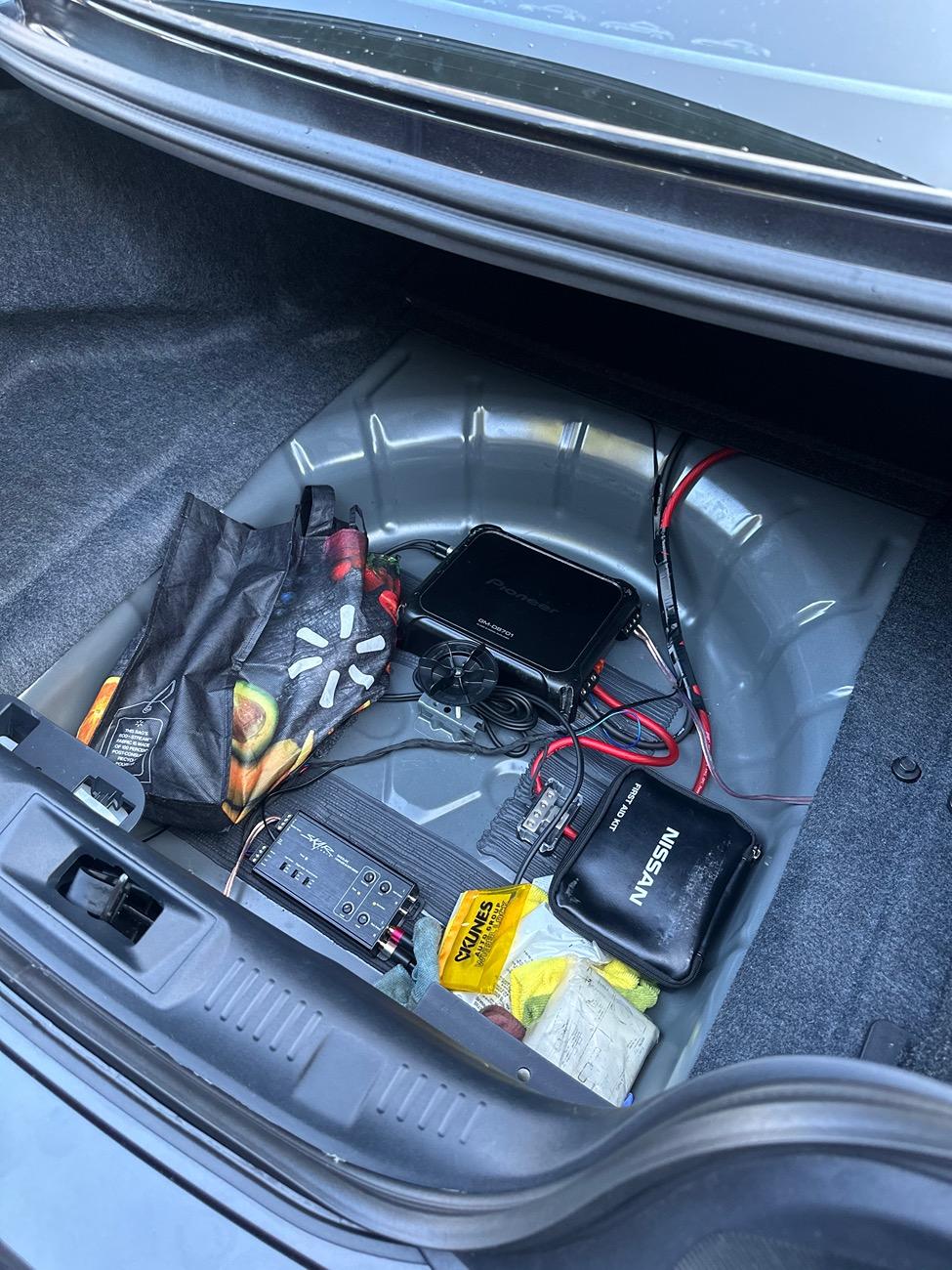

I wrapped my box in carpet & wired it to an AMP. Difference is night & day. Going to do a 4 channel & bypass my B&O System soon

Just did a mono 1600W Pioneer Amp. Going to add a Taramps 400W Amp next
Where did you grab your input signal for the LOC from
Did you use the rear speakers, or take it from the factory sub output

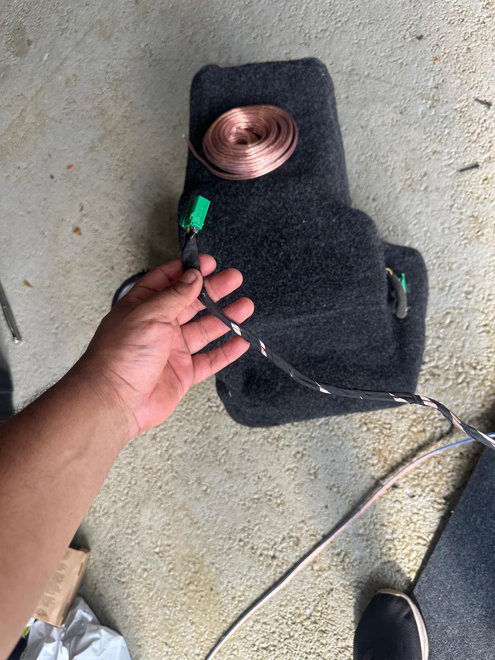

Signal from rear sub wiring (only need one set from the dual voice coil) into the active LOC with bass roll off correction
I got the OEM wiring diagram so I was able to then wire the OEM connector plug out of the amp output back into the sub (plug and play)

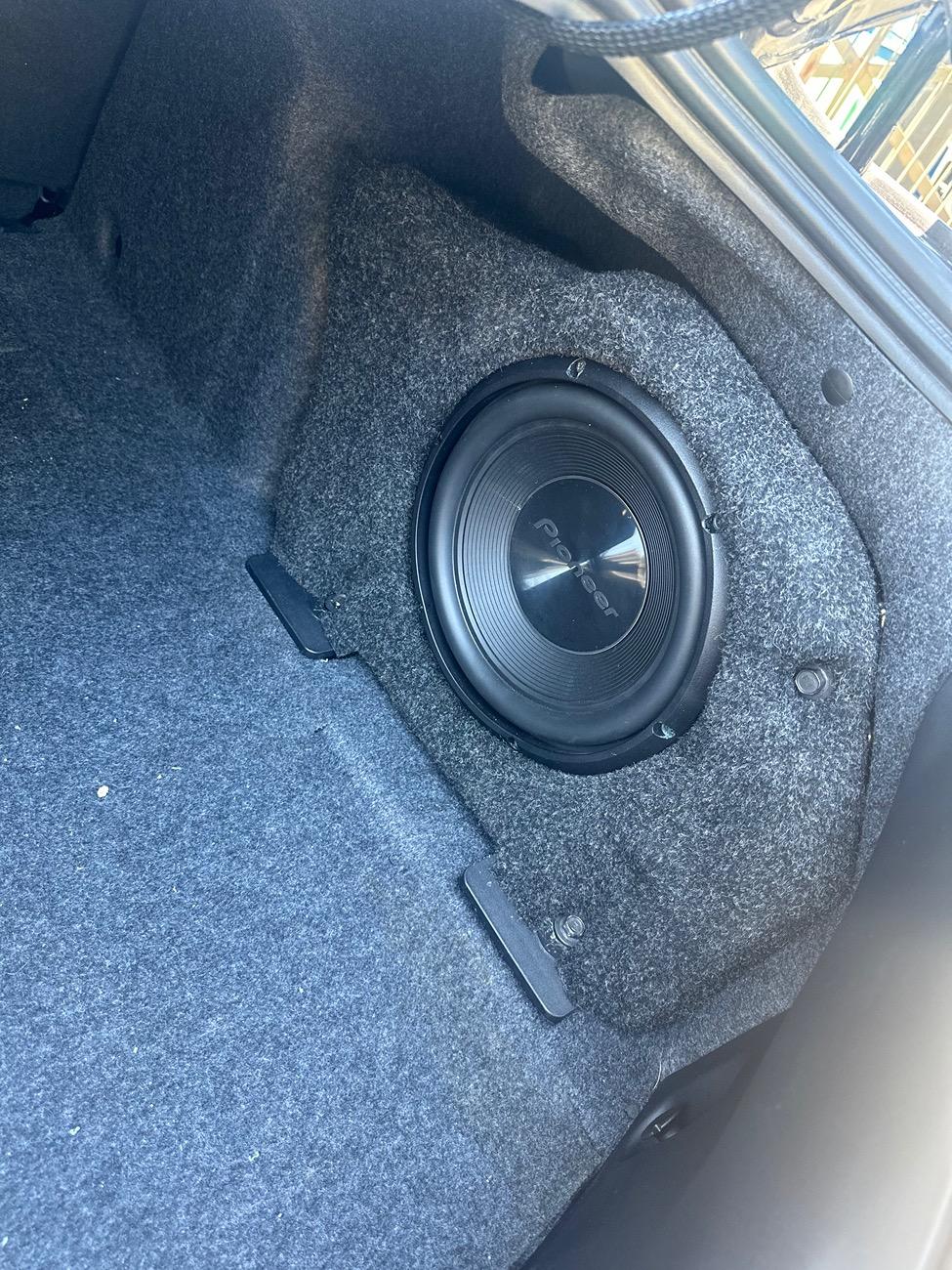

I just did the pioneer upgrade. Its all connected and the speaker works. I hear the bass when i open the trunk and hear it from there. In the car no. The fromt door speakers still give 10x more bass. I test the sub by putting all sound to the back on the fader. I guess i should expedt to hear bass? Lol.
for instance when i move the fader to the middle its wayyyyyy more bass. I know the fromt speakers are right there. But they overwhelm the sub. Its supposed to be like this?

Yeah, it kinda is, the stereo favors the front stage heavily
you’ll probably need to add an amp an LC2I IIRC

Thanks. Ill look into getting the back ones replaced with amp for then and the sub. Infeel like the sound is isolated still but it is overall. Better with the replacement sub

Once you install an AMP you’ll notice too much bass & not enough highs lol
