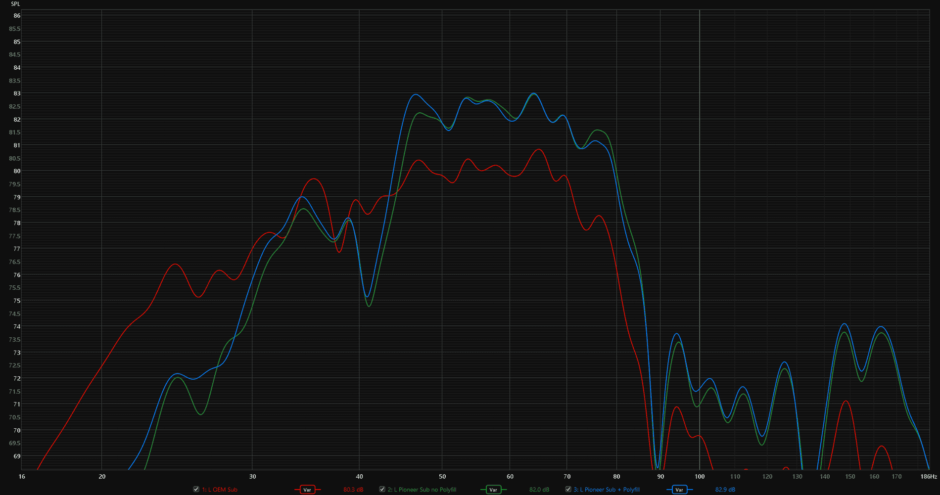

I got the Pioneer sub installed last night and took a few more measurements. From a data perspective the Pioneer sub definitely it a bit louder especially in the 40-80Hz range. You can also see from the graph that the Polyfill made little difference at least in my test. I am not sure the human ear to actually notice the difference with and without the polyfill.
S650 Mustang $79 Subwoofer Upgrade (Pioneer TS-A250D4 10" Sub) - IT SOUNDS GREAT! Results
I still want to do some more testing. I guess there is an optimal amount of polyfill to add depending on the cubic volume of the box.
It was also interesting to see that it appears the Pioneer sub wasn't as loud in the 15-30Hz range
I'm surprised to see the OEM unit have a higher output below 30hz or so. If I would have guessed just by listening that it would have dropped off much higher in frequency as to my ears it sounds "thumpy". Thanks for testing.
Power is nothing without control as the saying goes. The Pioneer has much more control over the cone which means far tighter musical bass rather than just a flabby booming noise. Bass has more than one note to it!
