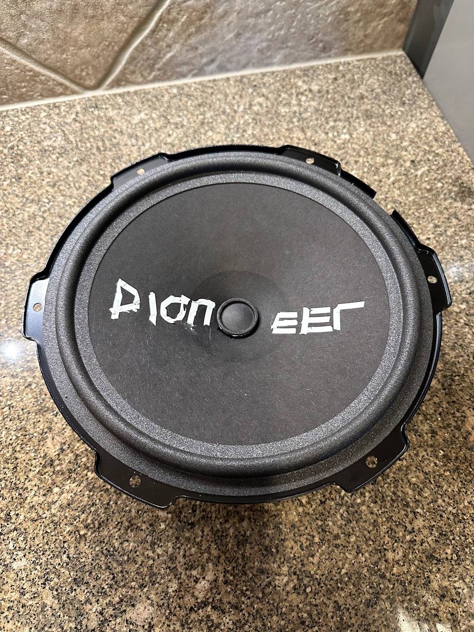

I just did the pioneer upgrade. Its all connected and the speaker works. I hear the bass when i open the trunk and hear it from there. In the car no. The fromt door speakers still give 10x more bass. I test the sub by putting all sound to the back on the fader. I guess i should expedt to hear bass? Lol.
for instance when i move the fader to the middle its wayyyyyy more bass. I know the fromt speakers are right there. But they overwhelm the sub. Its supposed to be like this?

even I did the cuts with metal snips. I never did anyting like that, it was really easy. If I can do it, you really can :-D .. really. And the plugs same thing. they connect right to the corresponding conectors from the speaker box. You just cut the other ends, strip and push in the easy push botton release holes in the speaker. Only tricky part was taking off the retaiing ring. I used a heat gun , not sure if it did anything to salvage anything like the ring iteslf, and a flat head screw driver. And to realize the srews go in AFTER you put the cover screen back on the speaker, not on the speaker itself Like I did.. and that you need a torx 20 screw diver fyi.

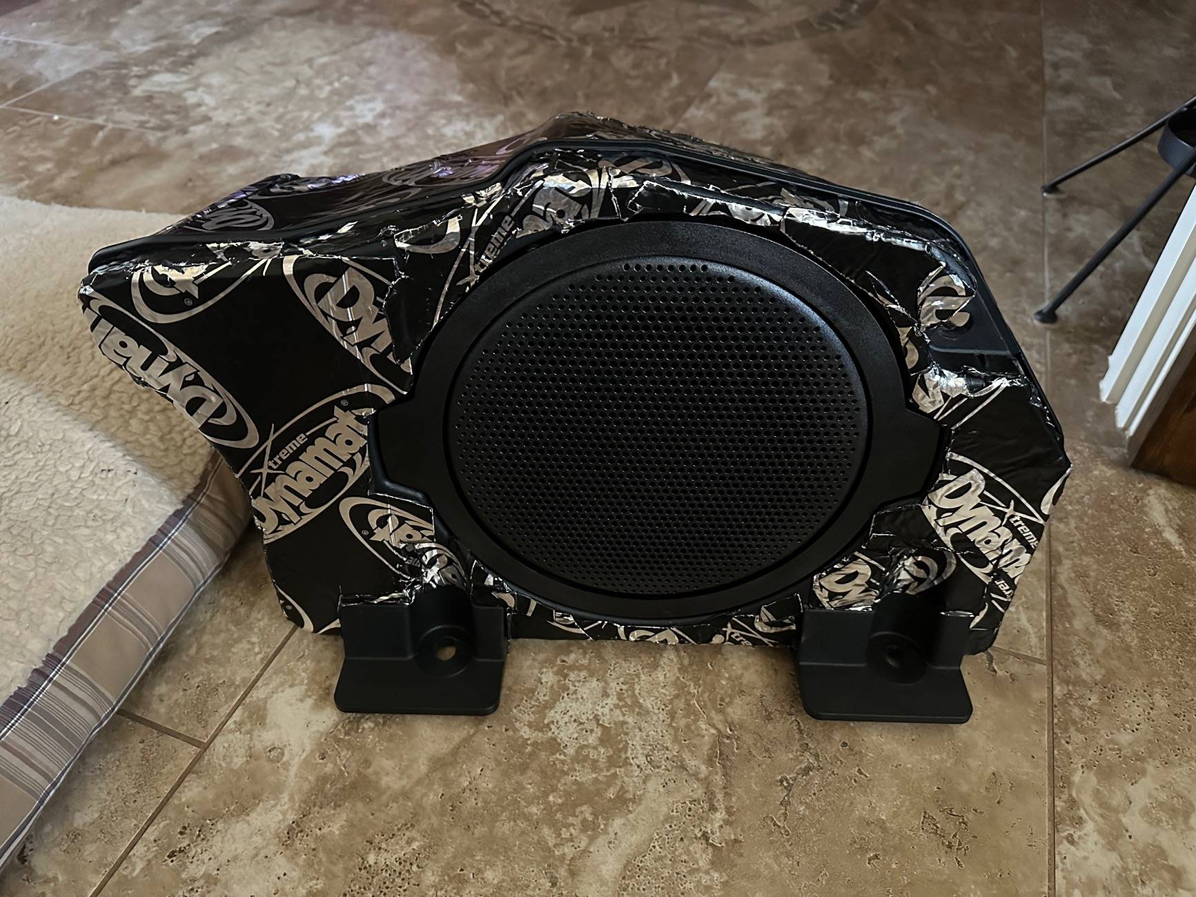

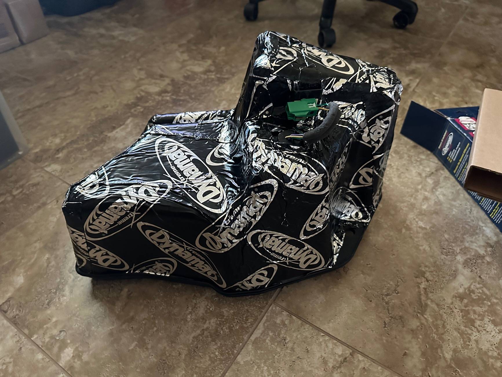

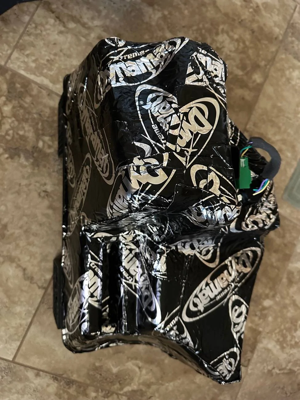

Alright, this is every scrap of dynamat I had on hand. I think Ihave about 98% coverage

So, I swapped the DD/Redline 10” into the dynamat wrapped enclosure.
I first tried with stock sub in the wrapped enclosure. No discernible change.
Redline sub: Meh.
Is it better? yes. Is it a LOT better? No.
I’ll Amp it and be done with the affair at some point ( SHYeah. I’ll upgrade the stereo piece by piece until I have it measurably better, who am trying to kid )
