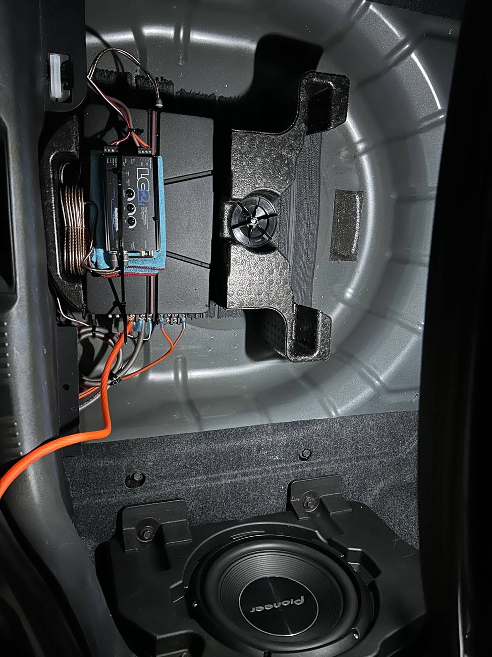

I liked your write up and idea, I went a slightly different route with amp and made use of that otherwise worthless tire inflator. Cut the foam and put a 1,000 watt Pioneer Amp and the LC2i in it. Makes all the difference with the Pioneer subwoofer swap if you are looking for some punchier bass. Have to run power wire tomorrow but was proud of my idea and thought I’d share.

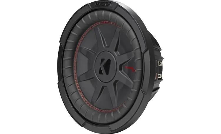

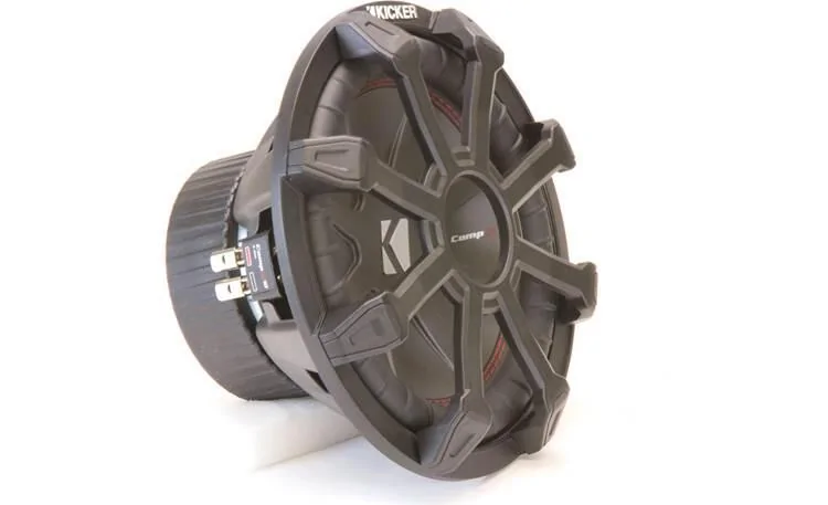

I ended getting a slightly higher end Subwoofer that's around $160. Gonna get it installed this weekend. I'm also getting the grille for it for added protection.
Kicker 48CWRT104
CompRT Series shallow-mount 10" subwoofer with dual 4-ohm voice coils

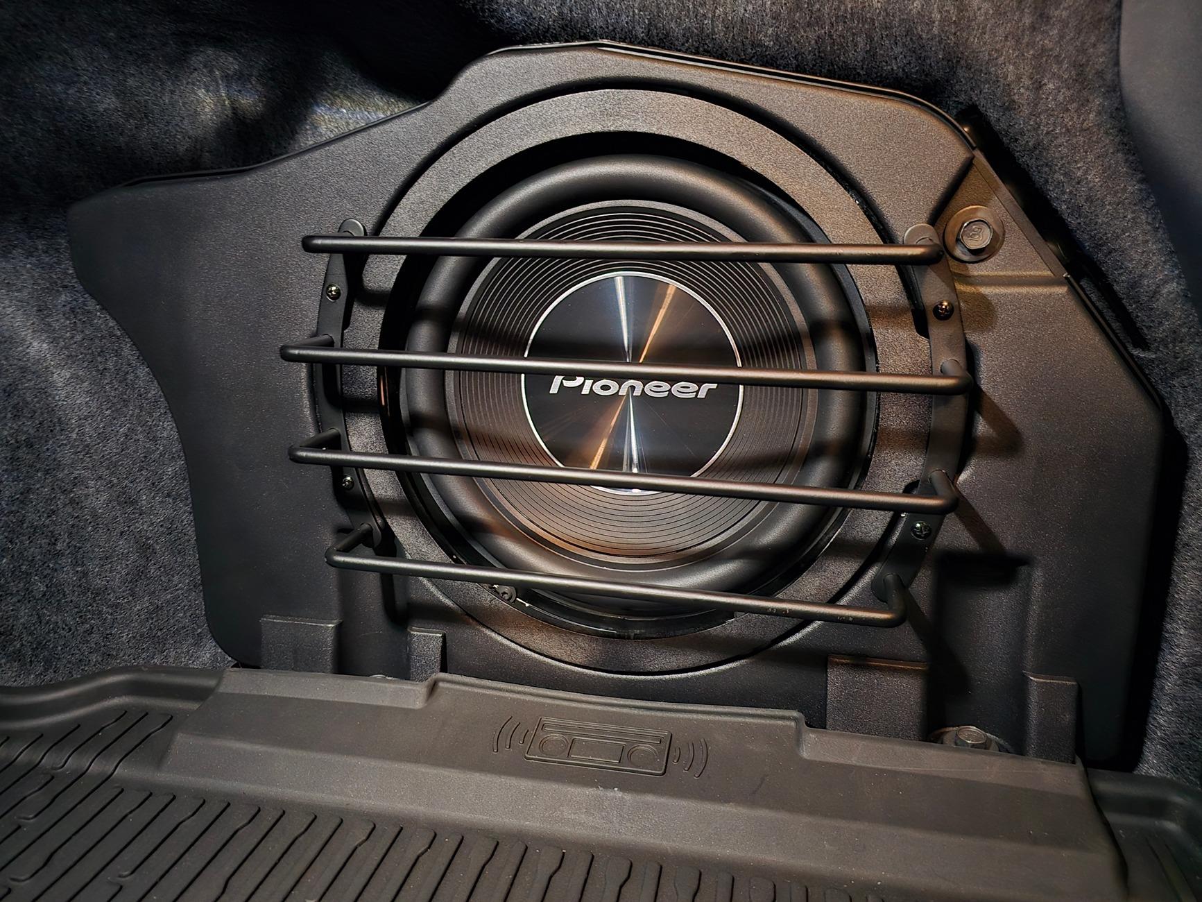

I installed the Pioneer sub with grill bar. No matter what sub you install do not expect a lot, unless adding an amp. You will not get any more noticable thump just replacing the sub.
BUT…..this is what happened. By JUST replacing the subwoofer, all the other speakers sounded better and the door woofers had more thump. I was confused, and someone on another thread pointed out the stock sub puts out a terrible resonance that counters what the other speakers put out. I can’t verify that, but damn, if it doesn’t sound like a reasonable enough explanation to me.
The complete stereo system, especially set on Surround, sounds clearer, less muddy, and the side woofers have much more presence.
so when just replacing the sub, don’t expect a huge difference in that one speaker, but expect the entire system to sound better overall.
