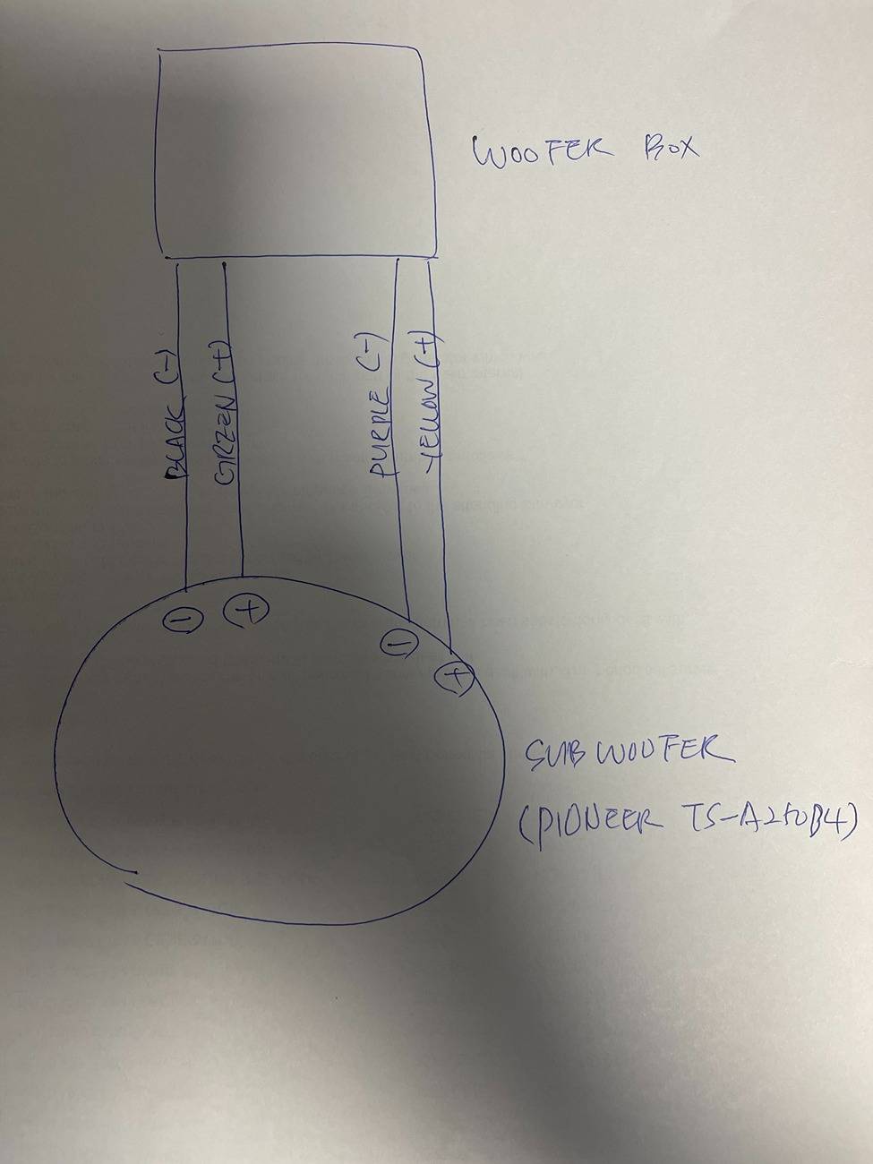

Below diagram is my current wiring.
S650 Mustang $79 Subwoofer Upgrade (Pioneer TS-A250D4 10" Sub) - IT SOUNDS GREAT! KakaoTalk_20250302_094519669
Is it correct? or please let me know correct one.

That may give it a 2 ohm load and may blow amp. I wired 3 JL 10W6 with 6 ohm voice coils to make a 4 ohm load to a bridged 1000 watt amp. I would consult someone at a car stereo. What you want is a 4 ohm load. Your present speaker, I believe, may be 4 ohm each voice coil.

As I told, I wanna know that only wiring between 2 connectors of subwoofer and OEM wire.
If OEM wiring(each pair line to each pair connector) can be applied to new subwoofer, TS-A250D4, my audio system is malfucion.
Below diagram is my current one.
But if OEM wiring can not be applied to new subwoofer, I have to know new wiring method.
(I could not find the case of 2 pair lines to 2 pair connecors, only the case of 1 pair line to 2 pair connectors was found.)
If you know, new wiring method, please help me.

The OEM must've had a dual voice coil set up to begin with, and requires two positives and two negatives. I've as always used bridged amplifiers using a positive from one channel and negative from the other making a mono signal. Usually to one speaker. The 3 dual VCs I wired up were as if they were one single speaker. Was nearly 20 years ago. My windshield developed a single crack that grew across it. But what you have is very handy. It'll add warmth to the music, unless you get bitten by the "Bug". I hope the speaker has good output than the original.
