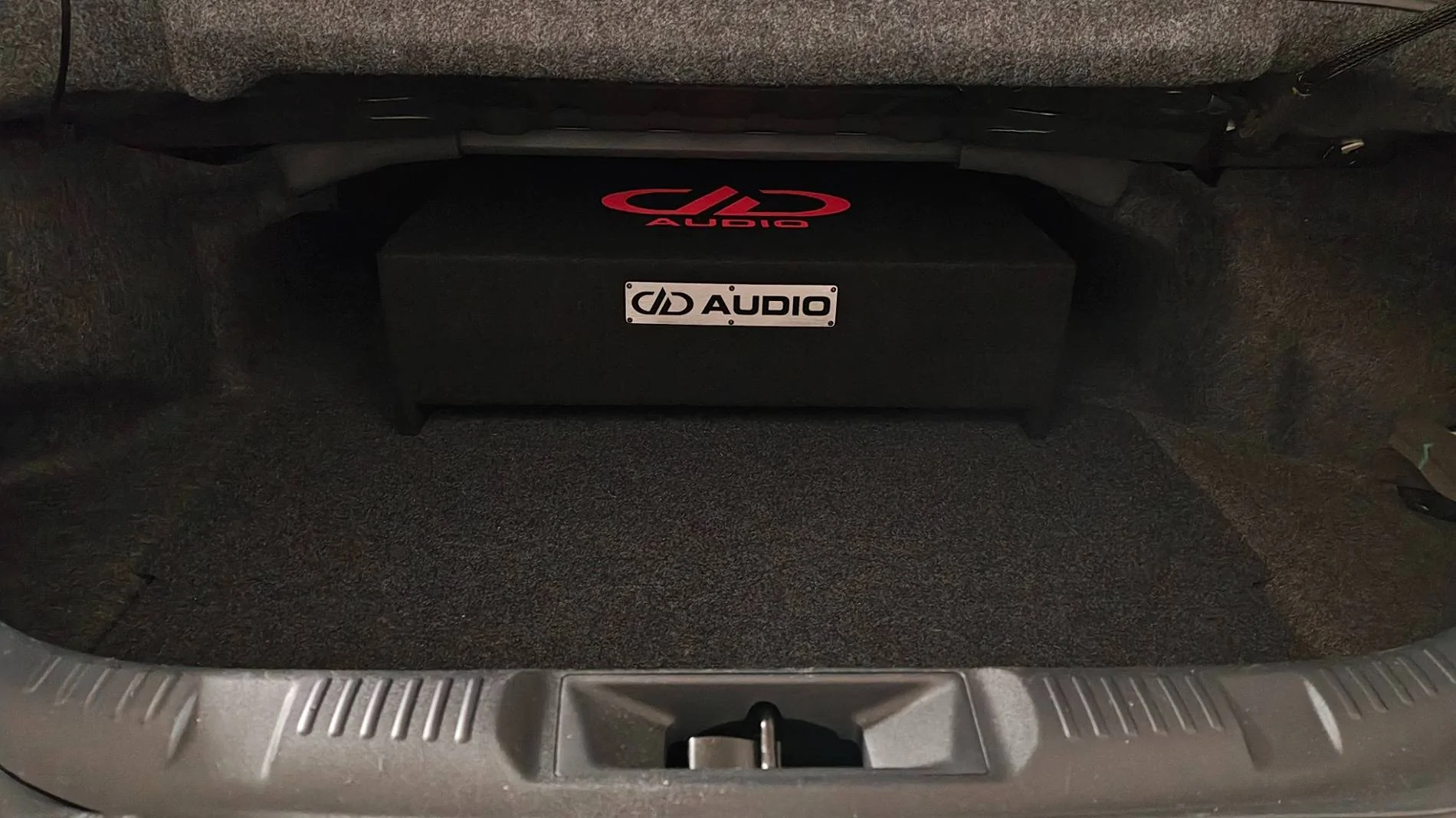

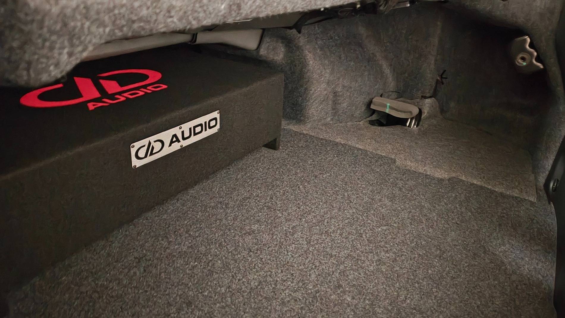

I'm curious. Question for those who upgraded their subwoofer: those that upgraded but used a separate enclosure, how many installed a 10" or 12" (with an amplifier of course)?
Fruitstang
Jan 7, 2018
325
230
2024 Mustang GT Convertible
DD-Audio 12" with 8-Channel DSP Amp Match Up 8dsp in convertible:

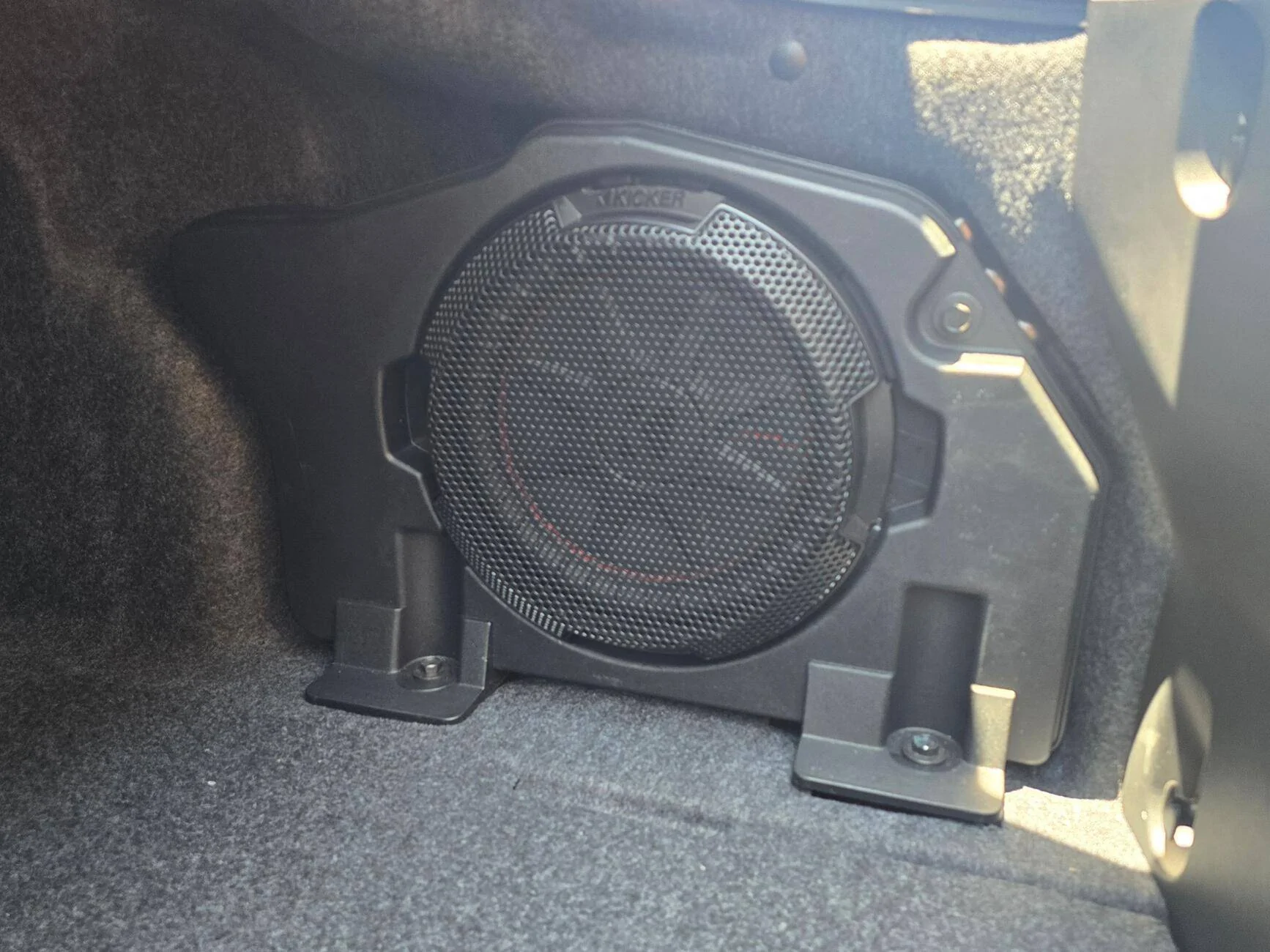

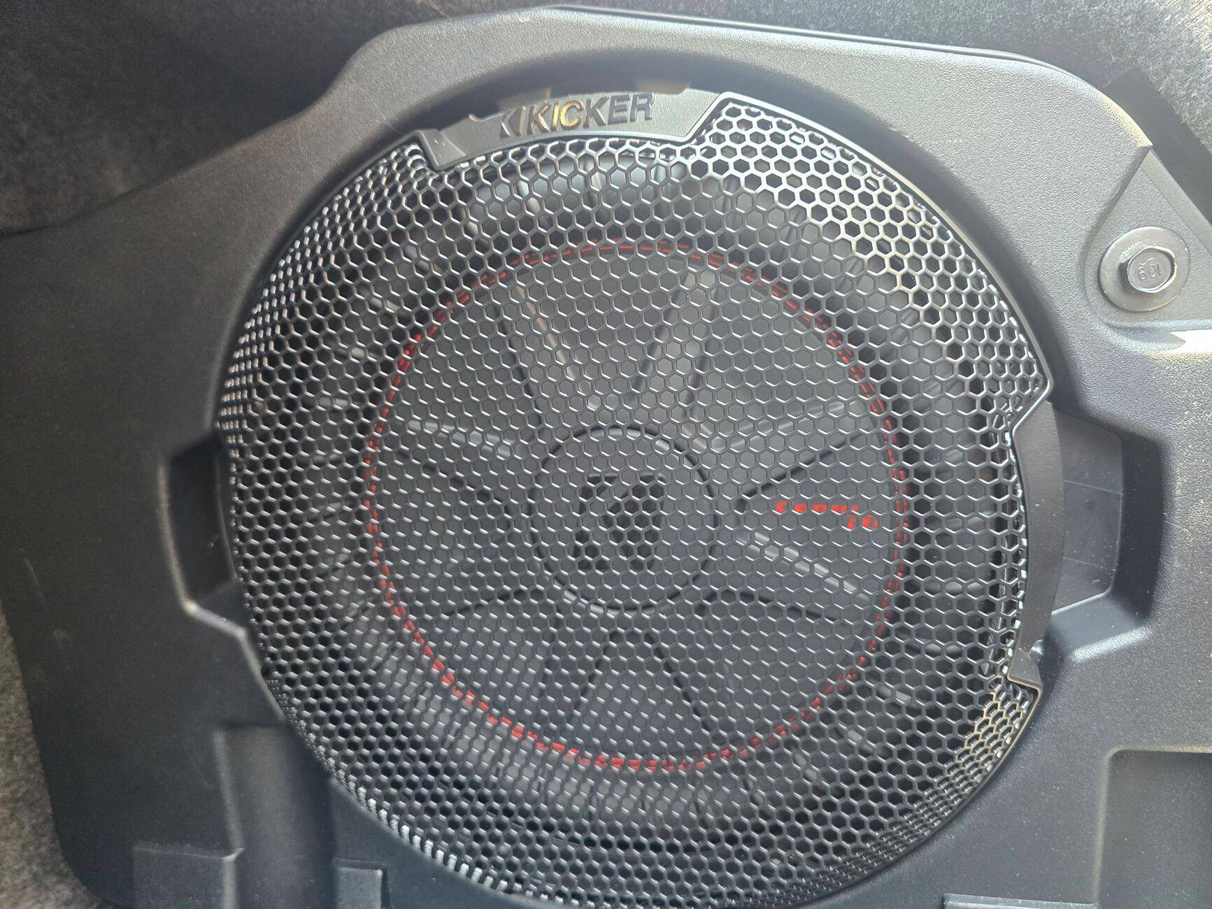

Went to my local car audio spot and got a new subwoofer upgrade. I definitely already feel the difference in quality compared to the stock. I'm very happy with the outcome. I did end up going with a more expensive option in case I want to expand the current system further.
How much modification did you have to do?

I didn't do much myself since a shop did for me but all they ordered was the speaker and front case grill. They reused the same sub case and all.
You know where they order the Front Case Grill?
