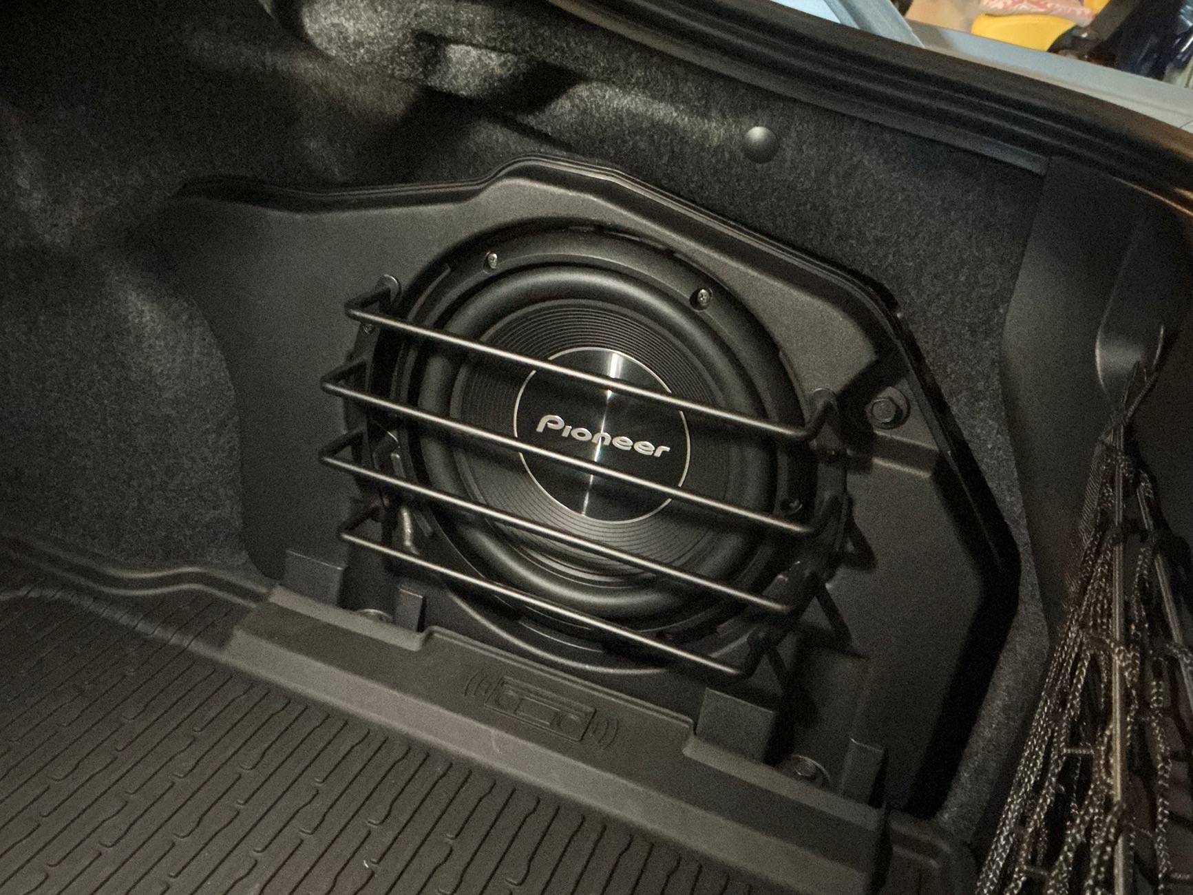

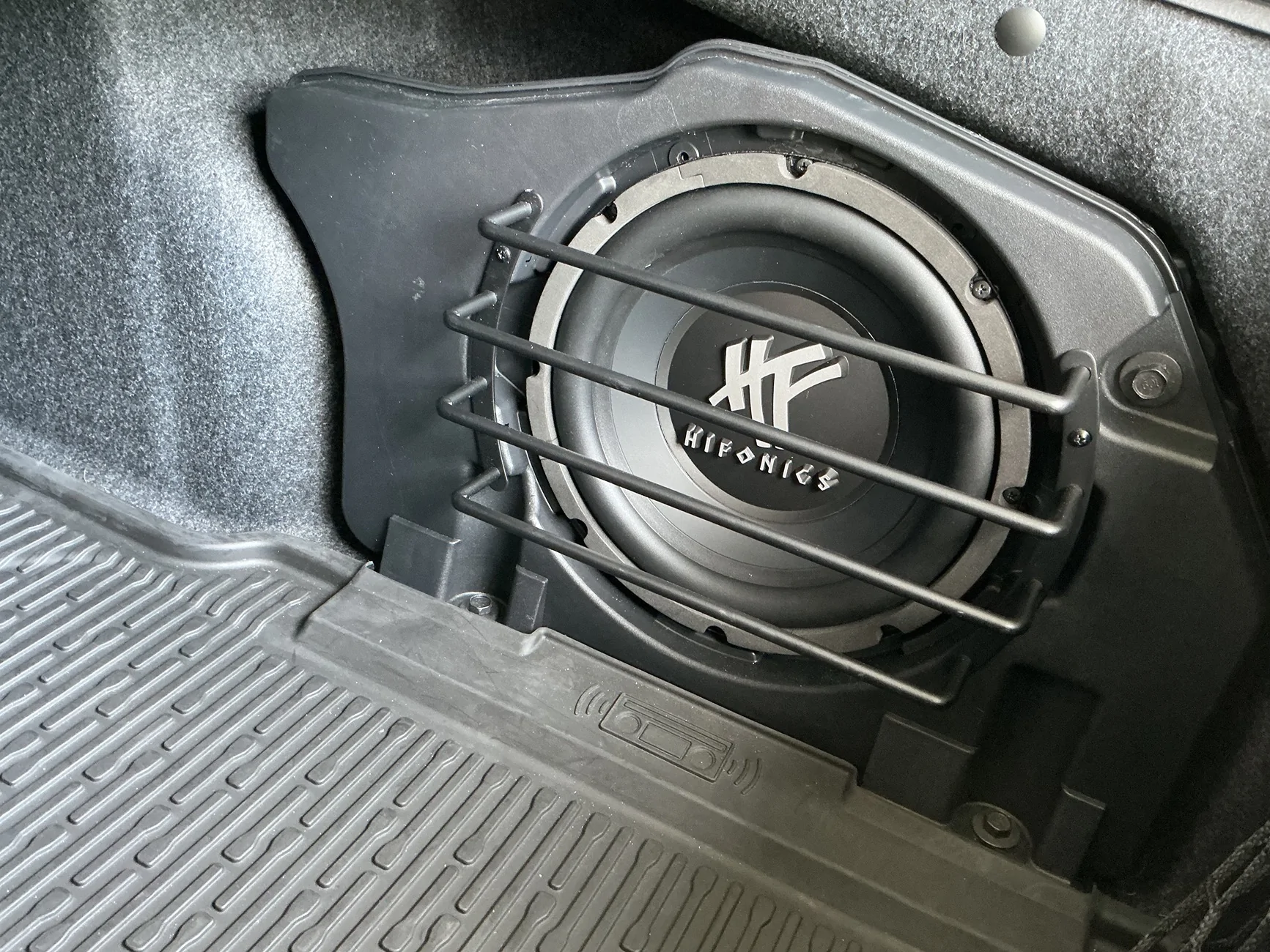

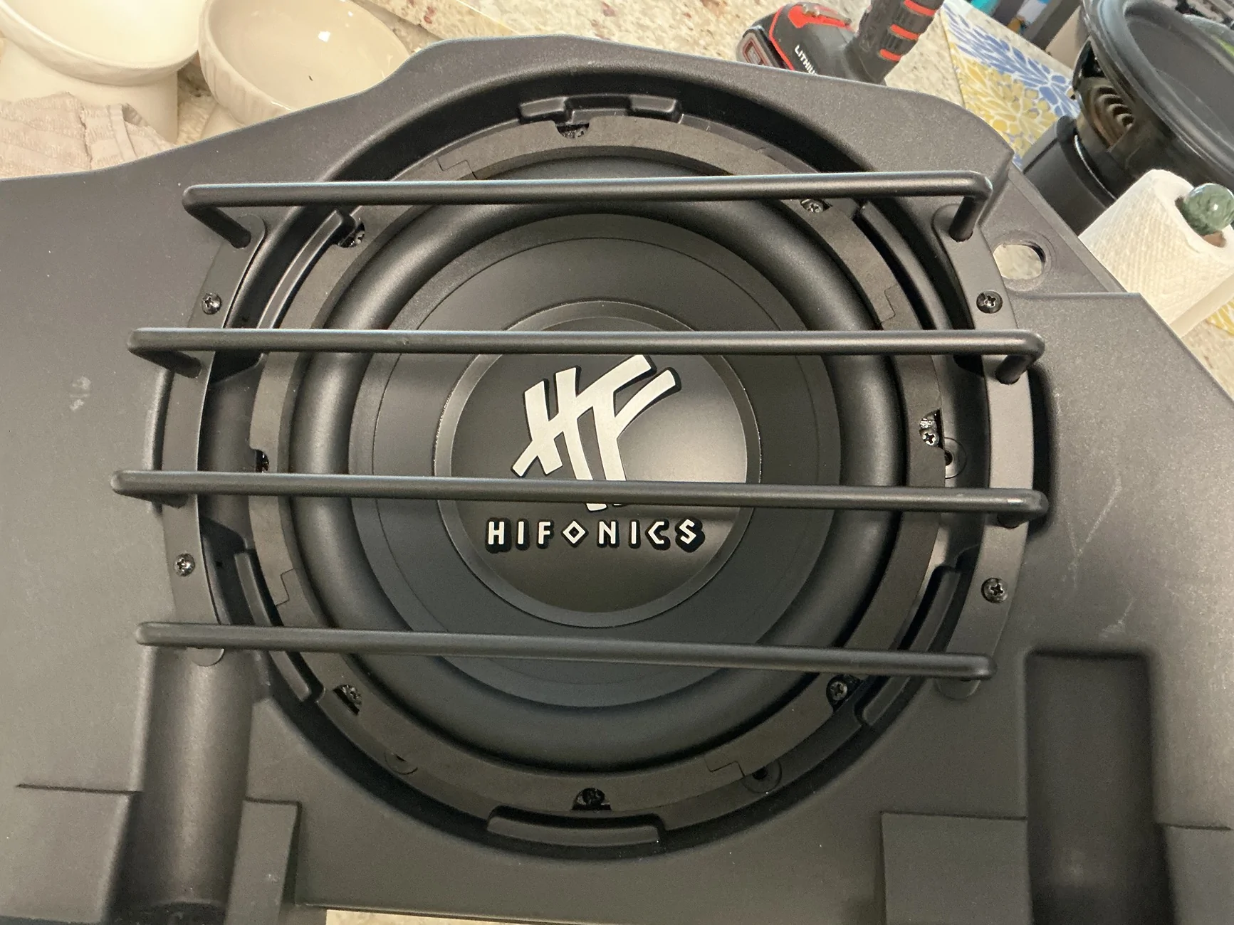

Pioneer 10” sub:
Drops right in as everybody said. I rotated it ever so slightly so I could drill new holes in the sub box to mount it. Drill extra small holes!!! The screws need to bite. Sounds better but not much boomier. What did happen is that it had better soundwaves which allowed all the other speakers to sound better. (I have the B&O 12 speaker system). I noticed significantly better sound out the side woofers! It just made the whole sound system sound better overall. This sub replaces the stock 4 ohm dual coil with the same specs. By using the stock holes on the Pioneer, I saved about an hour of drilling and bending the metal ring and was now able to put the Pioneer trim ring on. And you can’t really notice the Pioneer logo is slightly tilted.
I drilled 4 new holes and put the grill over.
Things I noticed while listening to different songs on XM Sirius:
- Folding down the back seat lets more sound up front
- In Surround mode, the sound is fuller and more spatial, but if you isolate the sub with the fader, some songs struggle with the sub…you can hear a distinct squealing and unpleasant audio artifacts….but it depends on the song.
- In Stereo the sound is much stronger at the cost of being less spacial, but the sub is stronger and shows no bad sound artifacts.

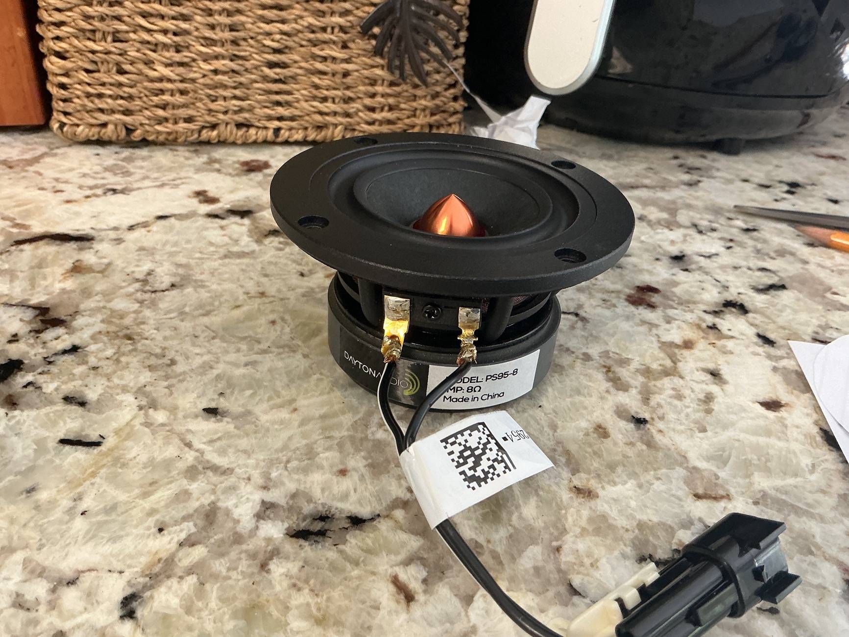

Dayton Audio 3.5” Center Speaker.
I got this speaker because the OEM center speaker is 8 ohm, 12.5 watts. This speaker is also 8 ohm, which I believe won’t upset the sound balance.

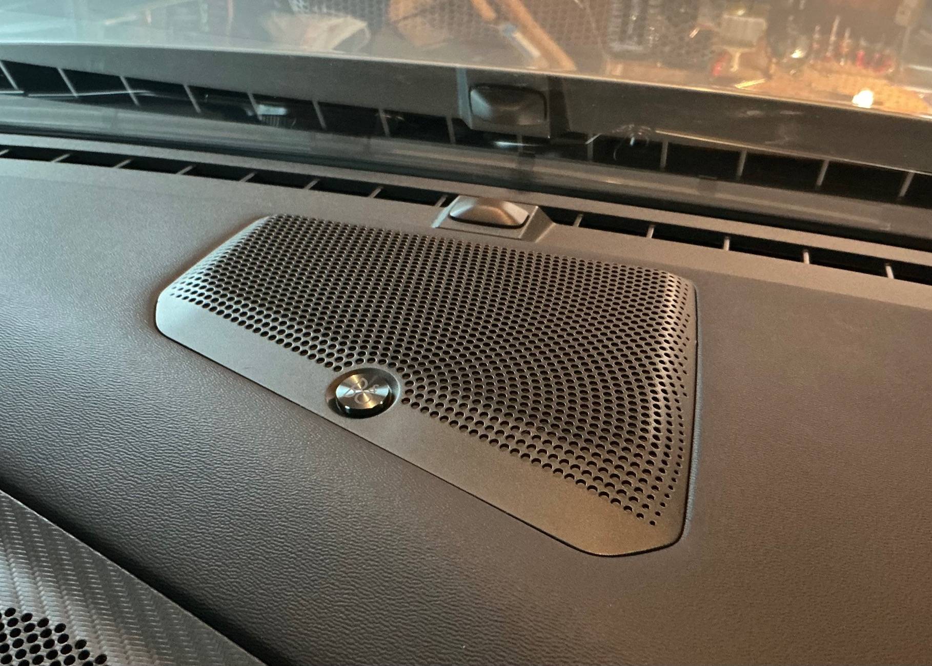

Center grill pops right off. Just held on with 4 clips. Just pop off with trim removal tool. Remove the 2 screws, Unclip the connector, and snip the wires and solder them to the new speaker. If you look close + and - are marked on both speaker terminals.

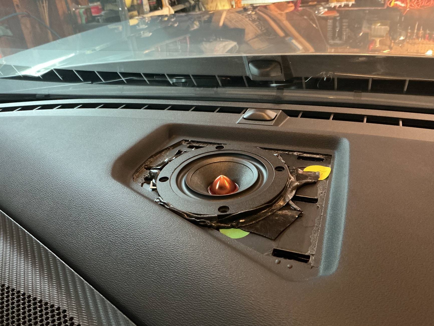

Now here’s the hard part. The new speaker holes don’t come anywhere close to lining up with the two stock screw holes in the dash. There’s also no room to drill new holes as the windshield is just 2 inches above the opening. I thought about it a while and determined, if 3M tape can hold on my front splitter, louvers, rear spoiler, and side louvers, they can hold a little speaker on the dash.
So I peeled the foam tape off the new speaker, and double taped inside the little recessed sections underneath inside the metal ring recess, so the final ring of 3M tape has a flat surface to stick to. Then I trimmed the little plastic alignment tab off the center dash, and laid down a ring of 3M tape to the dash to receive the speaker. I connected the wire clip, dropped in the speaker and secured the edge of the ring with more thin strips of 3M tape. I determined it is NOT going anywhere! The speaker grill clipped on top of it…. no problem.

Pioneer sub with 4 bar grill.

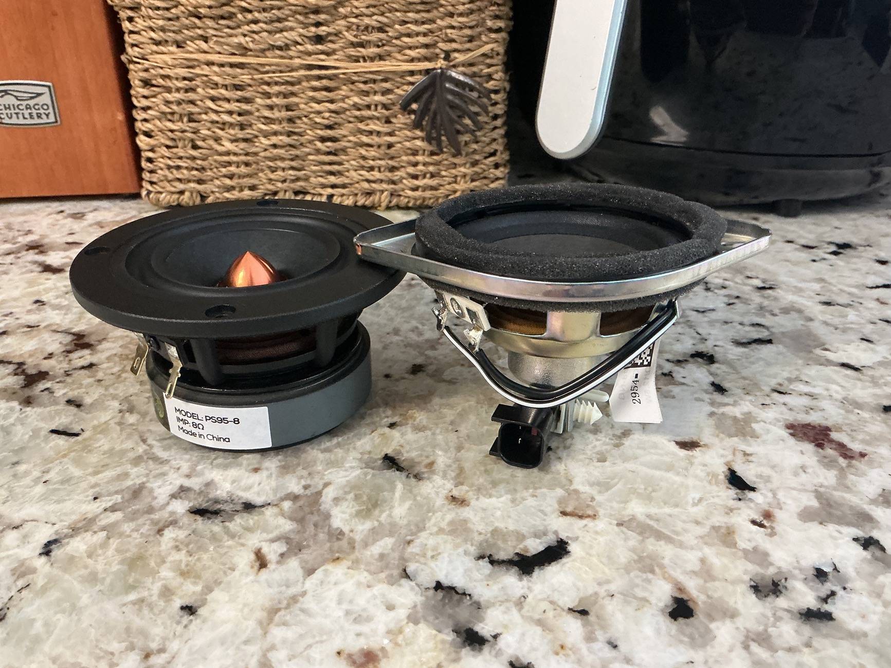

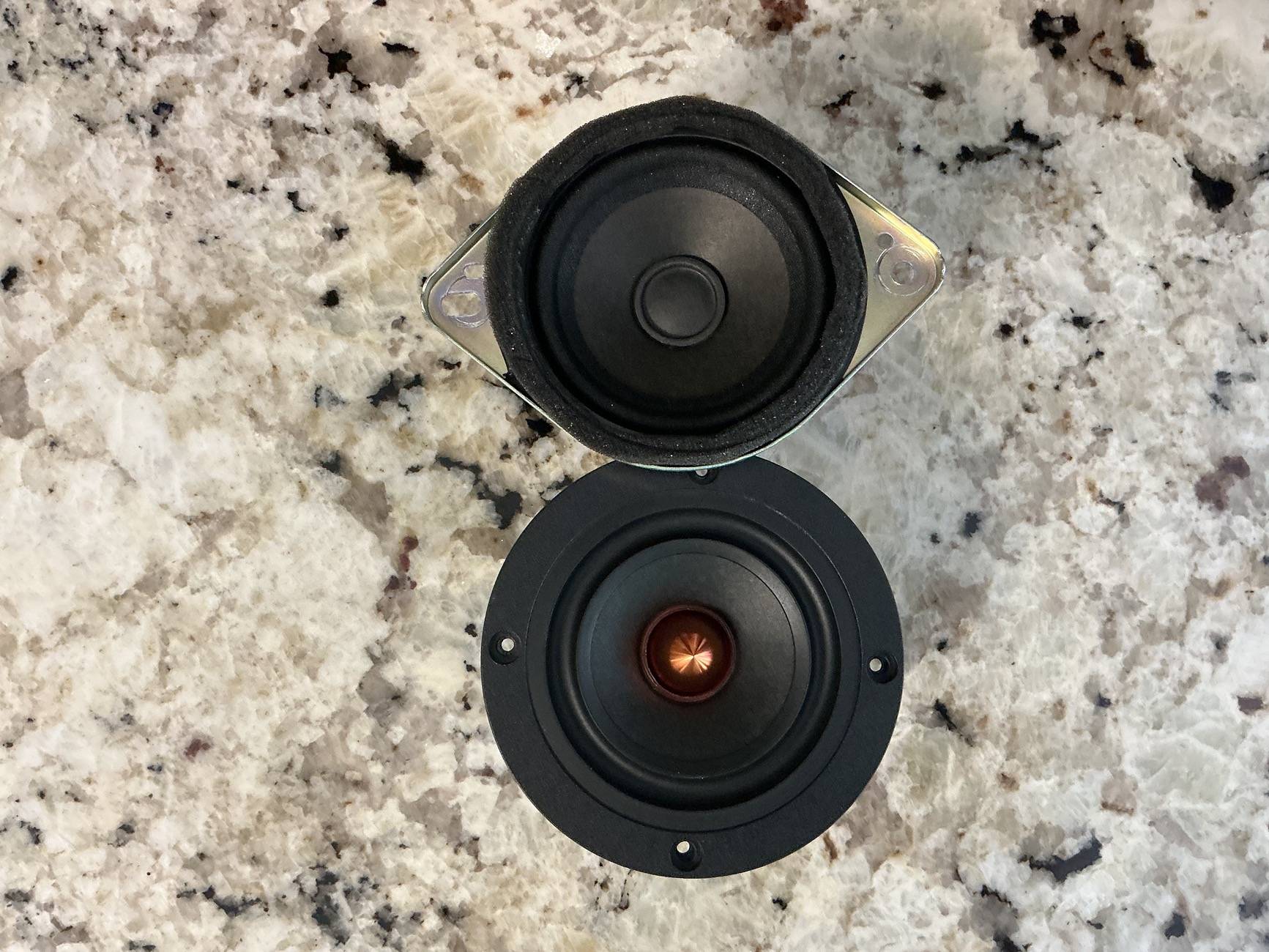

Mounting holes not even close!
S650 Mustang My Adventures in Upgrading the Subwoofer and Center Speaker IMG_7253
New vs. old

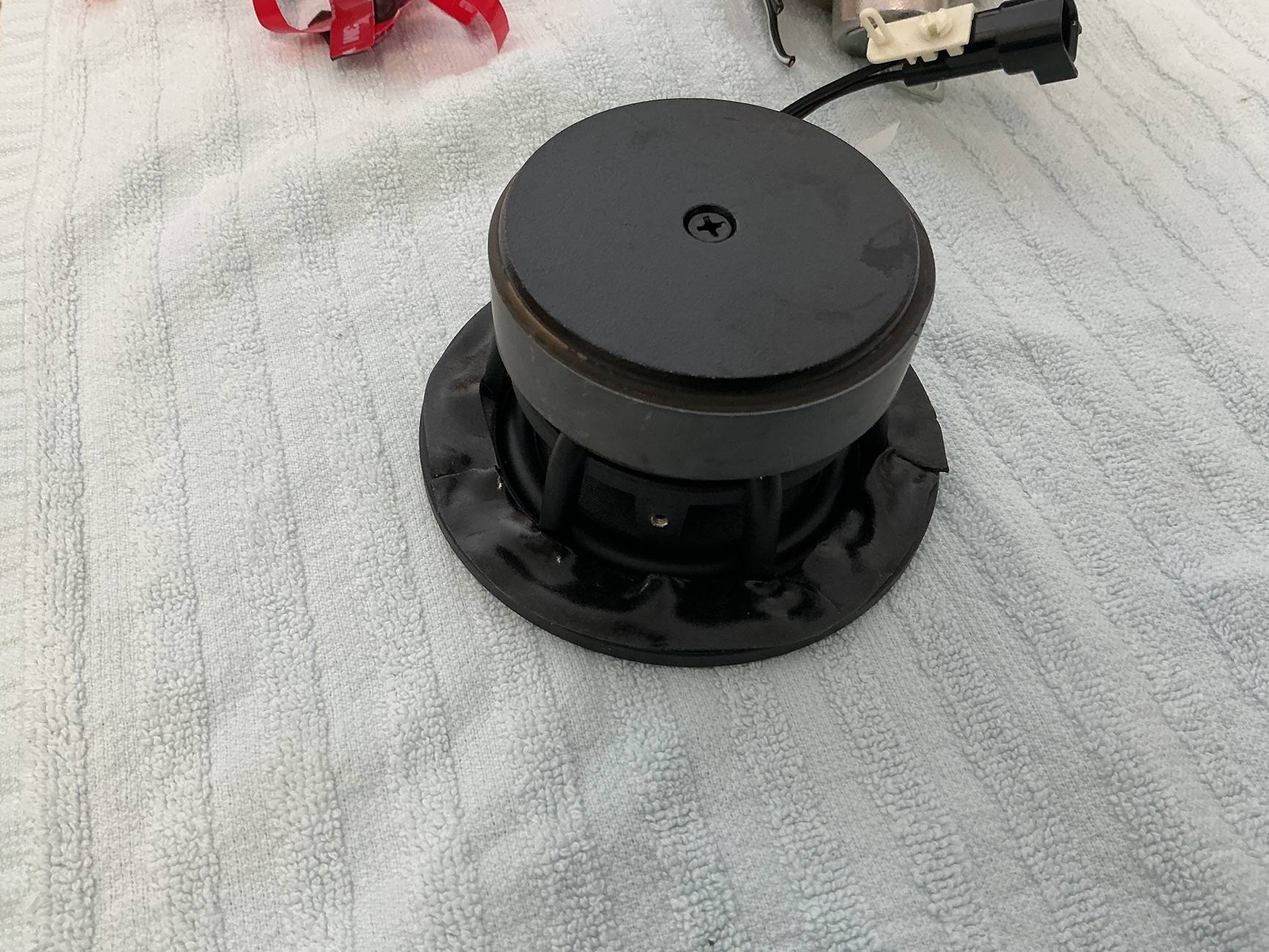

Showing how the little strips of 3M tape fill the recesses in the speaker ring.

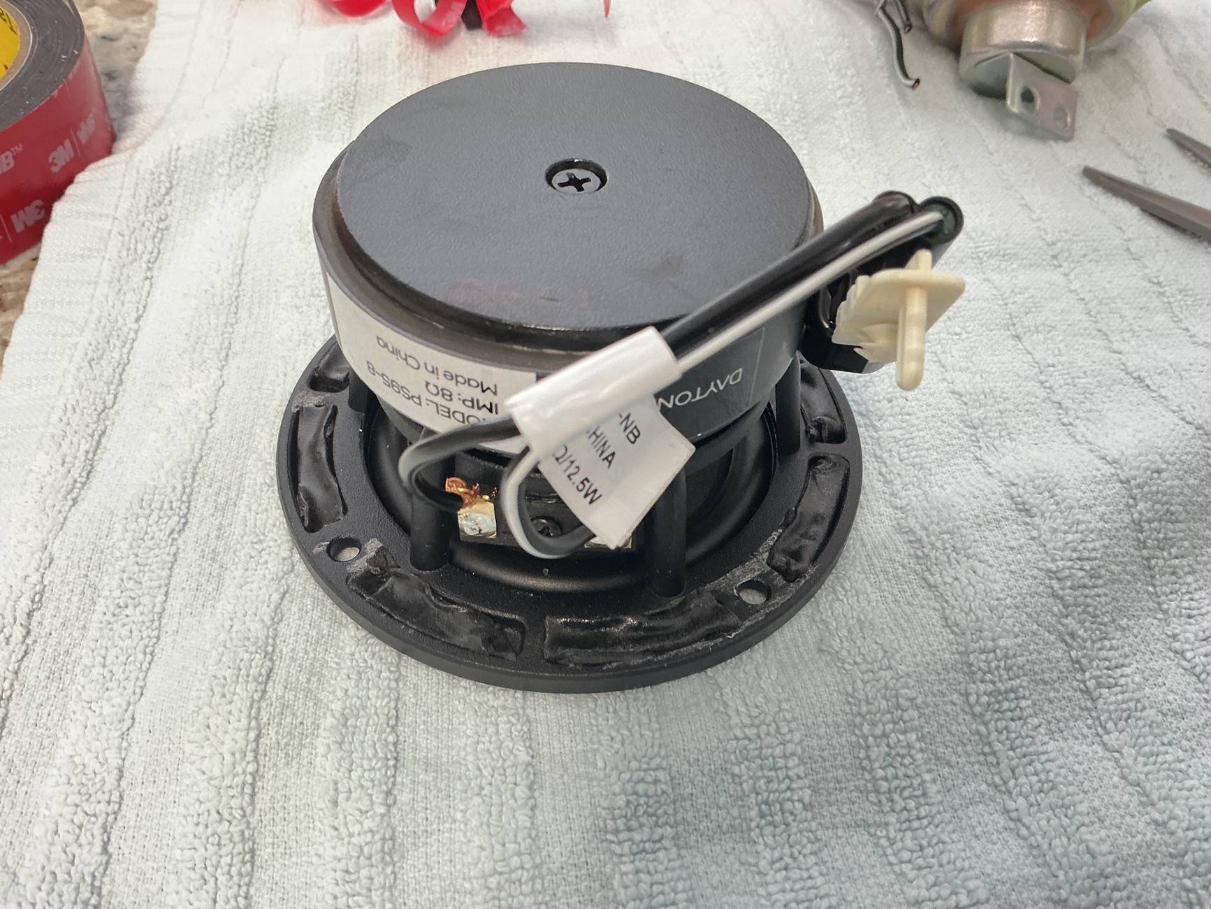

OEM clip soldered on to new speaker

New speaker mounted with 3M tape. Don’t laugh…it worked! OK…lol.

Center Speaker Grill Clipped right back on. (Phew)

Pioneer 10” sub:
New vs. old

I've wanted to replace the center speaker and have a trim removal tool kit, but none will fit the small crack to remove the grill. How about a mock up pic of the tool and where you used it on the grill please.
Junkyard Dog
Jun 3, 2025
56
2,748
2,263
Yes - if you would, please provide a better description of how you get into the center speaker and remove it. Thank you in advance.

Trim removal kit…Under $7 and you get every tool you’d ever want. This is what I bought and used.
https://www.amazon.com/dp/B07V22YC9J?ref=ppx_yo2ov_dt_b_fed_asin_title&th=1
The dash itself is soft and pliable, so it’s really easy to wedge one of the tools under the grill, and it just pops right up. Just wedge one of your tools into the dash and press down…it WILL get under the speaker grill. There’s 4 clips total and they are just friction fit. Don’t be scared to pop the grill up…nothing will break. The clips WILL give before anything bad happens!
The OEM speaker itself is just 2 screws that require a socket head. And pinch the wire clip and it disconnects easy And pulls right out. Remember to set the dash wire clip into the side dash slot so it doesn’t fall down in the hole.
