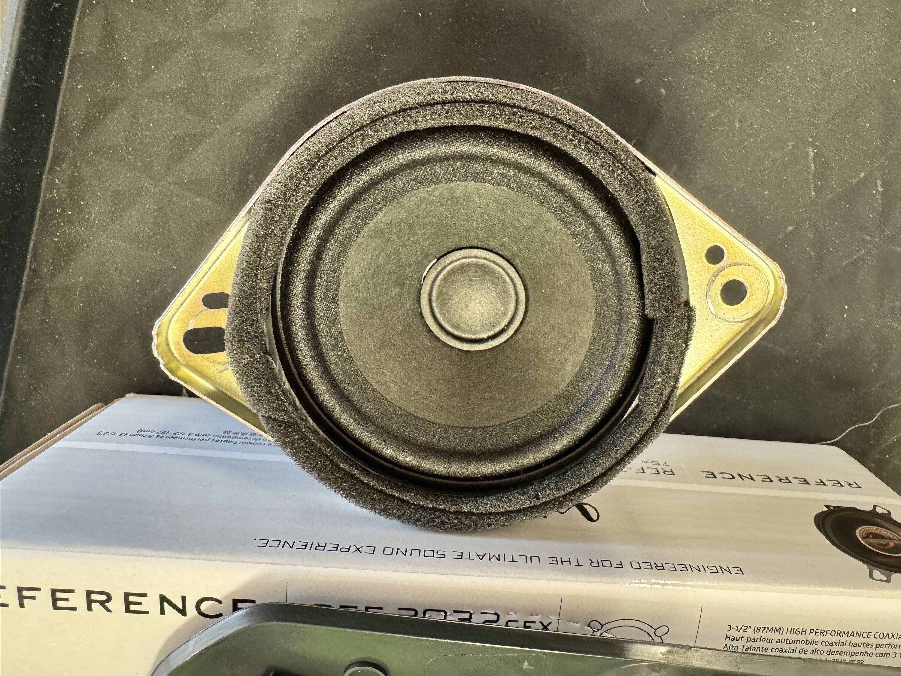

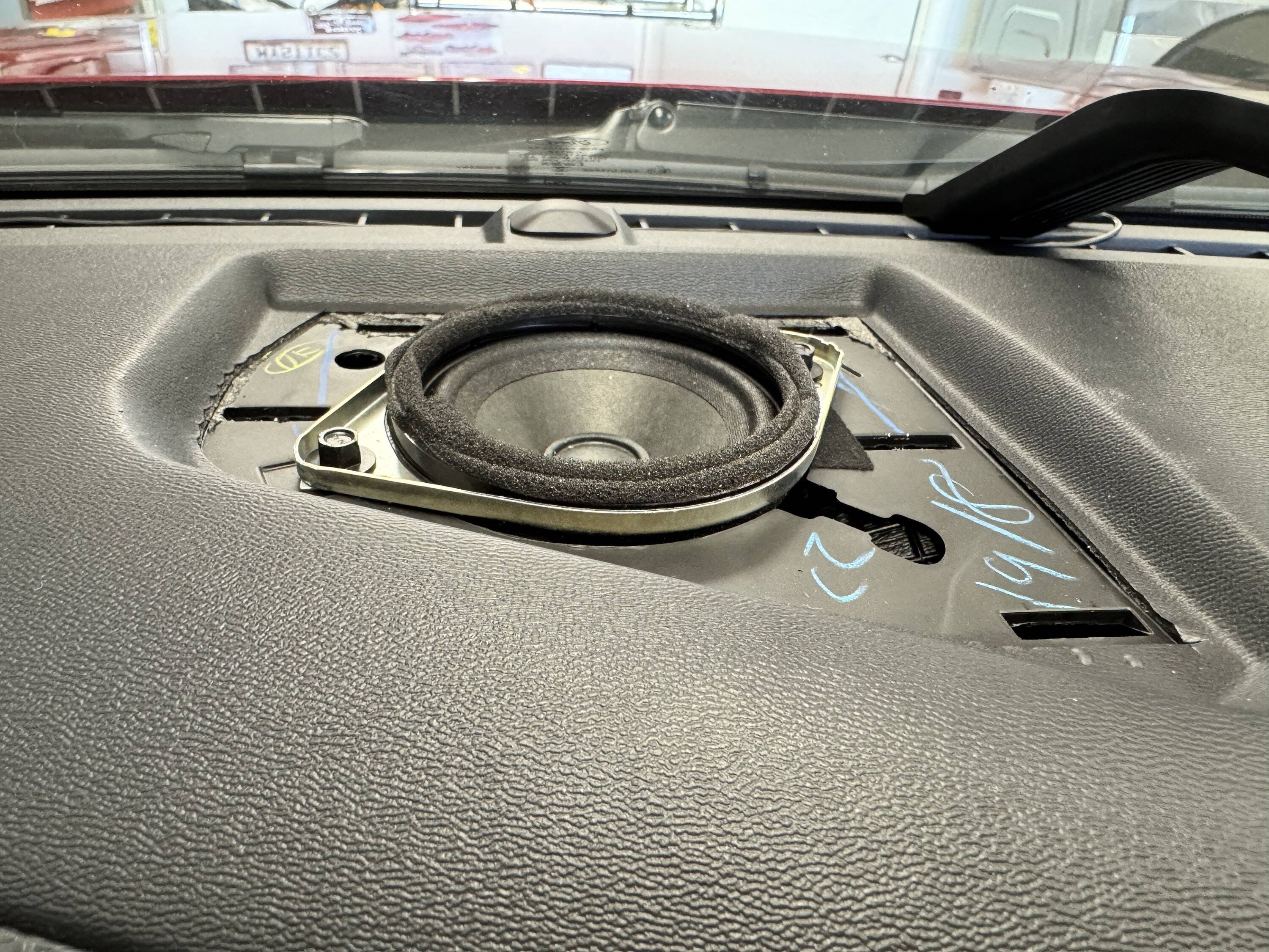

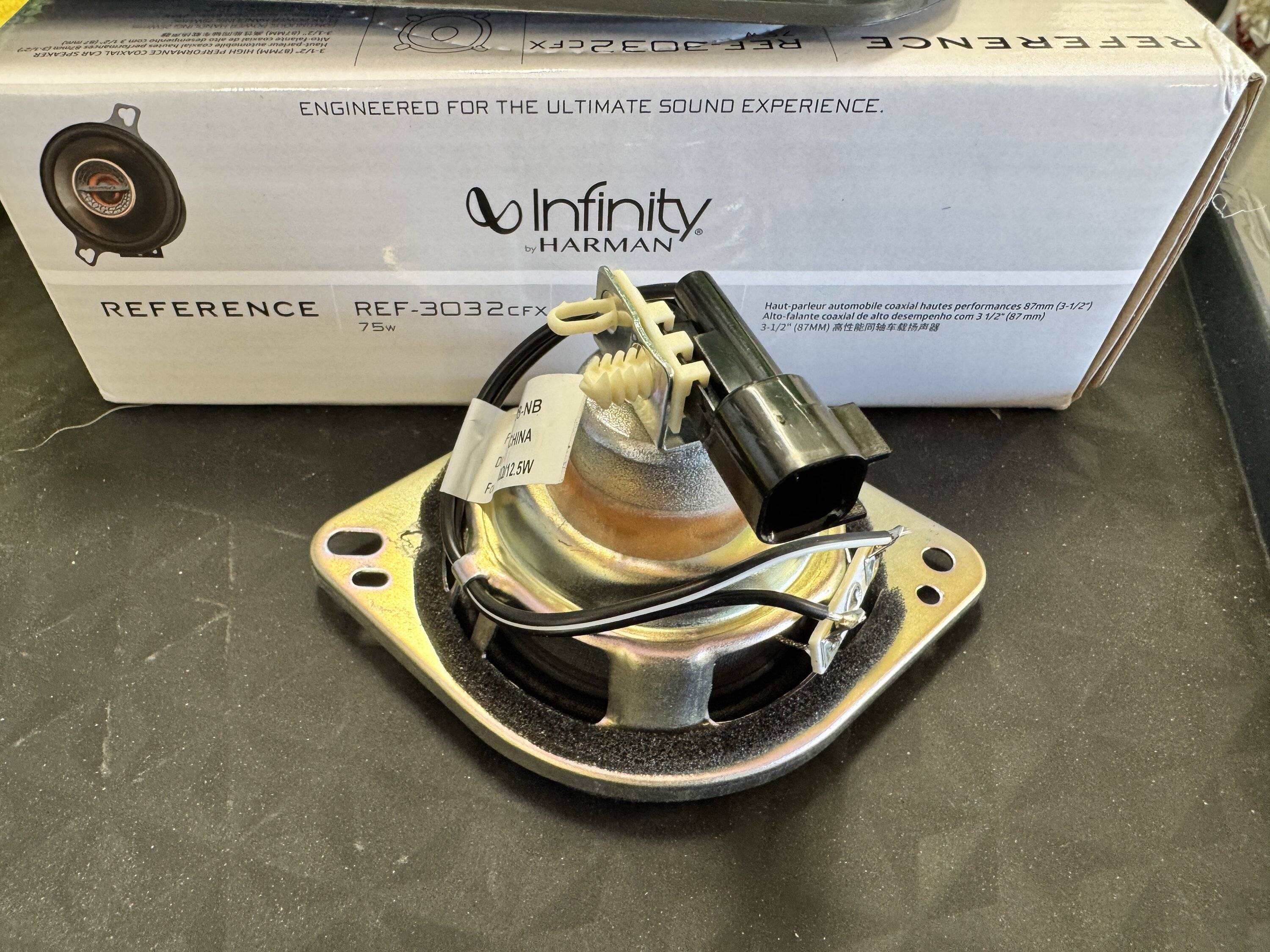

I just replaced the center speaker, sound is much better!
I have a 2022 Mach E GT/PE as well, and there are forum posts about replacing that center speaker for better sound, and it did work! Thought i would try it on my 2024 Mustang GT as well.
Could not find any write ups on it unless i was going to gut the whole system but since i had a leftover speaker from the Mach E, figured may as well try it.

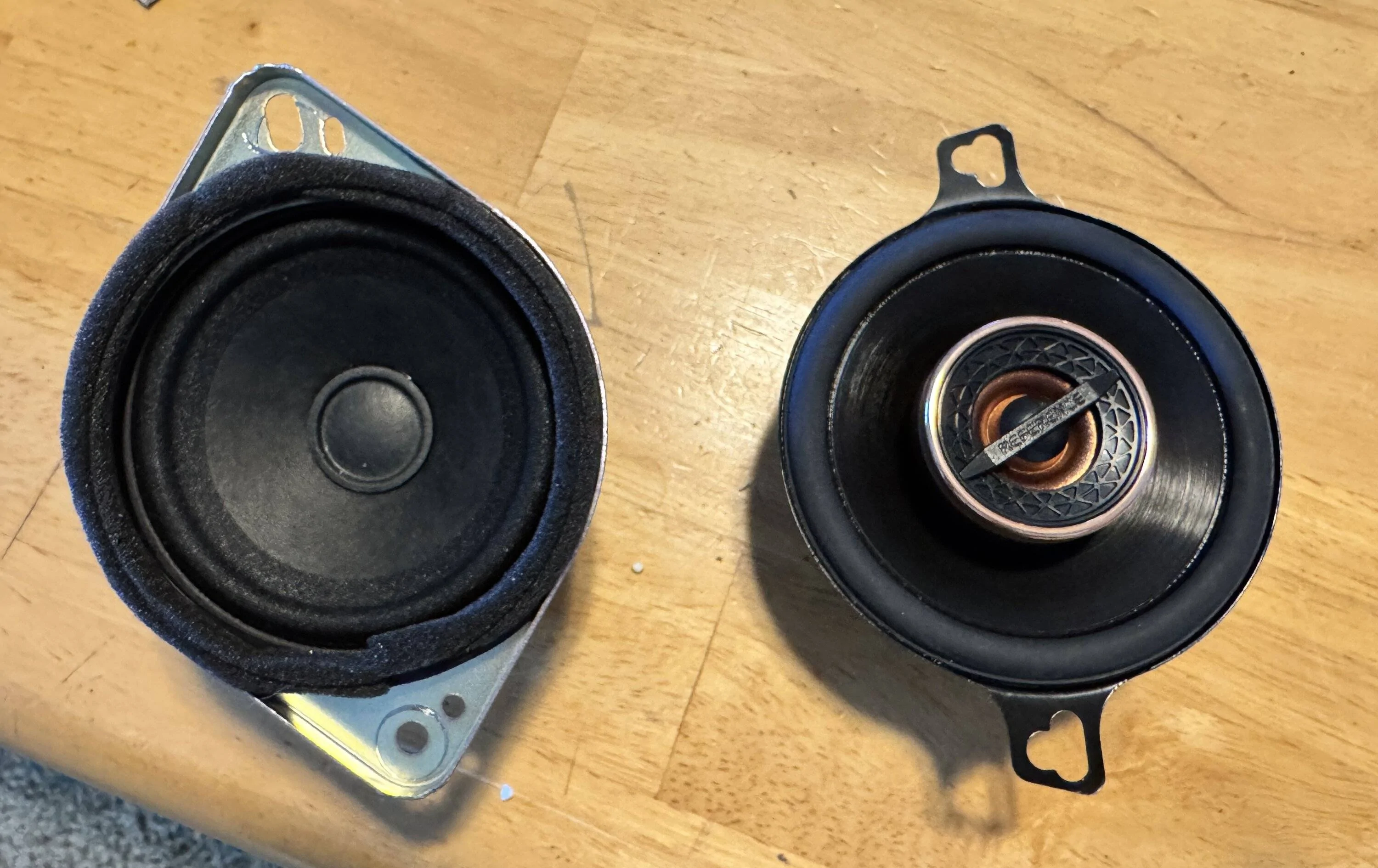

I already did the subwoofer swap out with the Pioneer that is in here and forums, big difference. I just put the center one in, sound much clearer, now its not life changing sound, but for the price and if you dont want to change everything out, it could be worth trying. The speakers i got on amazon for $50 for the set.

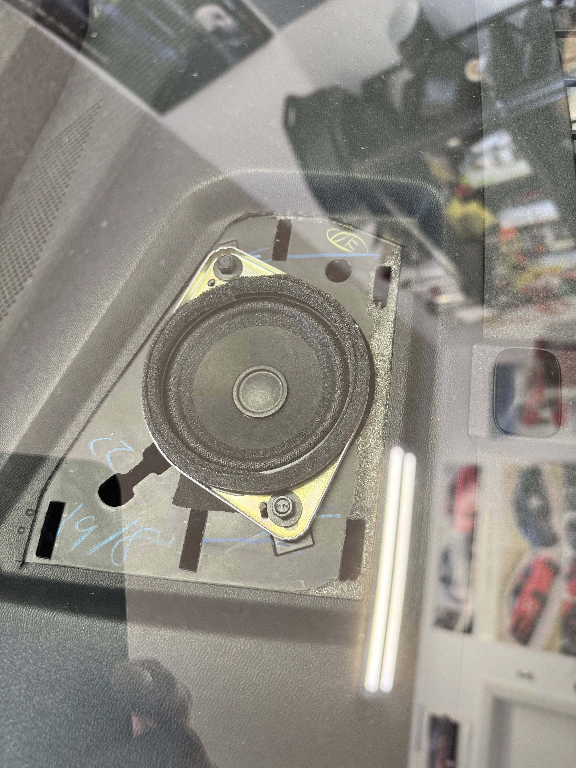

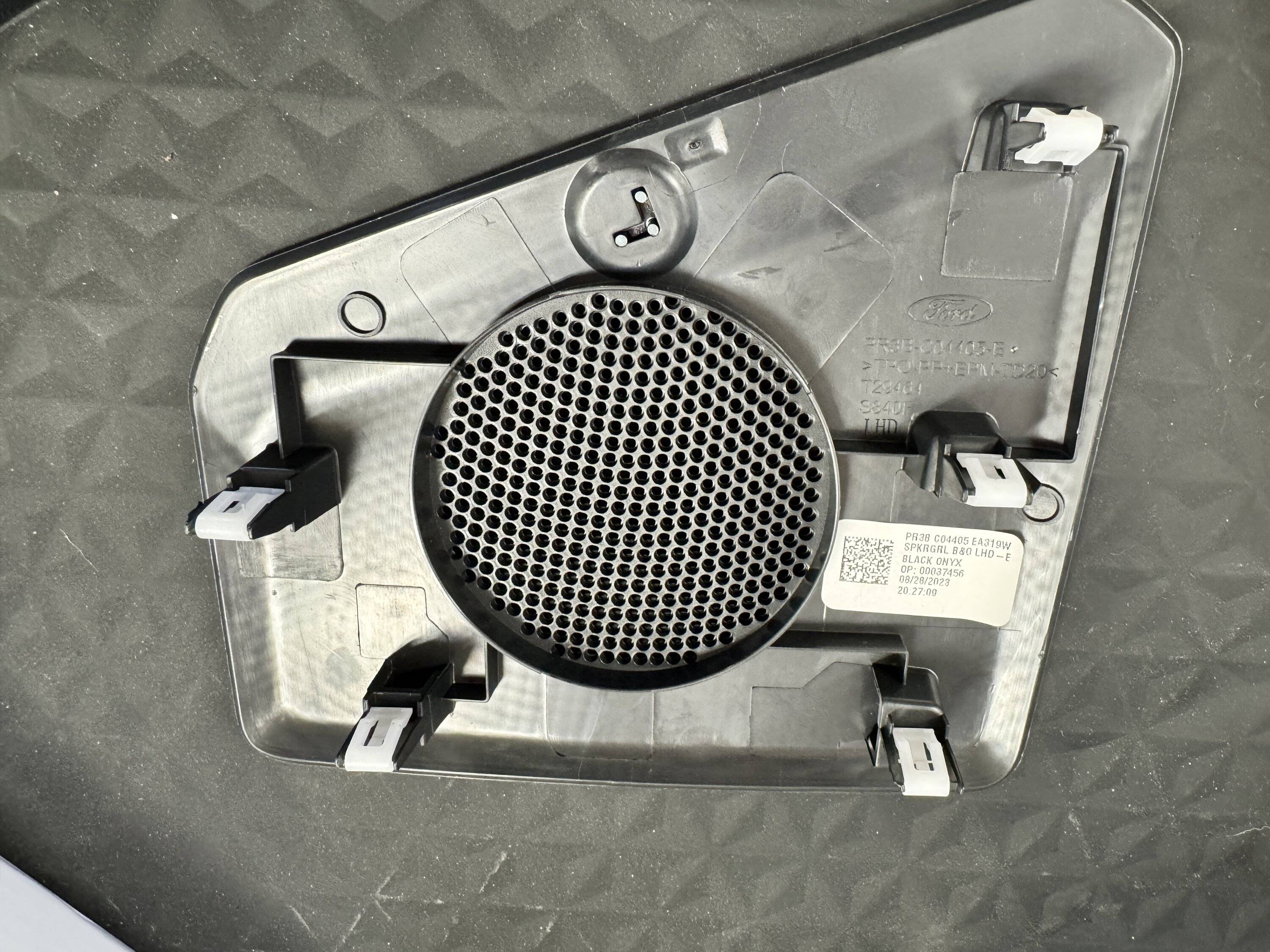

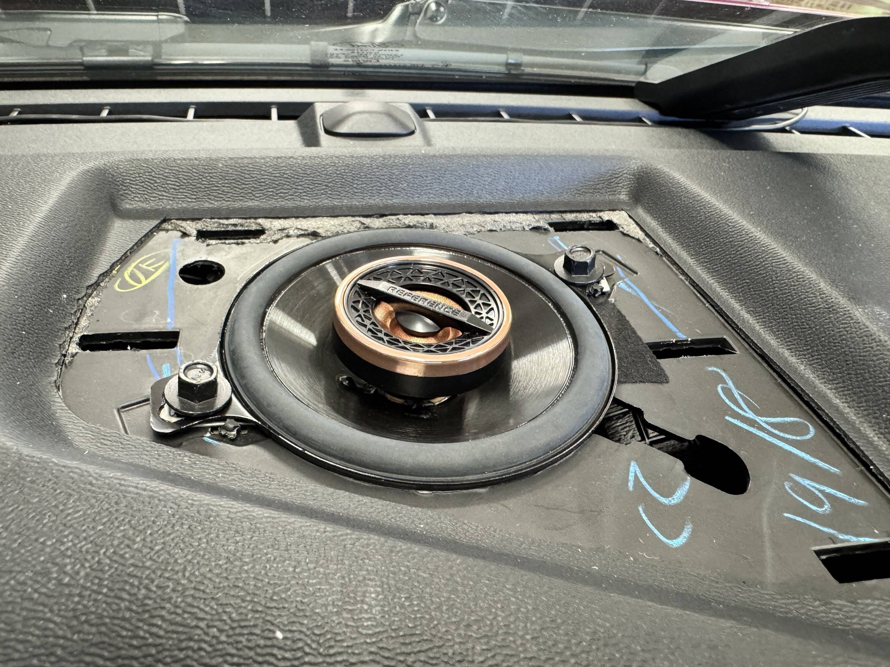

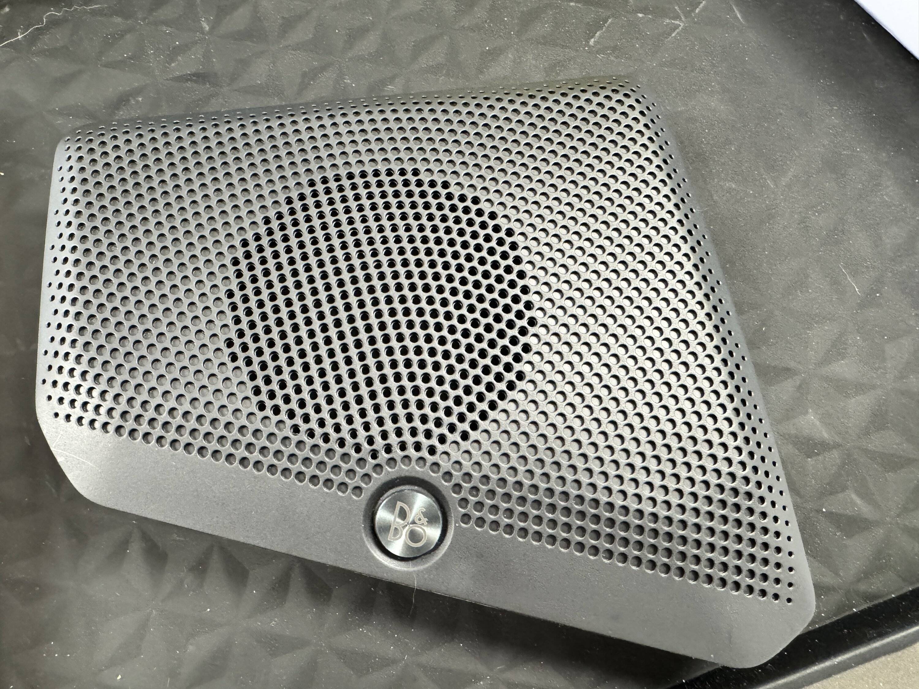

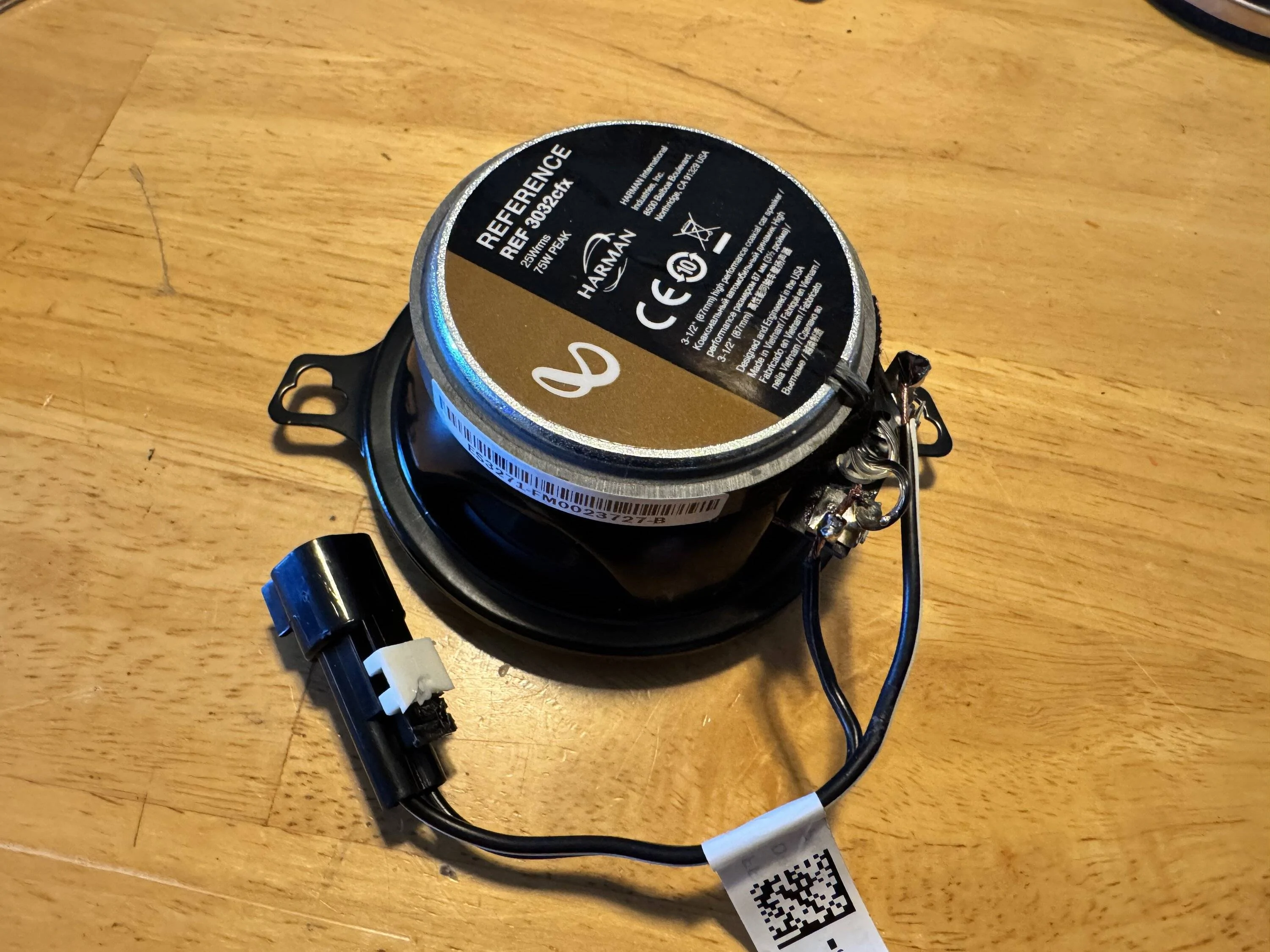

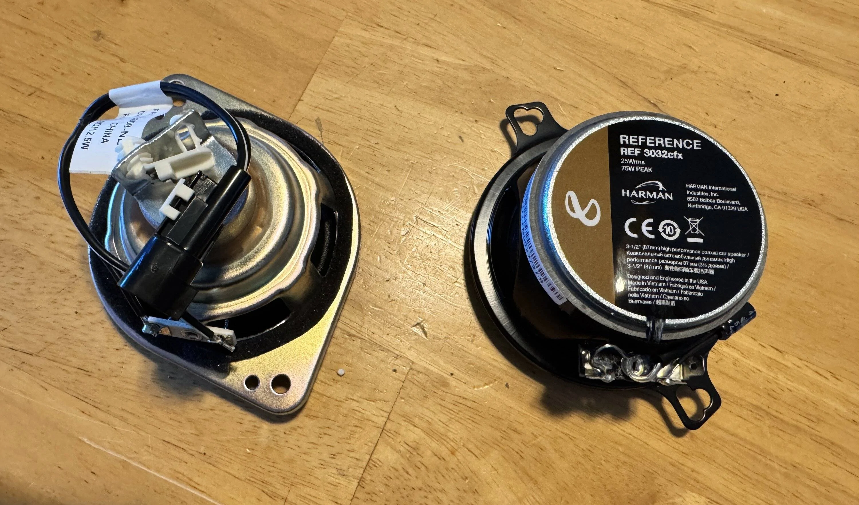

The center speaker grille just pops off, use a trim removal tool on a corner in the front, and you will get it to pop off one by one in about 30 seconds. Just lifts straight up. 2 screws hold speaker in place. Unplug the factory plug, I think you have to push the tab down and pull. I cut the wires off the factory speaker and soldered to the new one. Popped it back in and it was louder for sure. I did have to adjust the fader more to the back since now there was a lot of highs that were not there before and lower the treble down a few steps, but with that and the updated sub, it is better than before. Again, not life changing or super hard hitting, but much better than the factory B&O it comes with in my opinion.
I have included the pics as well.

From the pictures I’ve seen, the OEM subwoofer looked like paper cardboard trash. This OEM speaker looks like it’s out of the same parts bin.

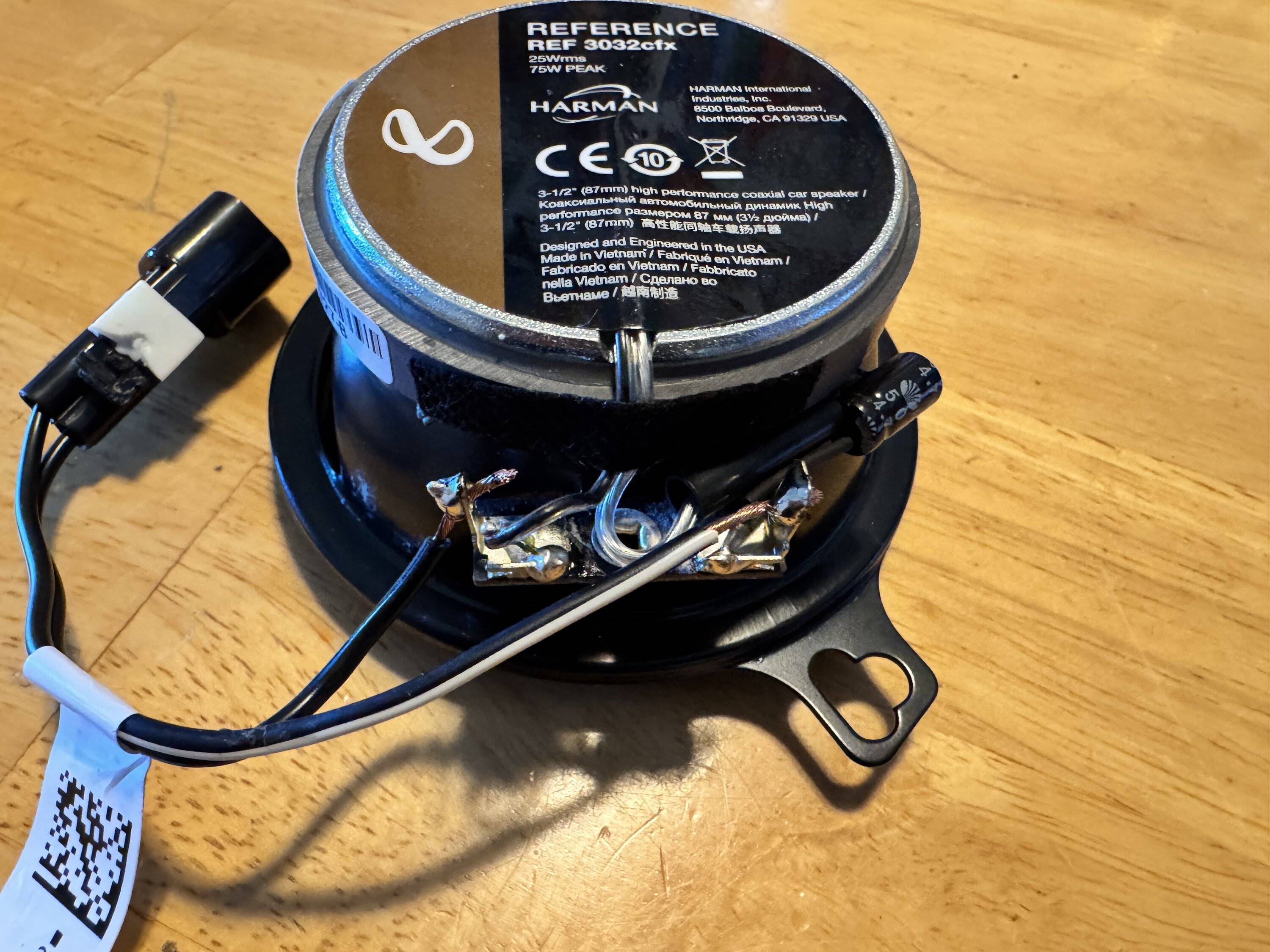

Looks like you replaced an8Ohm speaker with an 4ohm.
goodlettjr
Apr 29, 2023
520
745
Charlotte, NC
@disneyfun1 can you verify the ohms on the original speaker?

When I move jack to new infinity speaker, how can I identify + and - connector?
black is - and black/white is +?
the black/white went on the connector on the right side if you have the new speaker with the plugs on the bottom, you can kind of see it in one of the pics above, i thought the may have been marked on the factory one as well, but i could be wrong, i was just going through my pics on where i put them, hope that helps

Just completed this mod. It's definitely noticeable. OBTW you end up getting 2 speakers. If anyone wanting to do this, PM me if you would like to buy my extra one.
And yes, black/white on right, black on left looking at speaker from rear. Speaker instructions shows grd on left, so it confirms.
