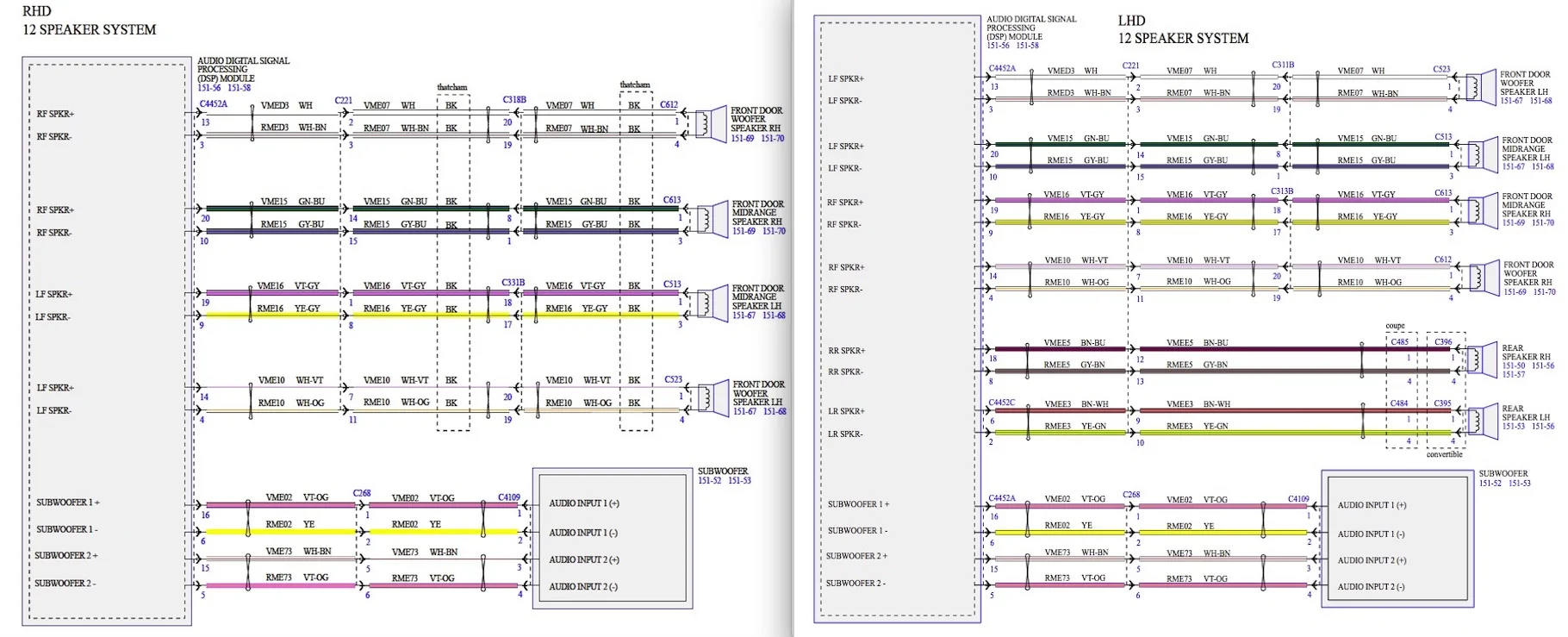

S650 Mustang Changed out center speaker in 2024 Mustang GT with B&O System Speaker_wiring

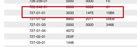

Ford's electronic sound enhancement system ("ESE") plays specific frequencies through the speakers to make the engine and exhaust sound more "spectacular" - unfortunately at the expense of the music that is played.
That system can be disabled with Forscan. Don't make the mistake to read all threads completely, there ar some trolls around.
Just turn it off and see if it's better for you. Can be turned on again if you liked the augmented sound.

Thank you Fruitstang. I just looked at the ACM data and the ESE is enabled. I will have to change it. BTW-I also noticed recently while playing back video and audio from my webcam I doubled the speed of the video in a section going up hill at 45mph while up shifting gears and the engine sound was more like a Ferrari and not a Mustang sound and that was very strange. Ford should allow the owner to switch it off via the config touch screen. We do not need video game car sounds effects added to the V8 engine.
S650 Mustang Changed out center speaker in 2024 Mustang GT with B&O System ACM_data
