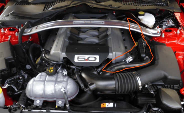

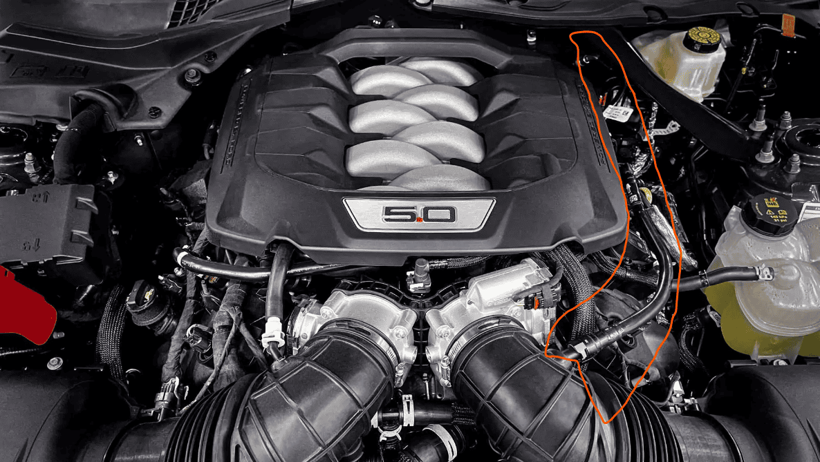

Seriously?! That is great news. I thought this was the 24 sound tube:
For those that don't know, this is the sound tube from 15-23:
That tube you marked is for the PVC as I recall - have to look under the hood of my car now but I think that is connected to my catch can.

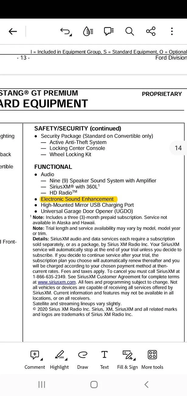

I test drove a 24 yesterday and was surprised yet skeptical of the interior engine noise. I did a lot of research to find out the same question OP had. Looking at the spec sheets, both Ecoboost and GT are equipped with "electronic sound enhancement" which does appear to be engine sounds played through the speakers. Only saw this mentioned in a audio upgrade thread where someone had to disable it with forscan in a GT to resolve issues with their sound system upgrade. Any thoughts? Had anyone tried disabling this to see what difference it makes?

When I did my audio upgrades my audio tech said the 2024 GT did not have the electronic sounds coming through the speakers. At least the base model. No idea if it's any different in the B&O.
