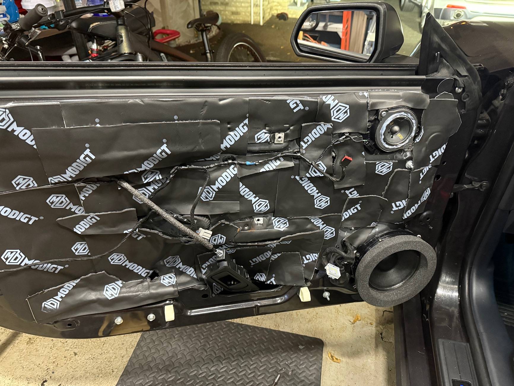

Damn dude, save some dynamat for the rest of us! lol
it’s harder to lay it flat and in one piece cause the trim panel hooks on to the gap where the regulator sits. the water shield isn’t exactly flat to do a cut out either. regardless, it does the job

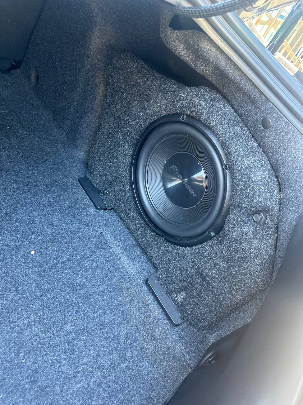

I put in the Pioneer 10” subwoofer.

Pioneer 10” sub:
Drops right in as everybody said. I rotated it ever so slightly so I could drill new holes in the sub box to mount it. Drill extra small holes!!! The screws need to bite. Sounds better but not much boomier. What did happen is that it had better soundwaves which allowed all the other speakers to sound better. (I have the B&O 12 speaker system). I noticed significantly better sound out the side woofers! It just made the whole sound system sound better overall. This sub replaces the stock 4 ohm dual coil with the same specs. By using the stock holes on the Pioneer, I saved about an hour of drilling and bending the metal ring and was now able to put the Pioneer trim ring on. And you can’t really notice the Pioneer logo is slightly tilted.
I drilled 4 new holes and put the grill over.
Things I noticed while listening to different songs on XM Sirius:
- Folding down the back seat lets more sound up front
- In Surround mode, the sound is fuller and more spatial, but if you isolate the sub with the fader, some songs struggle with the sub…you can hear a distinct squealing and unpleasant audio artifacts….but it depends on the song.
- In Stereo the sound is much stronger at the cost of being less spacial, but the sub is stronger and shows no bad sound artifacts.

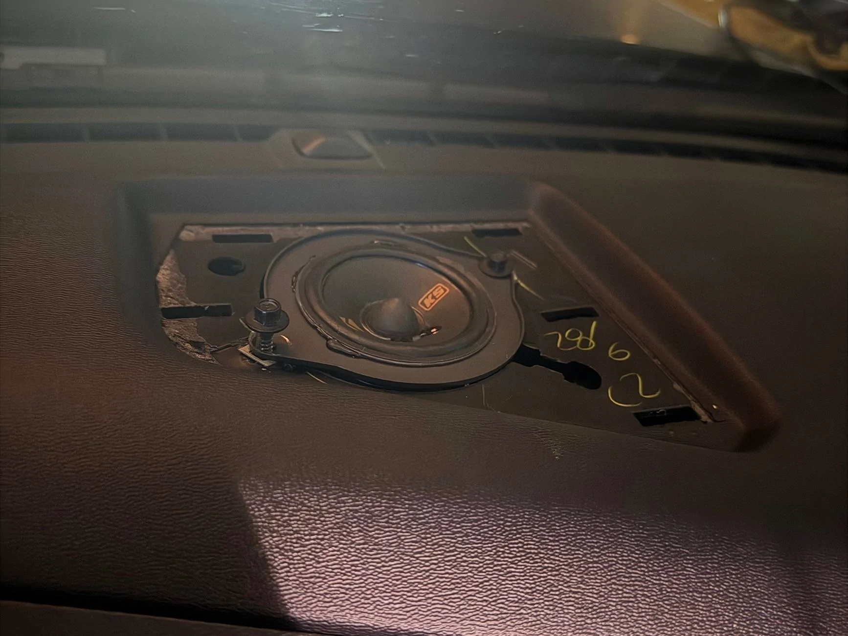

Center grill pops right off. Just held on with 4 clips. Just pop off with trim removal tool. Remove the 2 screws, Unclip the connector, and snip the wires and solder them to the new speaker. If you look close + and - are marked on both speaker terminals.
Now here’s the hard part. The new speaker holes don’t come anywhere close to lining up with the two stock screw holes in the dash. There’s also no room to drill new holes as the windshield is just 2 inches above the opening. I thought about it a while and determined, if 3M tape can hold on my front splitter, louvers, rear spoiler, and side louvers, they can hold a little speaker on the dash.
So I peeled the foam tape off the new speaker, and double taped inside the little recessed sections underneath inside the metal ring recess, so the final ring of 3M tape has a flat surface to stick to. Then I trimmed the little plastic alignment tab off the center dash, and laid down a ring of 3M tape to the dash to receive the speaker. I connected the wire clip, dropped in the speaker and secured the edge of the ring with more thin strips of 3M tape. I determined it is NOT going anywhere! The speaker grill clipped on top of it…. no problem.

Pioneer sub with 4 bar grill.
CENTER SPEAKER
Mounting holes not even close!

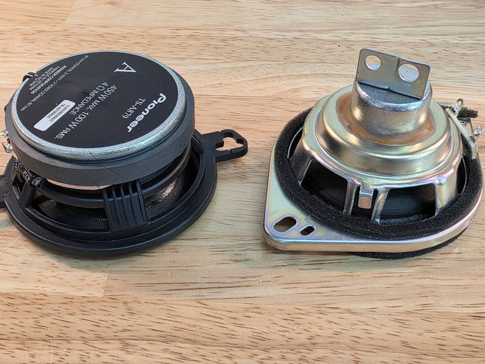

Thanks to help from this forum I finally got around to replacing the center speaker. I previously did the Pioneer sub. Removing the center grill wasn't the problem I had imagined. Somebody previously posted that they used the Pioneer TS-A879 3 1/2" speakers because they have the same 2 mounting holes so I bought a pair. The install took less than a half hour. The speaker mounted perfectly and sounds much better than stock. What a POS that was. I had to buy a pair so I have another one. If somebody wants it PM me and we can work out a deal.

That center Pioneer speaker looks nice. Being that it’s 4 ohm vs. stock OEM 8 ohm, does it sound louder than the other speakers? Like, does it sort of stand out?
I still don’t know if it’s really a bad thing to go with lower ohm on a little center speaker. I chickened out and got that Dayton 8 ohm.
Yes, it does sound a little louder, but not much. The music is a lot clearer, not nearly as muddy, and there's a little more bass.
