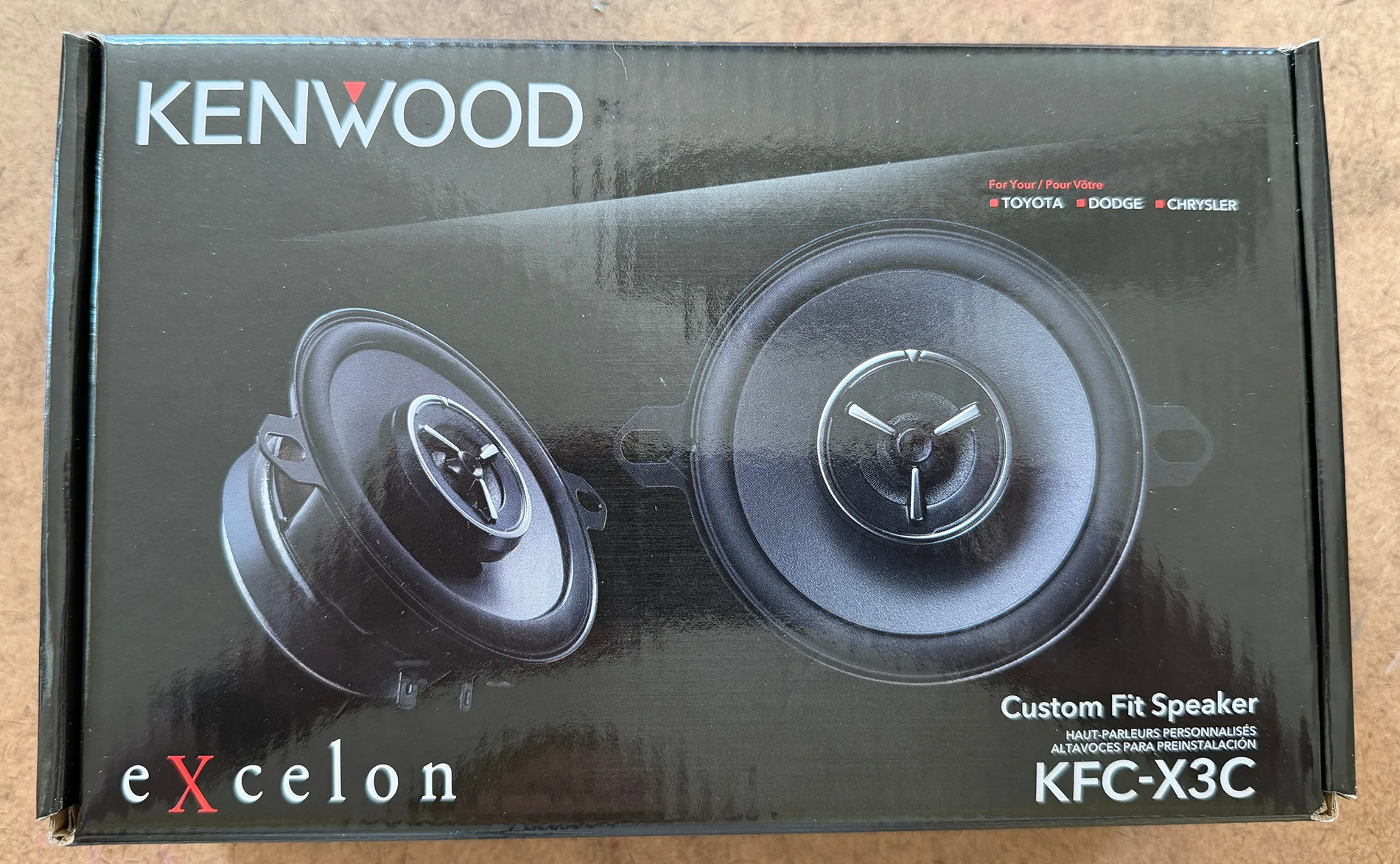

So I upgraded my center speaker today with Kenwood Excelon KFC-X3C and I love the results. The Kenwood is a 4 ohm speaker unlike the 8 ohm OEM, but with the very low 83db sensitivity (1w/1m) it blends in much better. Such a great upgrade. Here are some pictures and comments during the installation process:

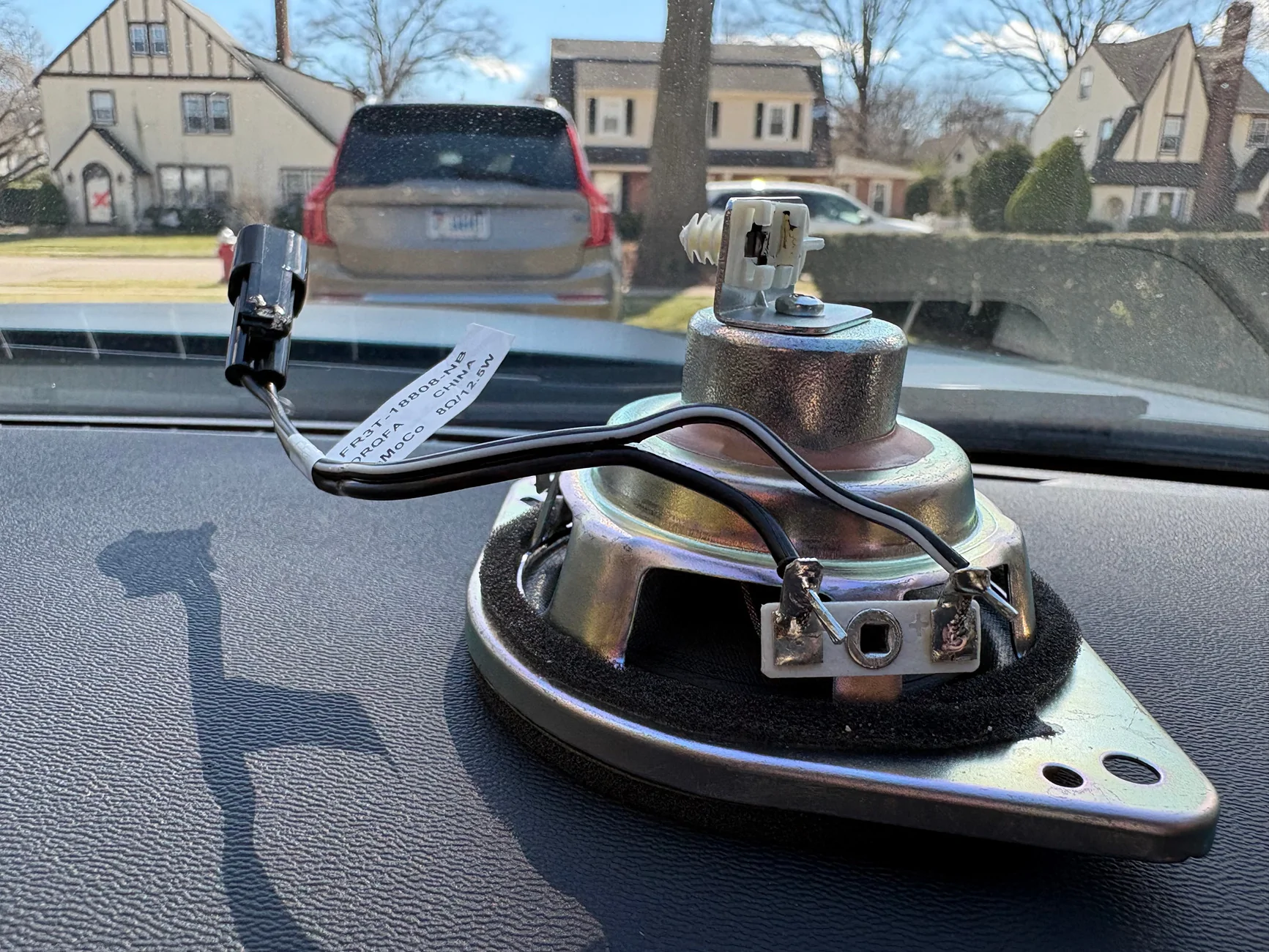

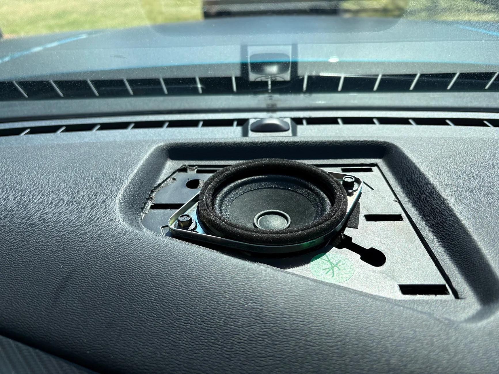

Here's the stock speaker:
S650 Mustang My Adventures in Upgrading the Subwoofer and Center Speaker IMG_0129

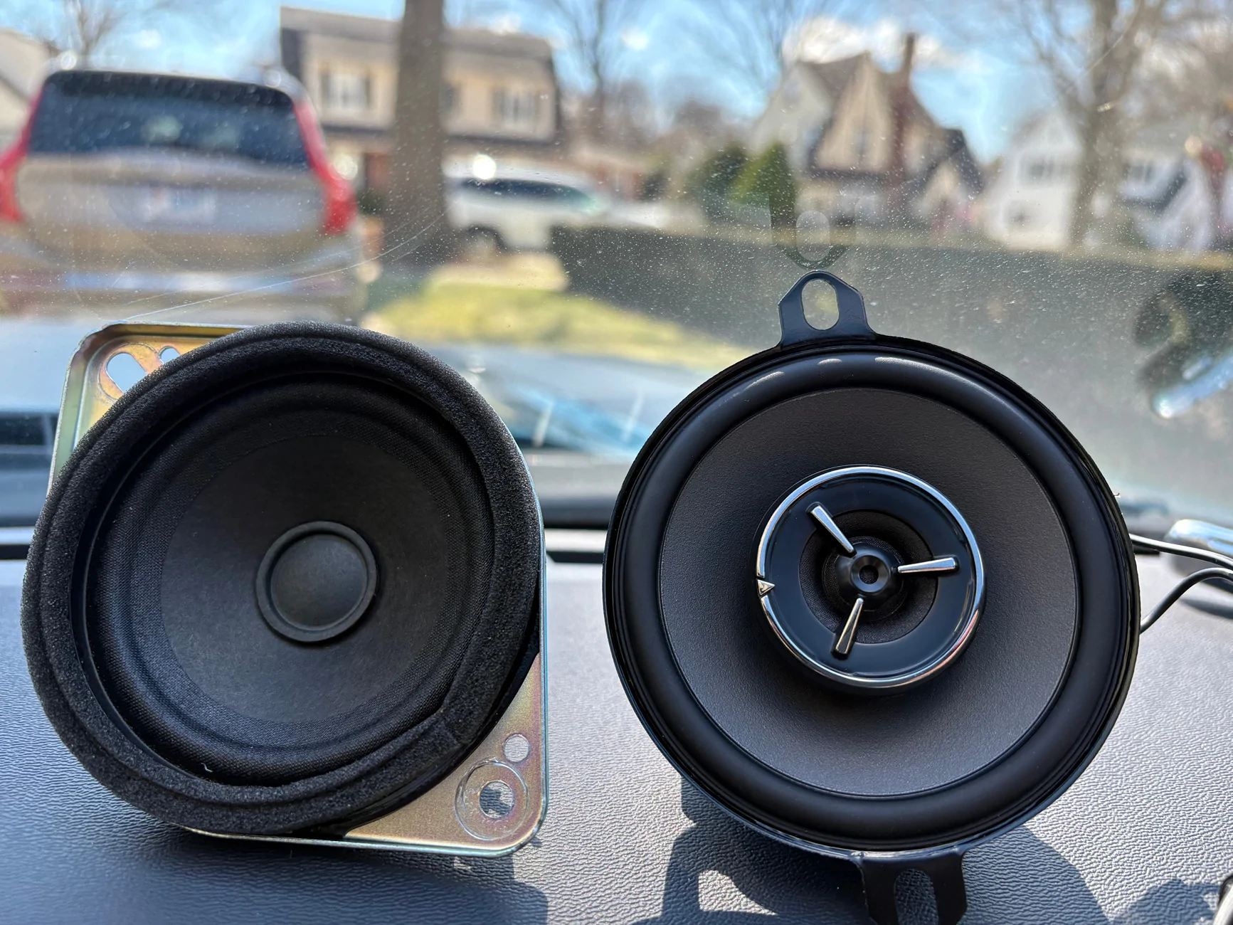

Junk. After removing the stock speaker, here's the stock and new one side-by-side:
S650 Mustang My Adventures in Upgrading the Subwoofer and Center Speaker IMG_0131
Here are the connectors on the stock speakers. I cut the wires from the stock speaker to re-use the connector plug:
S650 Mustang My Adventures in Upgrading the Subwoofer and Center Speaker IMG_0133

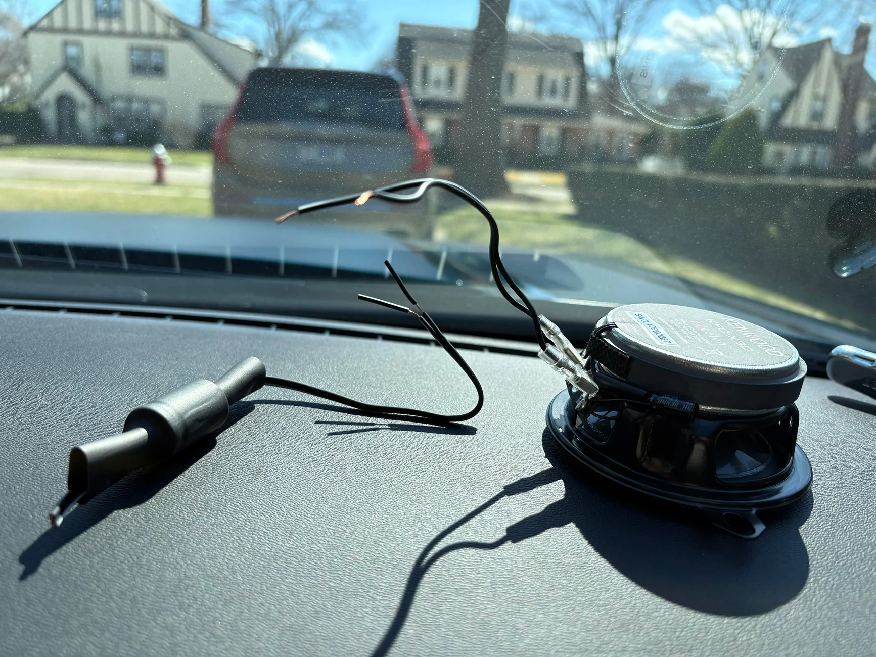

Here's the Kenwood. I cut off the crossover module:
S650 Mustang My Adventures in Upgrading the Subwoofer and Center Speaker IMG_0134

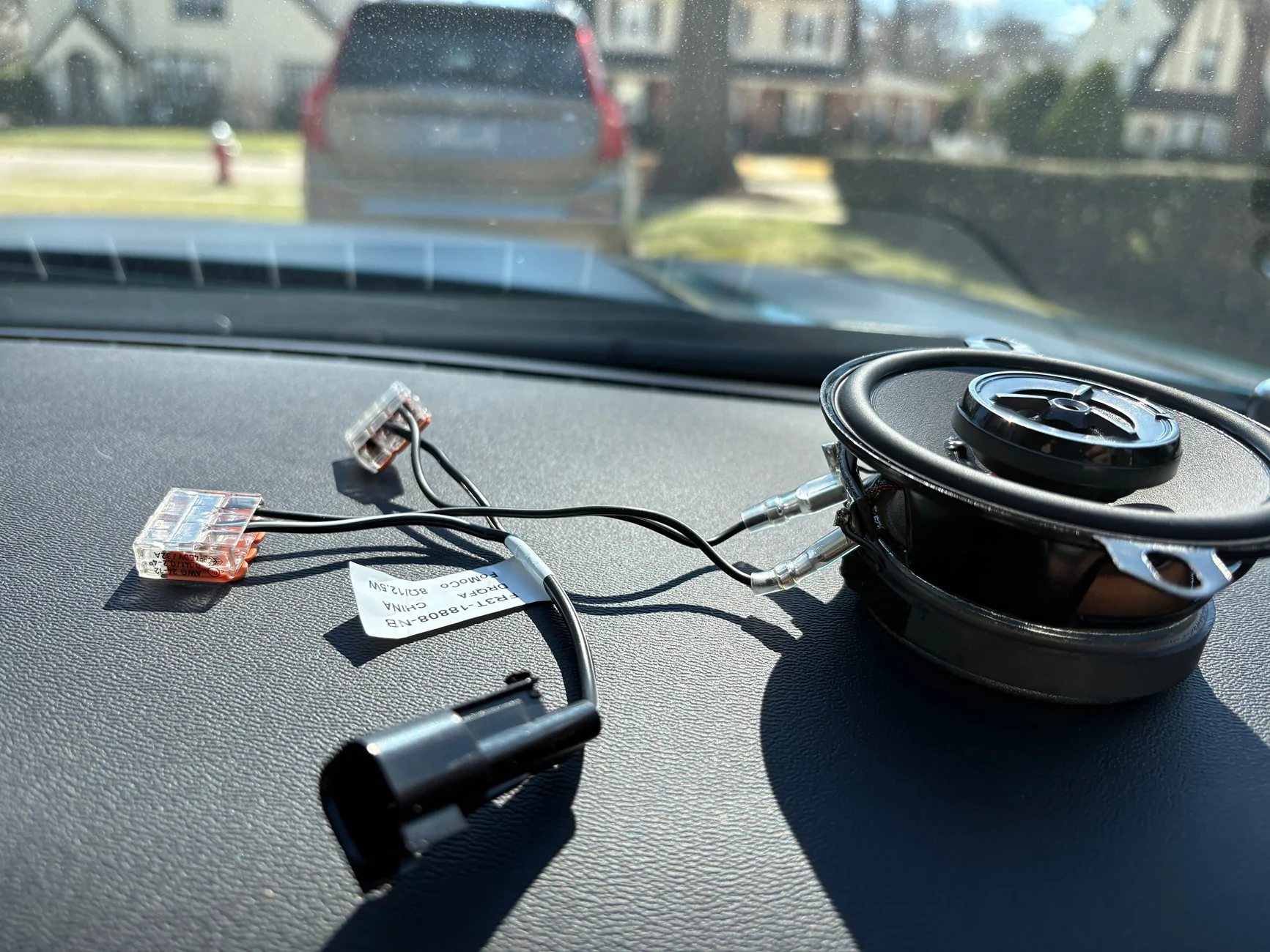

There's to ways to connect the new speaker to the original speaker plug (that I cut earlier):
- Solder
- Use a wire-connector
I decided to go with the latter option. Pretty easy and quick:

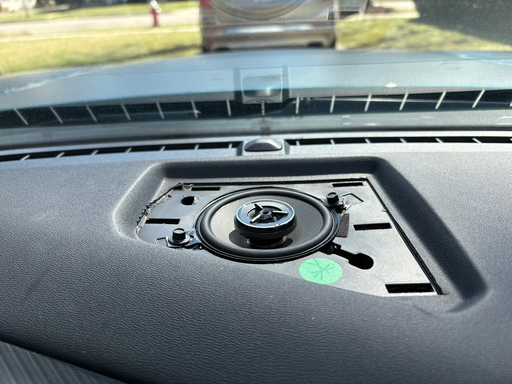

Here's the speaker mounted in the dashboard. Fits perfectly.
S650 Mustang My Adventures in Upgrading the Subwoofer and Center Speaker IMG_0136
Maybe I should have put some foam around it, but as long as it doesn't rattle, I'm good.
I have another one of the speakers available since I bought a pair. I'll sell it at cost ($50+shipping to you). I'll put this up for sale in the classified section at some point, but PM me if you're interested. Shipping shouldn't be more than $10 I think.
Highly recommended upgrade!
