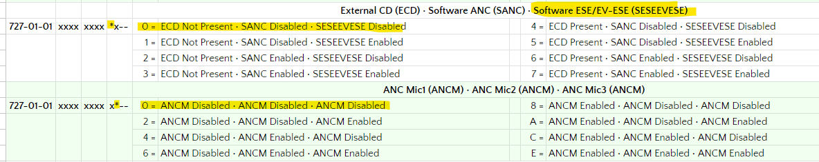

Update 6/29/24: I swapped out the cruddy Autotek amp for an Alpine and the sound is much improved. I did finally notice the buzz that some other folks have reported while cruising, so I loaded up Forscan and took a look. Using this super helpful post (thank you @roket ). I was 99% certain the buzzing sound was coming from Active Noise Cancelation (ANC) because lots of folks have said the GTs don't have the fake engine noise piped in. Well, as it happens, my ANC value was already set to 0 but the Software ESE was set to 1 -- I was getting fake engine noise, and it was making the subwoofer buzz and hum under acceleration. After setting that value also to 0, no more buzz.

I swapped out the cruddy Autotek amplifier and replaced it with an Alpine. Huge improvement on sound and power going to the subwoofer, but I also finally noticed the buzz some folks have been complaining about from the subwoofer when the audio signal is being tapped from the rear deck speakers. I was convinced it was Active Noise Cancellation (ANC), but when I loaded up Forscan and took a look at the codes, I discovered ANC was already completely disabled but the Software Engine Sound Enhancement (ESE) was active.
After I turned that off as well... poof, no more buzzing/humming from the subwoofer. Happy cruising. :like:
