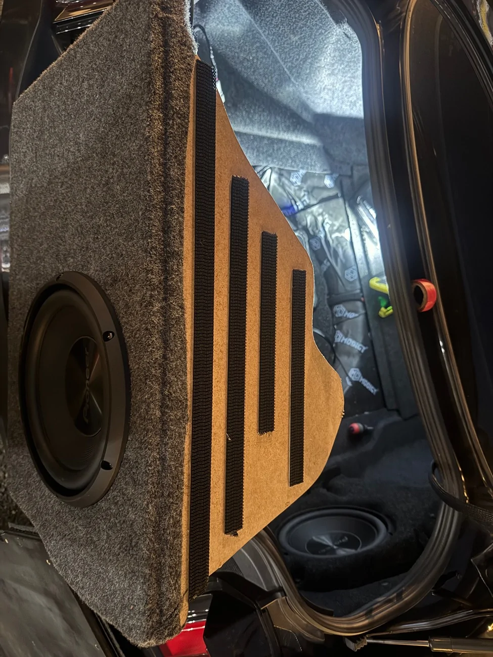

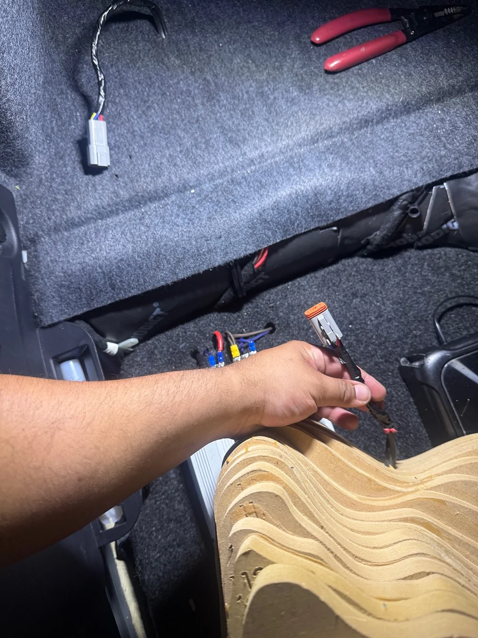

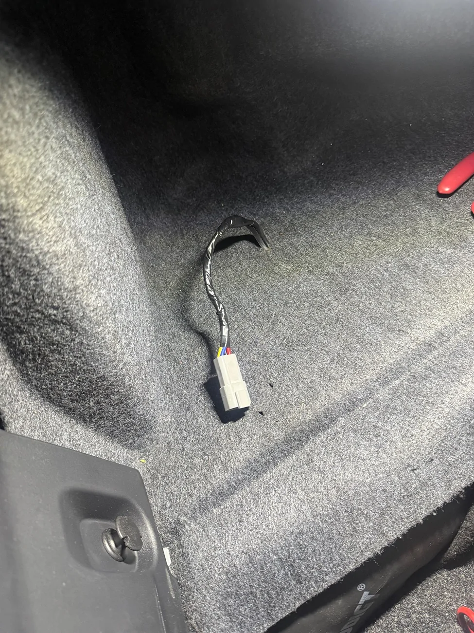

Finally got around to adding the subwoofer on the left side. It was a pretty easy install. Ran the wiring through the carpet & installed a pigtail to easily plug/unplug the subwoofer as needed. Mounted with velcro…. hopefully that holds it. if anybody can suggest any brackets that I can use feel free to comment

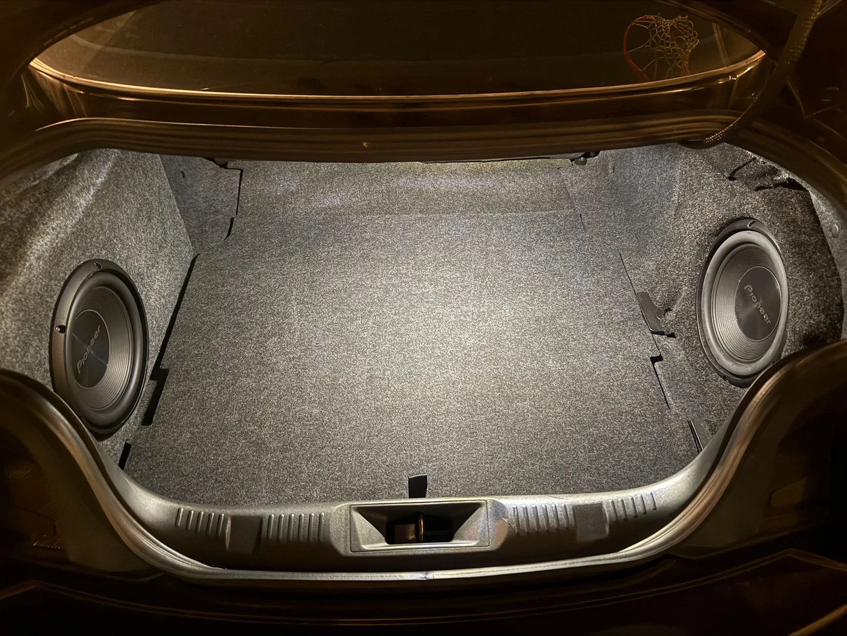

having the trunk be more symmetrical really makes it look better. although that corner is where my bourbon goes

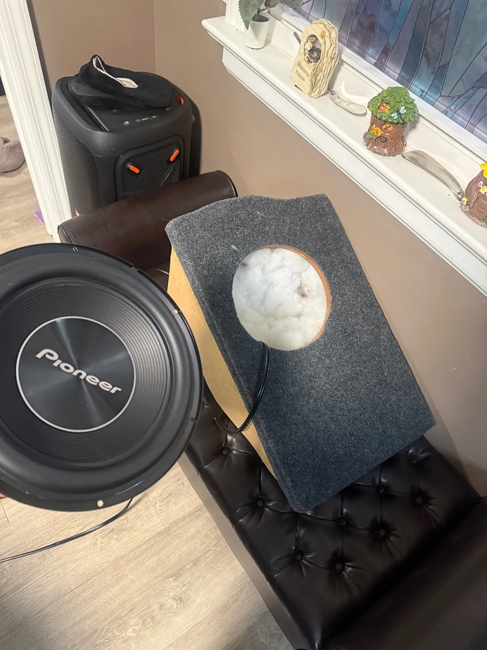

What Box volume do you have for those subs?I checked the link and it didn't mention it, only the subs you could get.

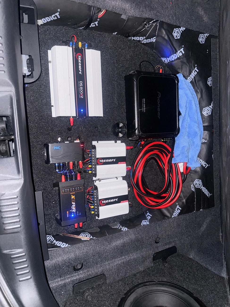

I also ended up having to get some fans to cool the amps, hopefully yours are getting too hot under there.
looks good though
appreciate you!! no idea man i had the measurements so long ago lol i did a rough estimate based on length/width/ height. The company should be able to custom make one to fit whichever sub you want. No fans at this time though spare tire boot doesnt get too hot
