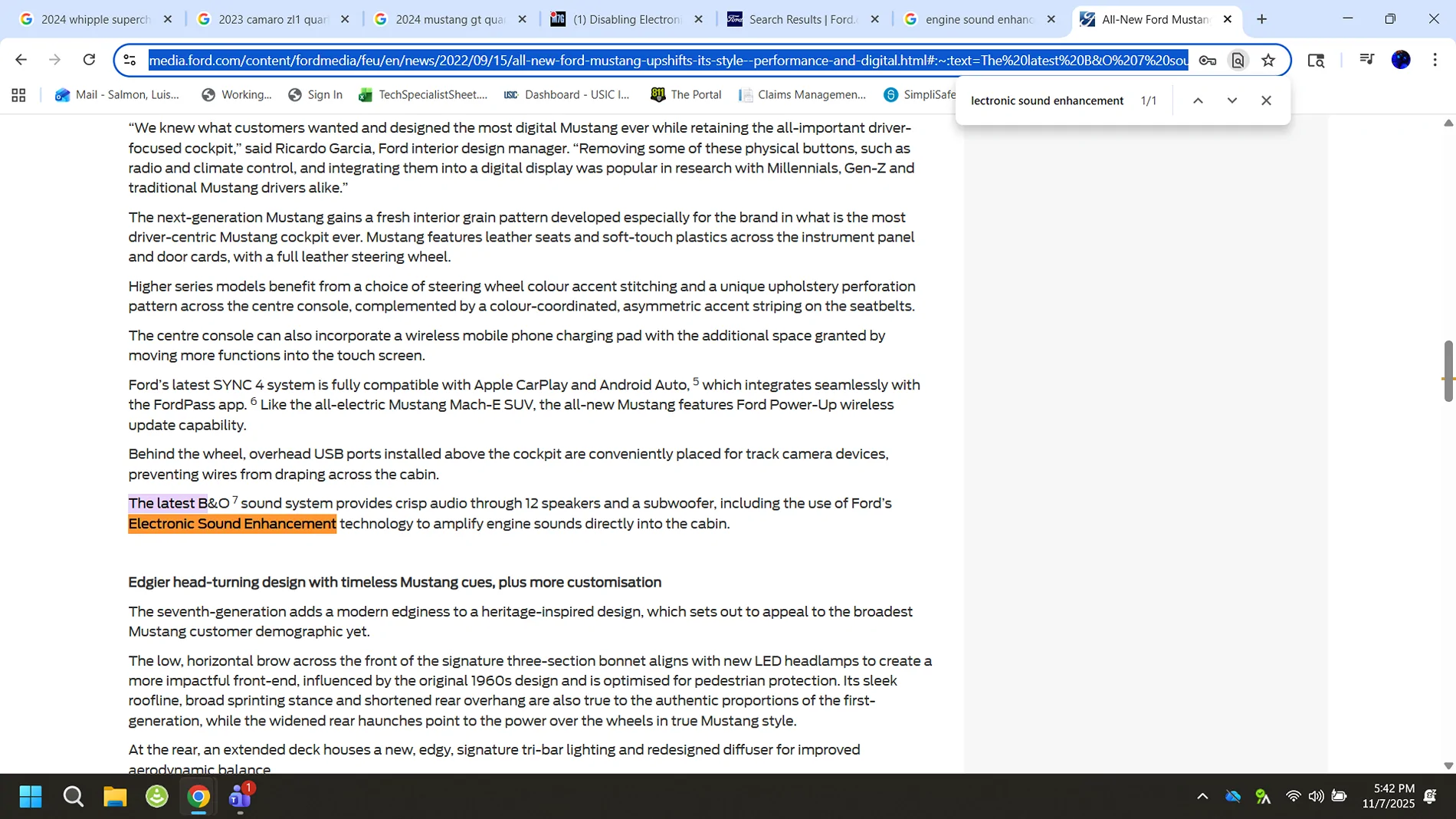

GrabThatBlue
Jan 13, 2025
2,477
2,744
Between Canada and Europe
Wouldn’t be the first time a media release was incorrect.
First you ask for a reaction, you got a reaction. Then you ask for the source, you got the source. Then yoi ask for proof with a link, you got the proof with the link.
And then you say that it could be a mistake by Ford. 🤣🤣🤣
Something lost in translation?

Don't use Google translation then.
Is it possible the media release didn’t translate correctly? The owners manual mentions exhaust sound enhancement and even talks about the electronic noise reduction function and you still wanna disable a head function in order to prove a point?
Even when something is in front of your face, you still feel the need to deny.

Even discovery requires confirmation
are you attempting to claim the german media release proves imitation engine / performance sound is played in the mustang coupe gt?
Are you trying to invent the wheel while its already invented?

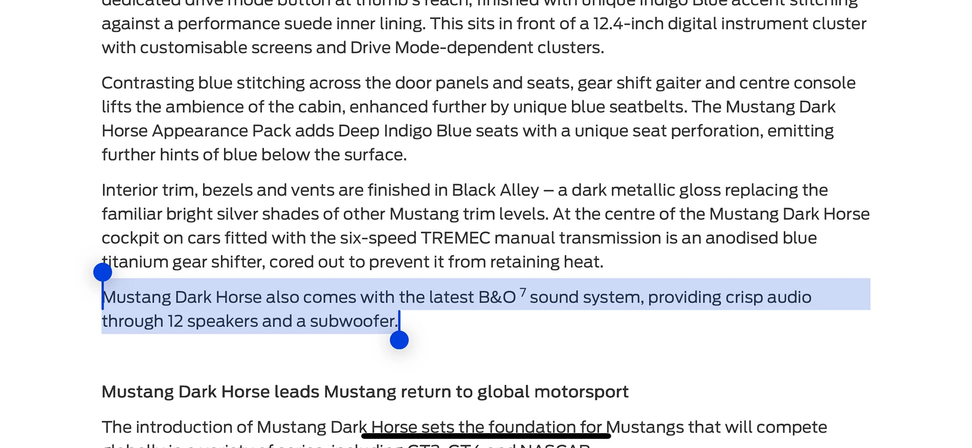

Does the dark horse get excluded?
You would think (hope)... but alas, no... ESE is clearly spelled out in the order guide for the Ecoboost and the GT, but not for the DH... though every DH asbuilt file I have looked at has ESE enabled!
Mine is the Dark Horse, and it pretty clearly is noticed at the extreme (Track Mode, 6-7000 rpm full throttle) that something electronically enhanced is going on. It is not so seamless as to be "real" - this sudden blast of noise
