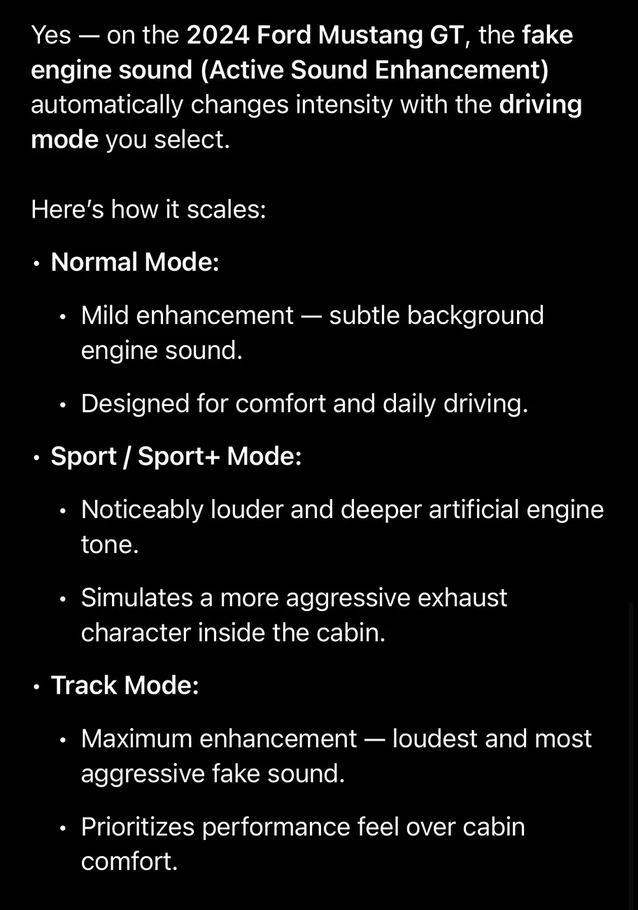

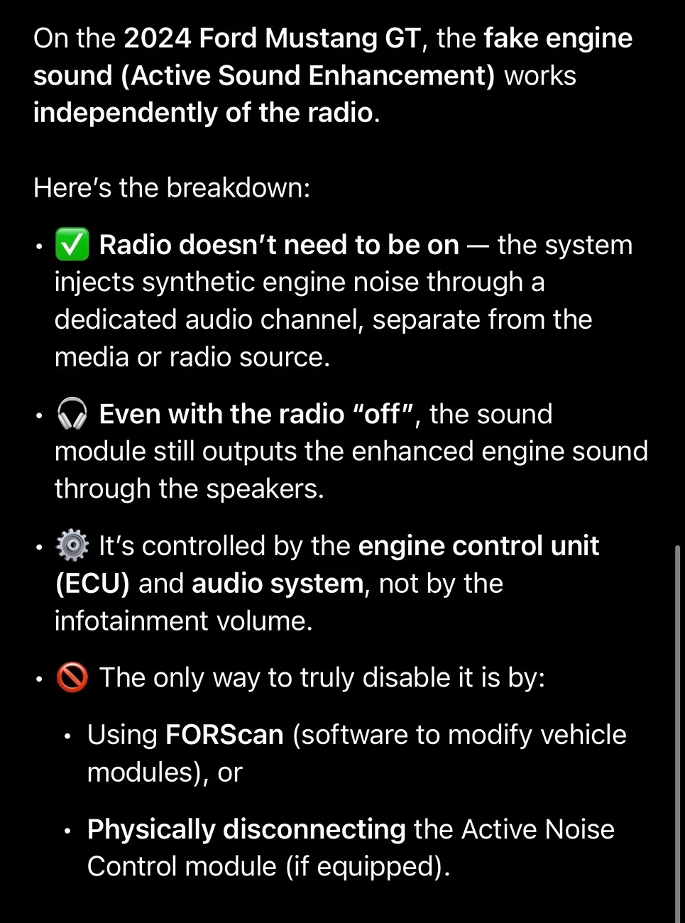

Do you have to have the "Audio" ON? Like pressing the Audio dial on the right? Or does the noise gets pumped either way if the stereo is ON or OFF? This is very interesting...
It is on all the time , I can tell there is a synthetic exhaust sound . a lot of other threads on here about it.

Ok , so I messaged Ford directly , and they said the same thing others have said , I will need Forscan to disable the ESE. They recommended I go through a Ford service department .
