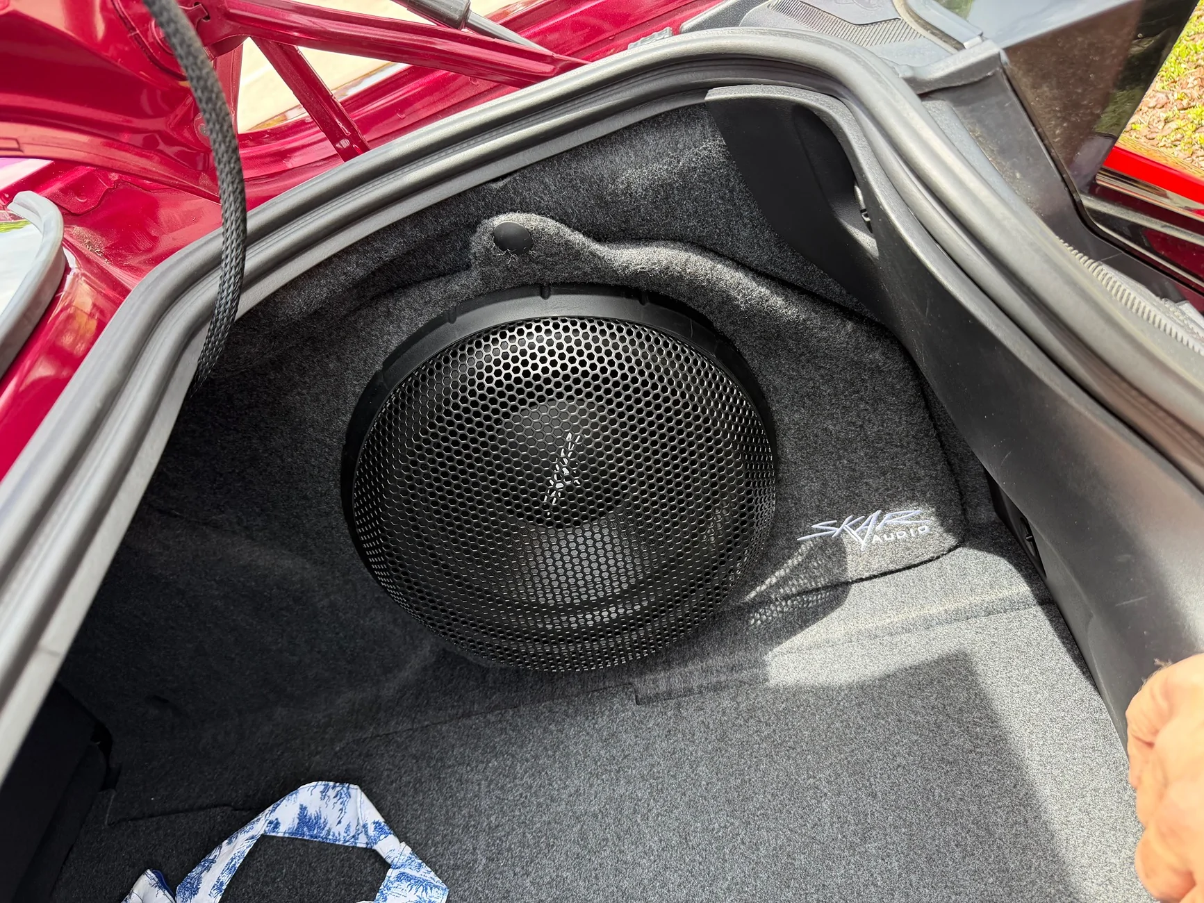

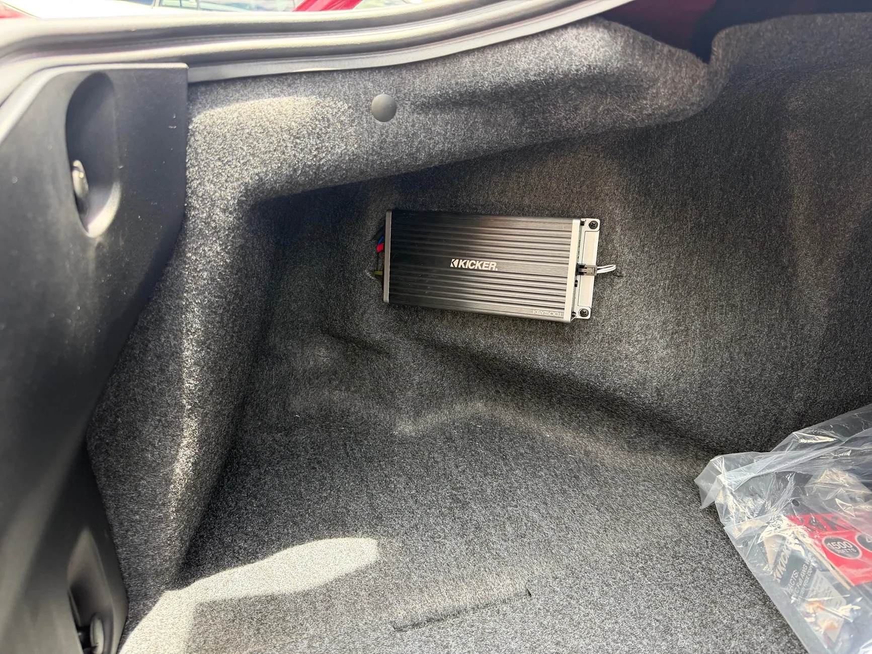

I did all my research and decided on a Skar loaded 12" subwoofer, a Kicker Key 500.1 Amp.
2025 GT Premium NO B&O, just the 9 speaker system.
I also killed the noise crap using forscan (see photo, make both X's 0 (Zero)).
No need for a LOC because the 500.1 does that too. I had it installed, they got signal off the 9 speaker amp, also in the trunk. I just ran kicker tuning, sounds amazing.
S650 Mustang Another Sub install for a 9 speaker system. IMG_1207
S650 Mustang Another Sub install for a 9 speaker system. IMG_1208

That looks great! This is exactly what I would like to do. Any chance you have details for the wiring coming from the stock amp to the Kicker amp? I musta have missed those details somewhere as I haven’t seen that mentioned in other threads/research I’ve done…I probably just missed it.
Your setup looks clean!
