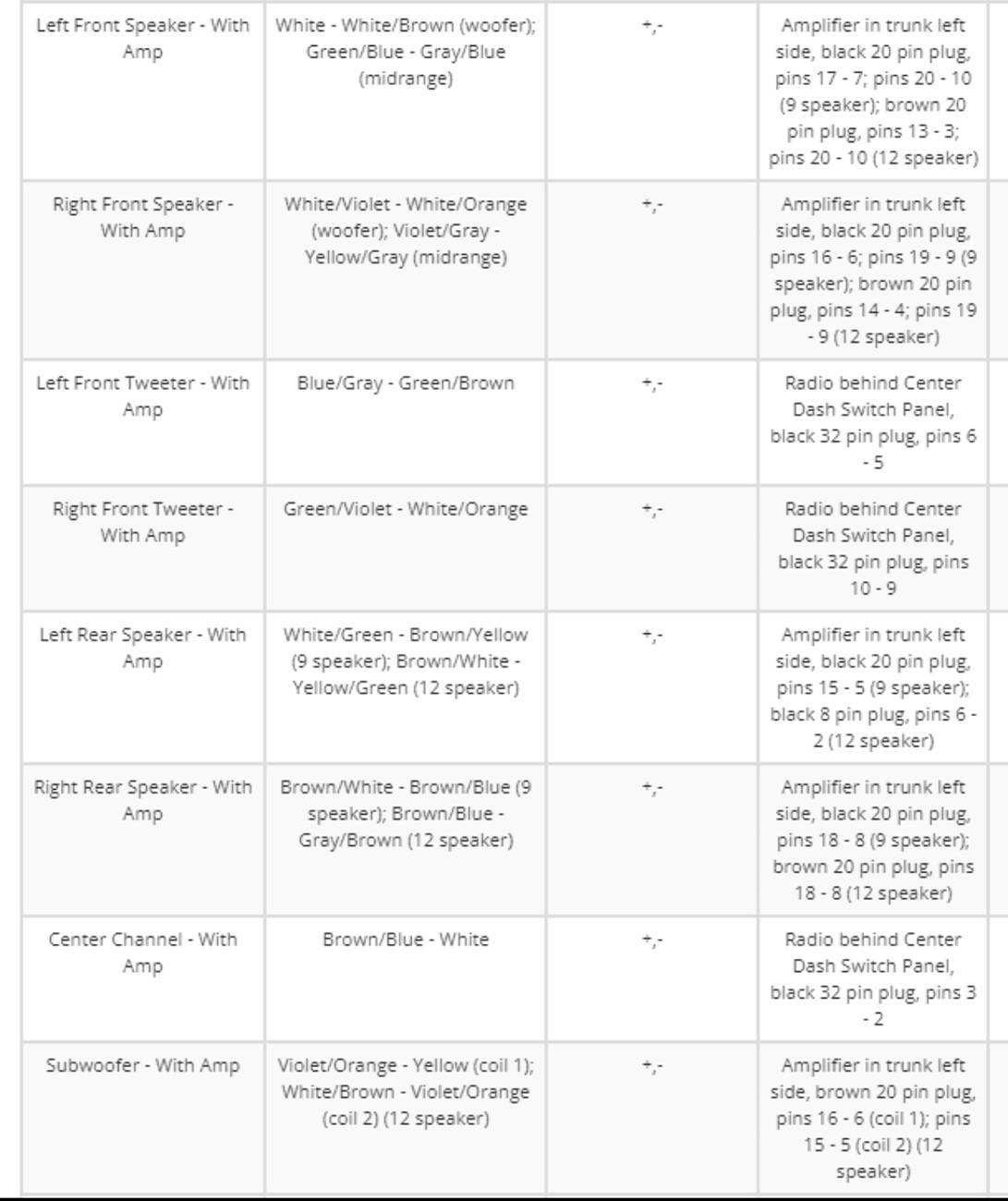

ordered 24 Gt premium
Idk what to belive on the ANC I had the 12speaker B&O and I redid the whole system but before the highs I had only added subs and neither set up had any weird sounds
but anyways here’s the colors and schematic I was given from pac audio I can confirm for the 12 speakers this is right

does anyone have the color chart for the rear speakers leads for a 25 mustang without the b&o system, just the 9 speaker set up, and can i tap into the rear leads for signal input to add a powered sub to the trunk area? just want a little something back there and an easy way to do it without tearing everything all apart.
Here you go.
